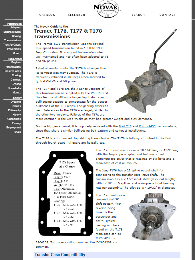

    The T176 has a tail shaft and housing to bolt up to a transfer case . None that I know of were ever made for 2 wheel drive for Jeep. Screenshot (809).png

    Wouldn’t that make it easier to mount up to a torque tube?

    That could be. I've never had reason to explore it. One would have to set a torque tube trans up with the T176 beside it on the bench and start measuring and designing.
    The actual issue may be that Jeep guys who play with CJ jeeps tend to put seriously high prices on parts in good usable condition. It's not worth much after they tear it up = shifter off broken trans but the complete trains in great shape commands a stiff price as does that flathead 4 that they pulled out and stuck in the corner to stick a lot more power in the Jeep. When I started gathering parts for my boat tail I was looking for a Jeep flathead four cylinder and they wanted more for one around here than 8 BA flatheads were going for. Plus the guys around here are hard on Jeeps, the first Jeep club in the US was started 20 miles from me.
