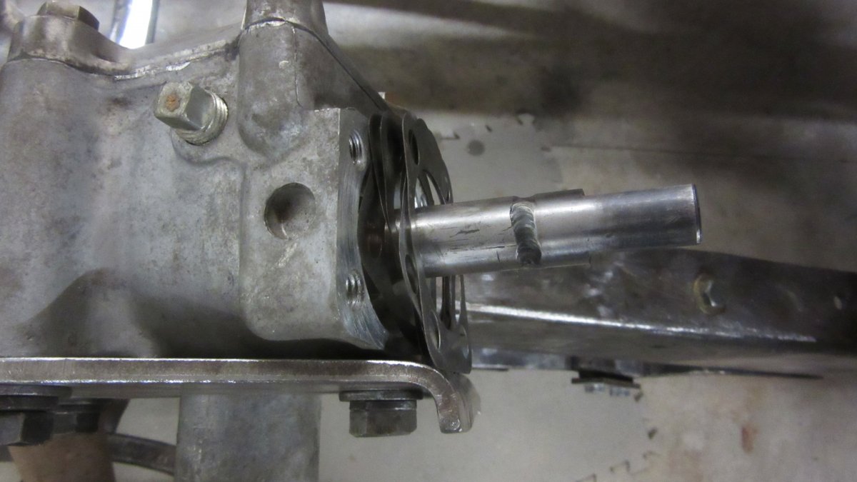

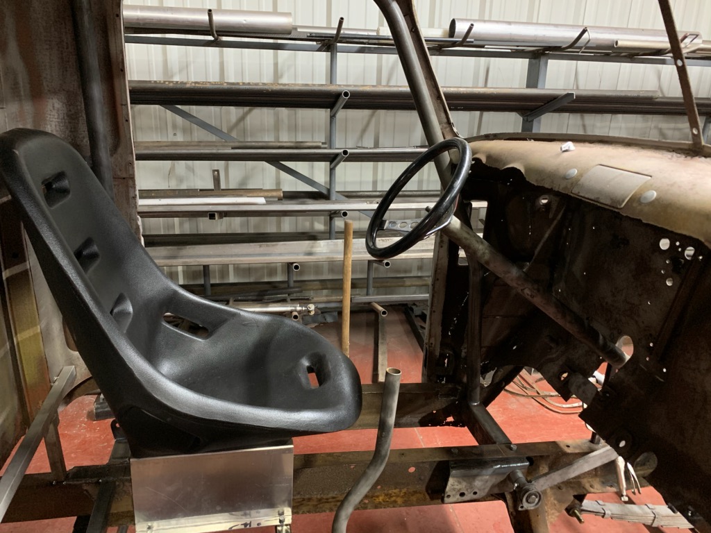

    So i reversed a Corvair steering box now the only one i could find was the long shaft one. Everything is done except the shaft need's to be welded and lathed back to 5/8. Has anyone done something like this before? I'd prefer just running a factory short shaft but none locally around and the one i found online is not in budget for me at this time. 89548554_191694465453996_3390031271714357248_n.jpg

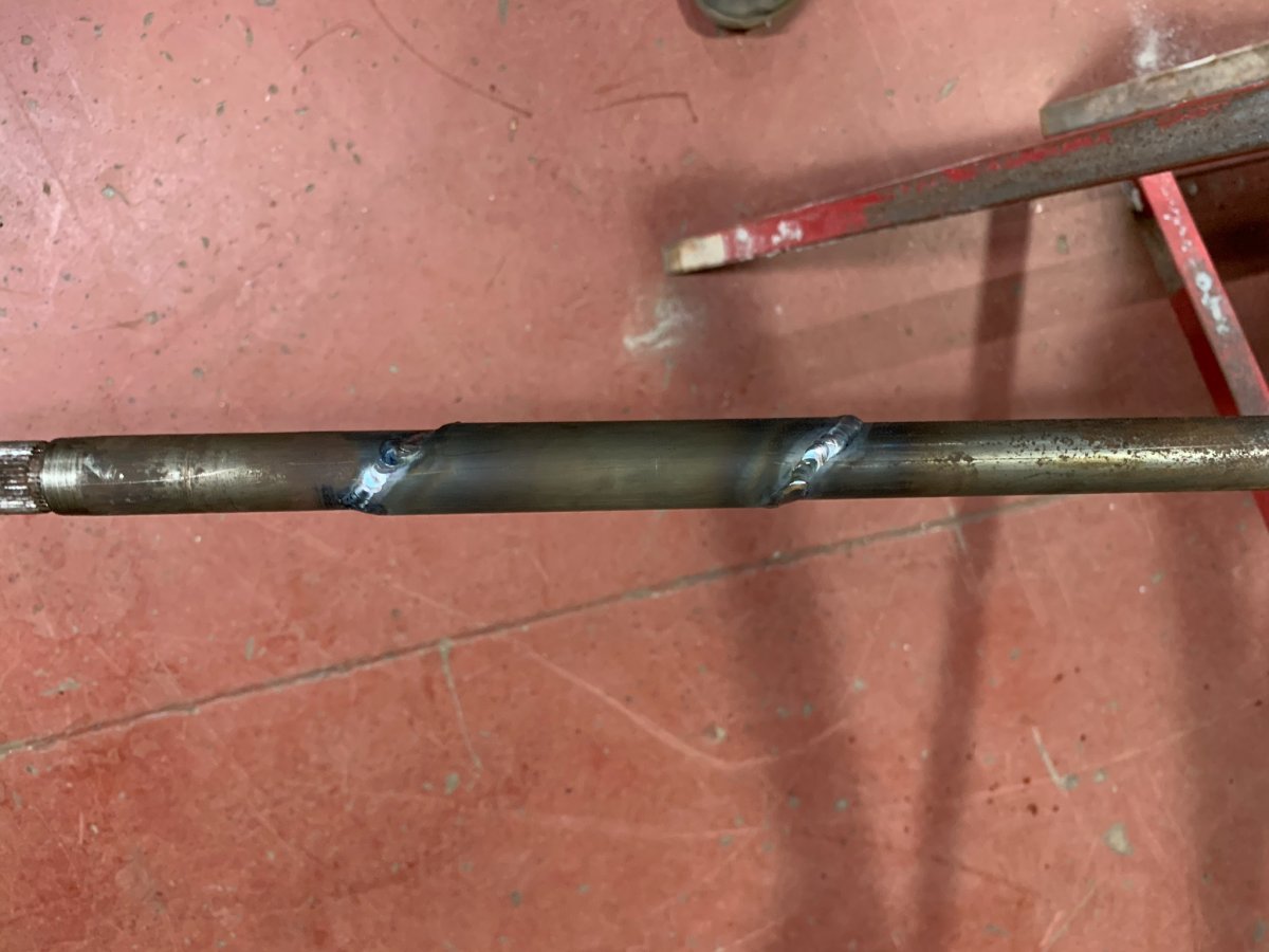

    I had this one done by a local race team. This has been getting done for decades. My steering gear was hollow so he turned down a piece of solid double DD and plug welded it and welded around the joint also.
    egads, Penetrator and Hnstray like this.

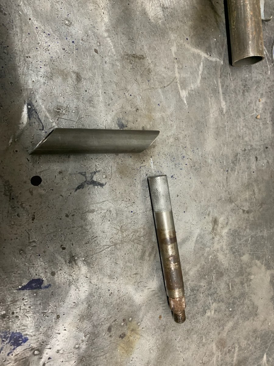

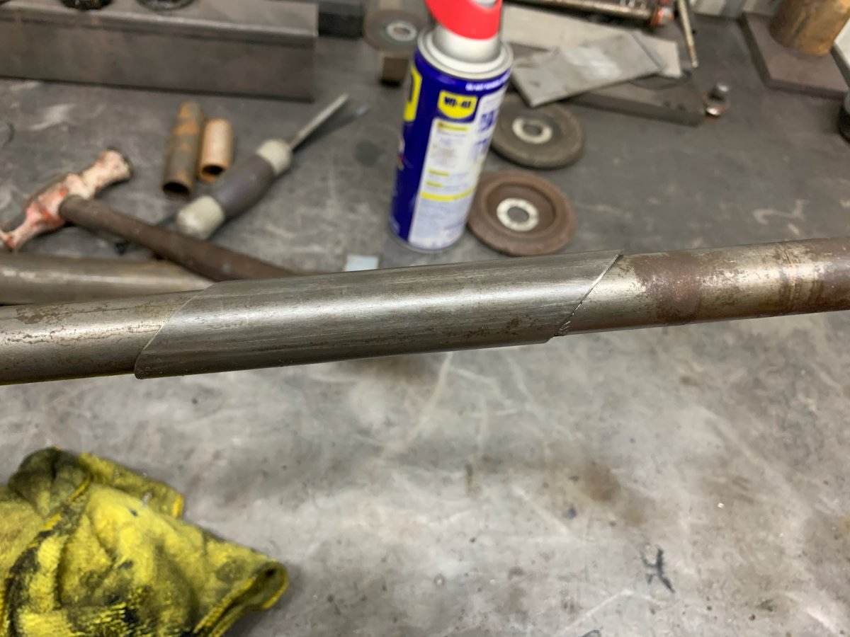

    Here is another way that looks like it would work with what you have.
    Penetrator likes this.

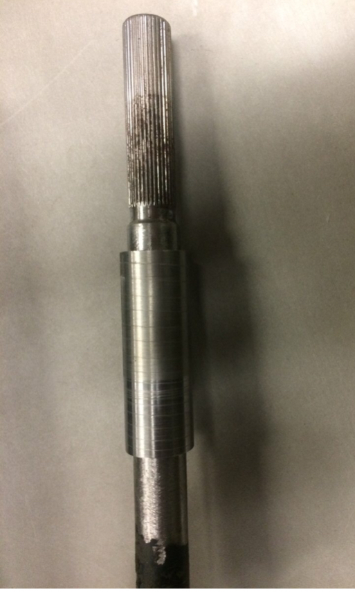

  26. We machine a press fit sleeve
    Aligns the shaft
    This one hasn’t been welded yet
    Don’t know if this helps in your situation
