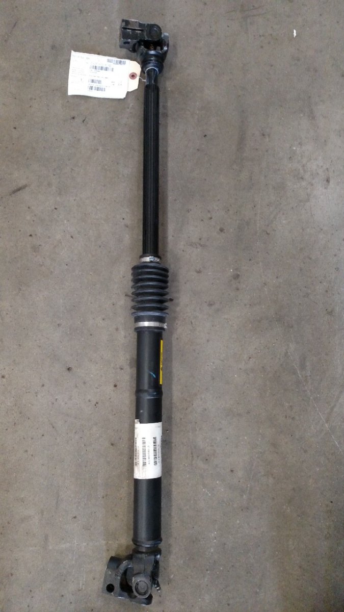

    Take a look at a cl*** 5 - 8 commercial vehicle intermediate shaft. (Random internet google image attached)See those u-joints, those are welded on... and seam between the bellow and the white label...that’s a weld seam. So, for ANYONE, that says “NEVER weld a steering component” you should amend your statement. Maybe add “never weld a steering component without the proper engineering and equipment” or “don’t weld the steering shaft in your photo” But blanket statements about never welding steering components are incorrect even though they come from a place of concern for safety (which is a good thing) but they are still wrong.
    Ned Ludd, Boneyard51, jvo and 2 others like this.
