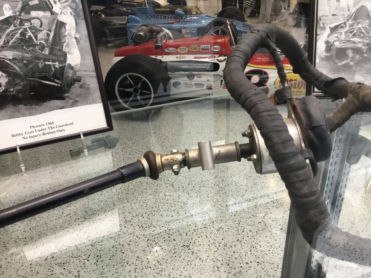

    I heard that all over forums! Don’t weld on steering components! Then I go to Indy, and guess what I saw at the museum!
    If it’s good enough for an Indy car..... it ought to work on a hot rod!
    Bones E88FCB3C-3CF8-4A0F-BE68-F0F783FE4E80.jpeg EB369A3A-3FA3-48AF-A875-55278451D2D1.jpeg

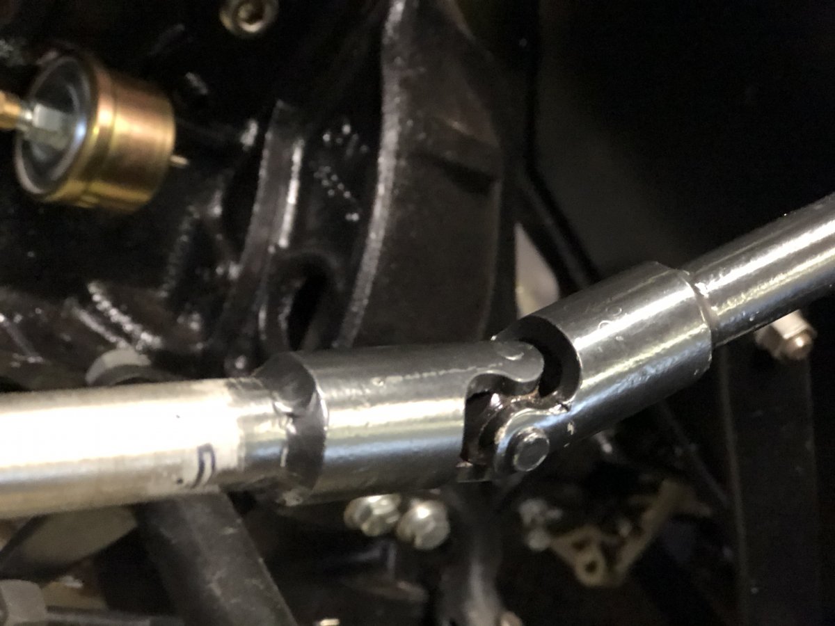

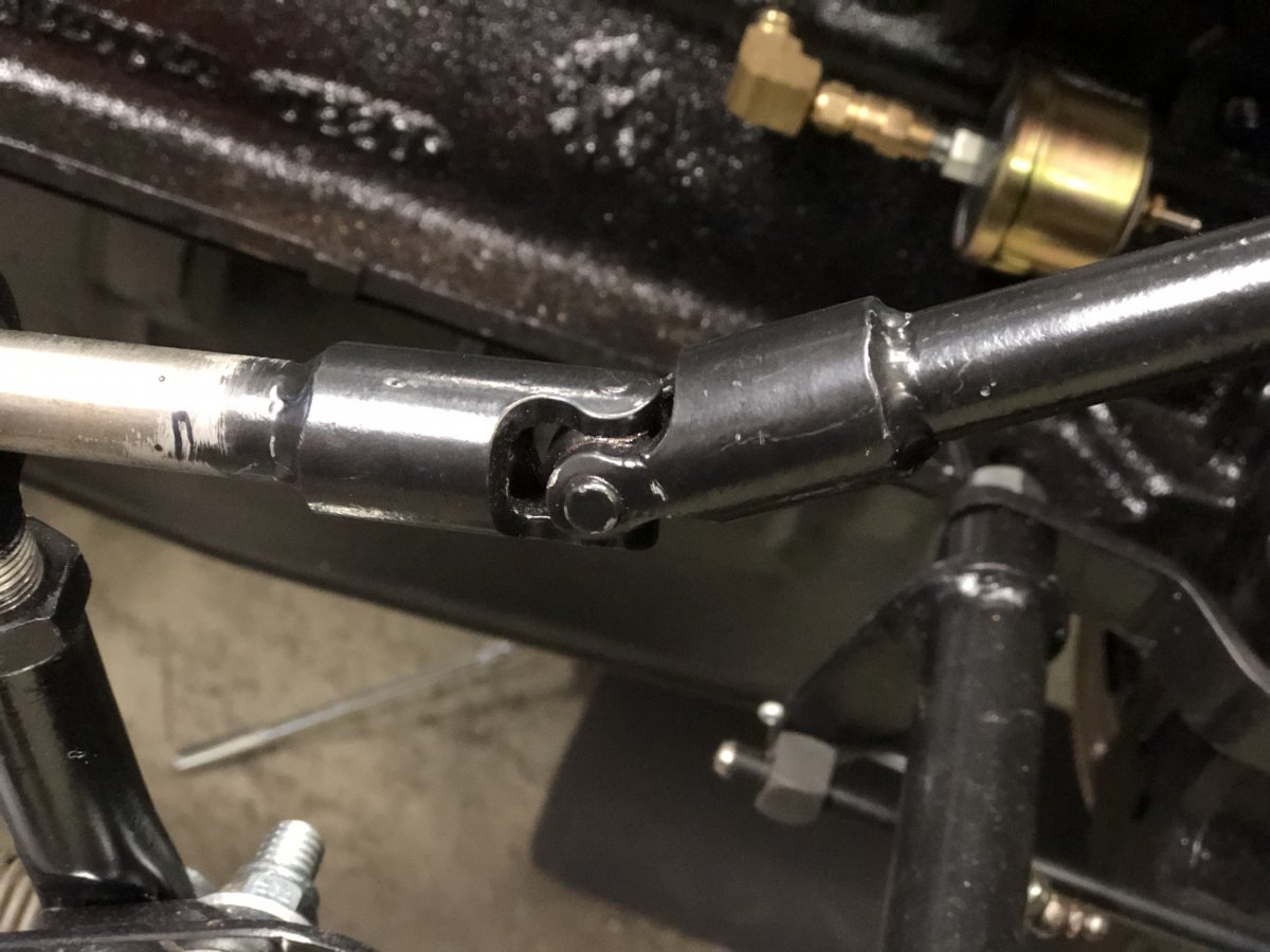

    This was done in 1962-3 by Blair’s for Noel Melovich’s 1940 Chevrolet as a g***er. Been use on the Salt and El Mirage since 1975. I don’t see a problem. EE46AA58-DED8-421A-BB8F-202FB7D67154.jpeg 0ED8D29D-5C75-447F-BB44-CED830C14861.jpeg
    olscrounger, egads and willys36 like this.

    What brand is that U joint, it has a good track record. ;)

    Looks a little under cut to me..........Really needs another p*** around to bring it up flush with the shoulder of the socket........But still plenty strong for the last 60+ years and 60 more prolly!!
    Good indication of just how strong a welded shaft can be.

    This is not a pitman shaft How much torque can you generate with a steering wheel? A worm style gear box does not transmit much back force that why the use them.
  29. jimmy six
    Joined: Mar 21, 2006
    Posts: 18,050
    jimmy six
    unknown..feeds a Corvair box and the car weighs 2900.
