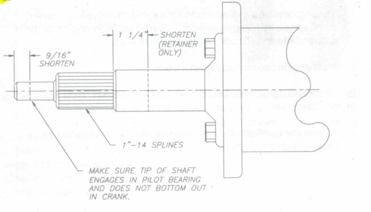

  17. seabeecmc
    Joined: Jan 28, 2005
    Posts: 1,254
    seabeecmc
    Here is some additional T-5 information.
    This is assuming you're using an S-10 transmission.
    The input shaft of the transmission has a special spline size of 1"-14.
    You will need to shorten the input shaft 9/16" as per the illustration below, as well as shorten the bearing retainer 1-1/4". This prevents the retainer from bottoming out into the pressure plate.
    The bellhousing has a bolt pattern identical to the T-5. The indexing diameter of the bellhousing will require a bushing that will reduce the index size from 5.125 to 4.686.
    Without this bushing the alignment between the transmission and bellhousing will cause transmission failure.
    Of course, as always, there are other crude but effective approaches.
    Good luck![​IMG]

    So I suppose this info applies to someone with a NWC T-5 behind a SBC?
    'Cause a World Class box is a straight bolt in, nothing crude about it.
    At least until they started using Ford ones.

    Mike, what year Mustang T5 are you using? If 94-95, you can swap in the input shaft from a 89-93 (check the gear set first, but most should swap in) & reduce the input shaft length by about 3/4" - the 94-95 models used a longer input shaft due to engine/tranny placement & packaging in the SN-95 body-style for the 2yrs the 5.0 was used.
    Otherwise, I'm not sure why the pruning of the input shaft would be required. Are you referring to only the very tip that rides in the pilot bushing? If so, most of the S10 shafts are shorter than required, so the Ford may be the correct length - cutting to match the S10 T5 might not be the best approach.
    If it's total length instead of just pilot tip, just have your bolt-pattern spacer thickness machined to correct any depth/placement issues.
    I guess because I don't have both of those trannys here to measure/compare, I'm not sure what you're measuring and am probably giving advice to a problem that does not exist! :D
