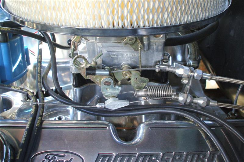

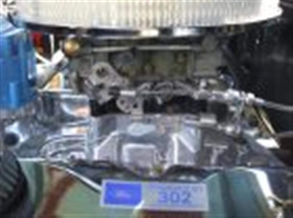

    Before you get confused any further I also have a 1984 302 & AOD,the Lokar kit is super EZ to work with, SO BUY IT! there are three websites I will send you to,save them in your"favorites" to refer to as needed.#1 www.becontrols.com/tech/aodfaq.htm #2 www.clickclickracing.com tons of info on forums #3 www.tciauto.com/products/instructions/instructions/431000_inst.htm AOD transmissions had several weakness prior to 1988 a good quality shift kit should fix most of those,also changing to a 88-91 Valve body is a good plan and big improvement,the '84 AOD had a "C' servo:(, change that to a "B" or "A" servo,if you are running 3:55 rear gears or more you need to change to a high rev governor Silverfox on clickclick can hook you up.The pictures show the Lokar cable and TV cable(not a kickdown!) on a Holley and The Carter AFB (I have it's twin for sale if interested) which is on the car now.
