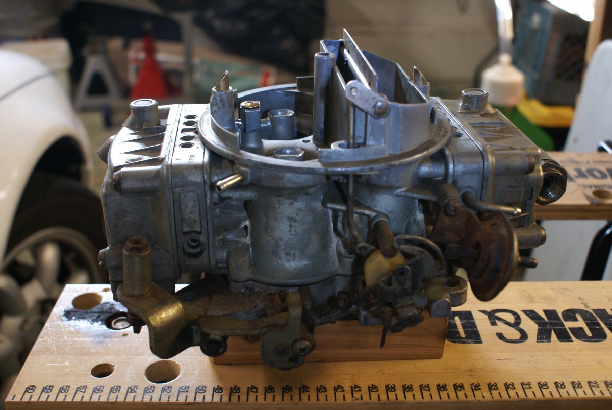

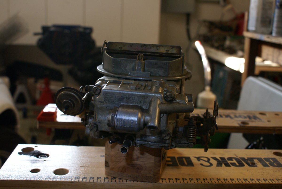

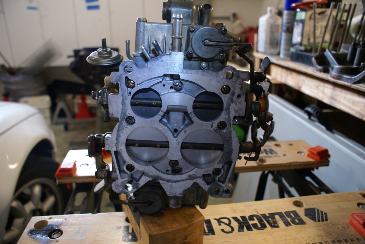

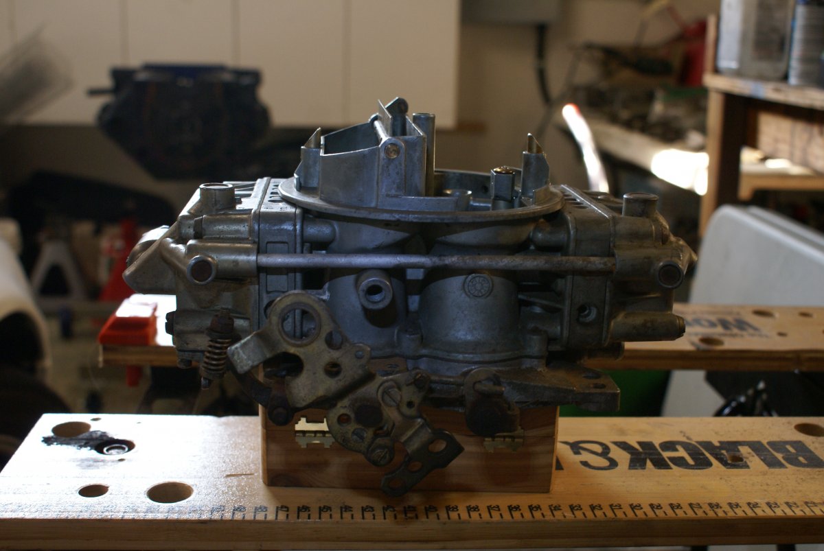

    Hello Hamb community, I am 17 and new to carburetors, and recently purchased what was advertised as a "650 CFM Holley Double Pumper-Four Barrel", now that I have the carb, I realize its not exactly a common one. The number stamped vertical on the side is "6r-4237B" the secondaries are huge, and the primaries are small by my (inexperienced) account. Best I can figure from my research is its made to replace the factory Q-Jet, but i cant find parts/Rebuild kit for it, or a whole lot more information than that anywhere.
    Any information on tuning, where parts can be found, and general history of this damned thing will be greatly appreciated, thank you for your time.
    DSC00499.JPG DSC00501.JPG DSC00495.JPG Again, thank you
    P.S., What is that thing? ^ (dumb question I know)

    Gavin... To identify these (Holley) carbs, read the number on the front of the air horn. (photo #3)
    There is a small 'legend', starts with "LIST"...then some numbers.
    I believe the 'lot' of that carburetor is a 'Spreadbore', called for the large secondaries...
    But give us the 'list' numbers, please...

    LIST-6210-3
    0715
    as printed on face

    They do sell carb kits for it. Just search for a kit for a 6210 Holley. As Jim or Mike said above all Holley carbs are referred to by the list number. They actually still offer those for sale. https://www.holley.com/products/fue...arburetors/emissions_replacement/parts/0-6210
    This should be the kit. https://www.holley.com/products/fue...omponents/rebuild_kits/renew_kit/parts/37-605
    OReilly's can get the kit and while a couple of bucks more than the others no freight. https://www.oreillyauto.com/detail/...51/carburetor-kit/37605/4377514/1998/bmw/528i If you have order it though them tell them to bring it in on a stock order rather than special order.
    I should note that while the actual list number is 6210-3 it is a 4165 series carburetor. There is a ton of info out there.

    You have the mechanical secondary version of the Holley spreadbore.
    The vacuum secondary version is more "common", but still not popular. The only one I've seen, I own.
    Never saw a mech sec version.
    I just bought a rebuild kit from Summit for the vacuum secondary version.
    I like my vacuum sec version, it fits perfectly in place of a Quadra-jet.
    Seems like the accelerator pumps would too big and too small at the same time.
