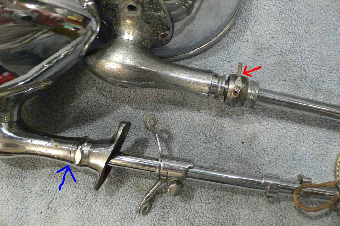

    You have one spot with a very tight pin on the lock nut (outside the car), and one thats standard. This is not the area that puts tension on the spot. let me take a picture of a spot with the tensioning part installed so you see where it goes.
    These are Appletons right? I have never seen an appleton with a lock ring. Appletons use a pin to retain attach the hex/threaded part to the outer post that the bucket mounts on.

    The blue arrow is the part that puts the tension on the spotight from the whole out side post turning. This part goes inside the car, and one or 2 of the little posts with holes at the end screws to the garnish molding, and then you tighten the nut on the tensioner to provide tension.

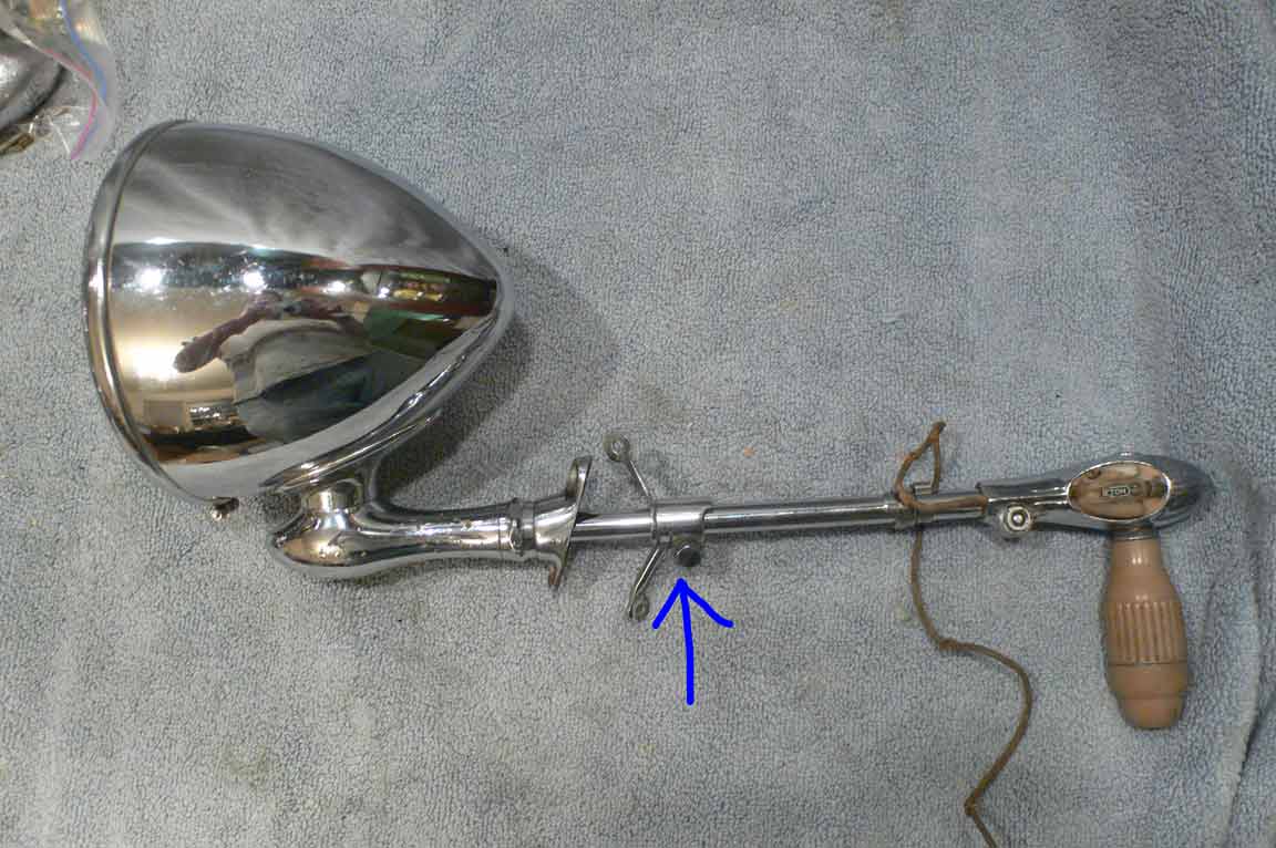

    Ok, well, just so we can see if were on the same page, here is one more pic. Is the blue arrow pointing to where the spot is swiveling around and not stayng in position?
    The red arrow points to the partially hammered out pin that locks the hext part to the post part on every appleton I have seen.

    Yes, the hex nut and the base that mounts to the cowl stay put and the spot droops all over the place. The only difference I can see is that the hex nut is retained onto the spot shaft (to the left of your blue arrow) with the snap ring. It looks like in your pic the hex nut is retained to the base. And no, there were no such pins running through the hex nut.
