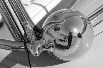

  7. Wow ^^^ That is a great sight .

    It is!A friend is the owner of this light,he bought it last year at the Long Beach swapmeet for $175.......
