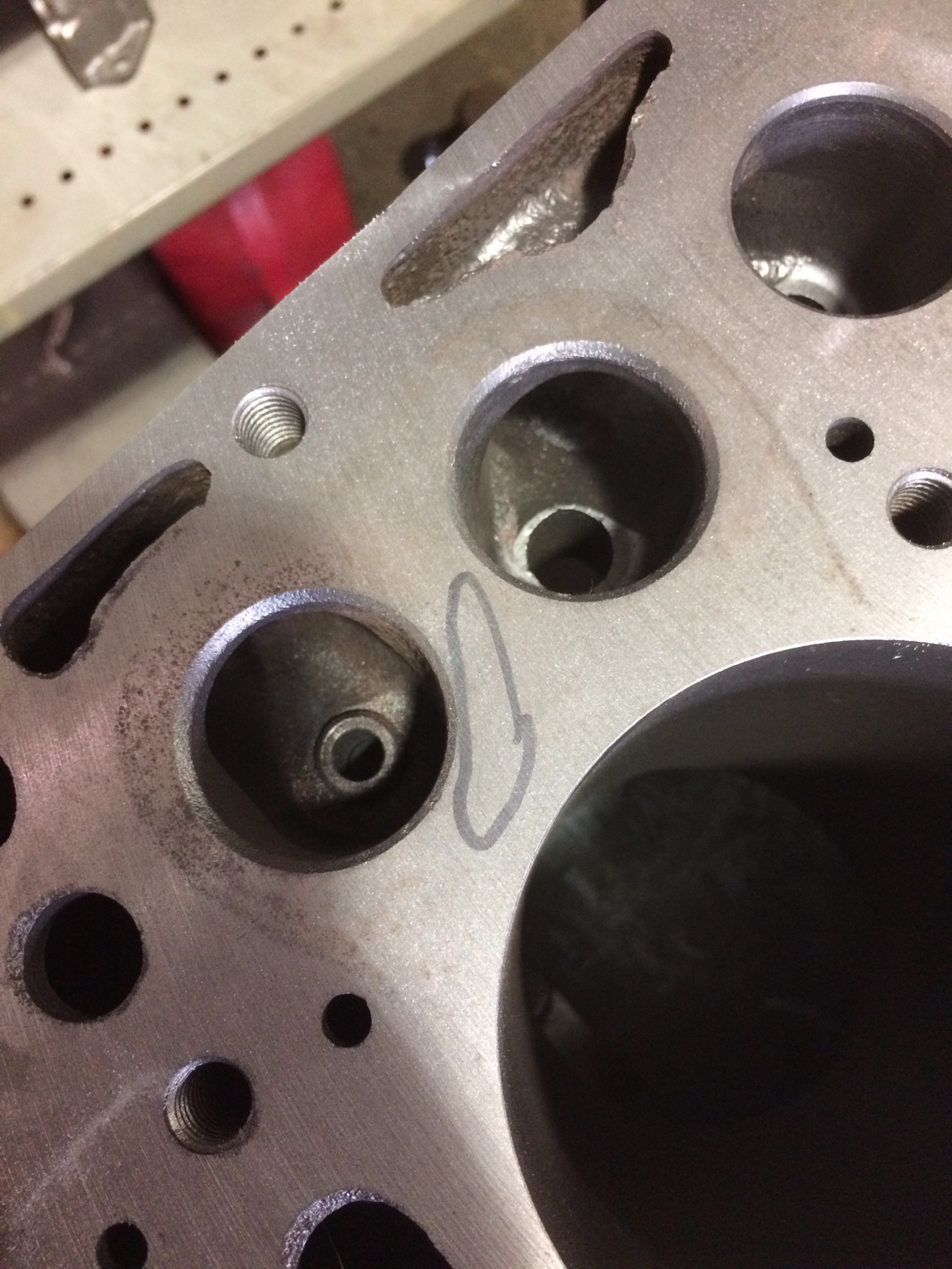

    While decking my B block the machinist found cracks in the deck at exhaust 3 & 4 that follow the seat. Cylinders are fine. They did not show up with a common magnaflux but were visible during decking. It looks like if we put seats in the seat will be in and out of the cracks one one and will leave the crack in the deck on another.
    So now what do you guys think? Is this block now only good for a Miller/Crager or only good for a door stop?
    Is this a candidate for successful s***ching?
    [​IMG][​IMG][​IMG]
  6. It does look like the cracks are following the existing seats somewhat.
    It really depends on your intended usage of this, or any motor.
    If you wanted to, you could probably find someone to s***ch this up and then put in new seats.
    That being said, do some searches on valve seats and the complications/issues. There have been many threads and horror stories, most do not end well, either financially or without replacing the block.
    Now, since you mentioned going overhead, does this mean that you would consider going this route?
    If you stopped right here and went overhead, you could probably do so quite easily.
    The Miller High-Speed head ***embly is top quality and probably the best for a street driven touring car.
    There are others, some better than others, but you have to be truthful with your application.
    The truth about magnaflux crack checking is that the Block will never be checked in the areas prone to cracking unless the operator is intimately familiar with the Mod "A" motor.
    Just because a block has been magnafluxed doesn't mean that it is crack free. It has to p*** the inspection too.
    J

    The Last B engine I built took 4 blocks to find a good one.
  8. V4F
    Joined: Aug 8, 2008
    Posts: 4,391
    V4F
    from middle ca.
    I would check into fixing as john said .
    Old Dawg likes this.

    Thanks for the great advice, just what I was asking for. This was going to get a Riley 2 Pot but that will go on an A and move on down the line. I will park B until fall. Steve is a great guy and I agree his product is top quality.
    Now for your comment about being truthful with application. This remark was cause for pause, in a very good way.

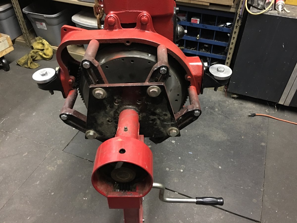

    Brain fart dept: got ready to put the engine back in the Zipper yesterday and remembered that I could not install the flywheel without removing the pan that's modified to use a '39 transmission. So, off came the pan, on went the flywheel and put the engine back on the stand to reinstall the pan. There must be a better way to modify the A pan with the B lower rear half.
  13. Honestly, I don't know why anyone would use the "B" pan and upper housing when this is available.
    https://www.clingsaftermarket.com/addtocart.asp?prod=43
    This is used with the "A" bellhousing.
    I still know a few who swear by the "B" trans, of course with Zephyr gears.....
  14. denis4x4
    Joined: Apr 23, 2005
    Posts: 4,402
    denis4x4
    from Colorado
    Unfortunately, this engine was modified before Cling existed and the tube frame was designed around this set up. Also running Zephyr gears. IMG_0343.JPG
    Dannerr likes this.
  15. I understand, the "B" mounting height is different than the "A", the mounting would necessitate changing the mounts.
    For what it is worth, I will not use another "B" upper housing unless forced to in the future. (in or out of car)
    I had one on a stand similar to what you are showing. When it broke, it cost a very expensive Dry Sump pump and rocker cover to be repaired. I leave the welds showing on the rocker cover as a reminder.
    Are you running the "B" trans, or the '39?
    J
  16. denis4x4
    Posts: 4,402
    denis4x4
    from Colorado
    '39 trans with Zephyr gears.
  17. Denis,
    does the '39 trans leave a large opening on the "B" adaptor over the starter area?
    I have never tried to put the '39 on the "B" housing, ***umed it would not match up.
    J
