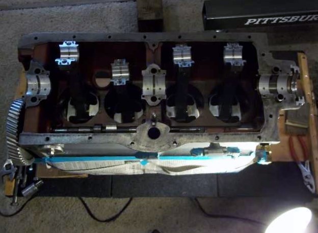

    my motor . yes I took up a lot of band width . a young man asked me to post .
