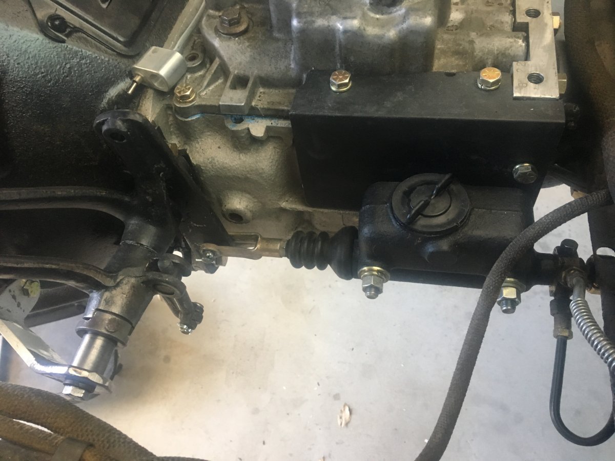

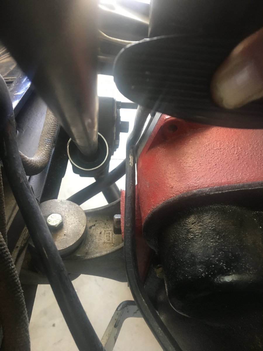

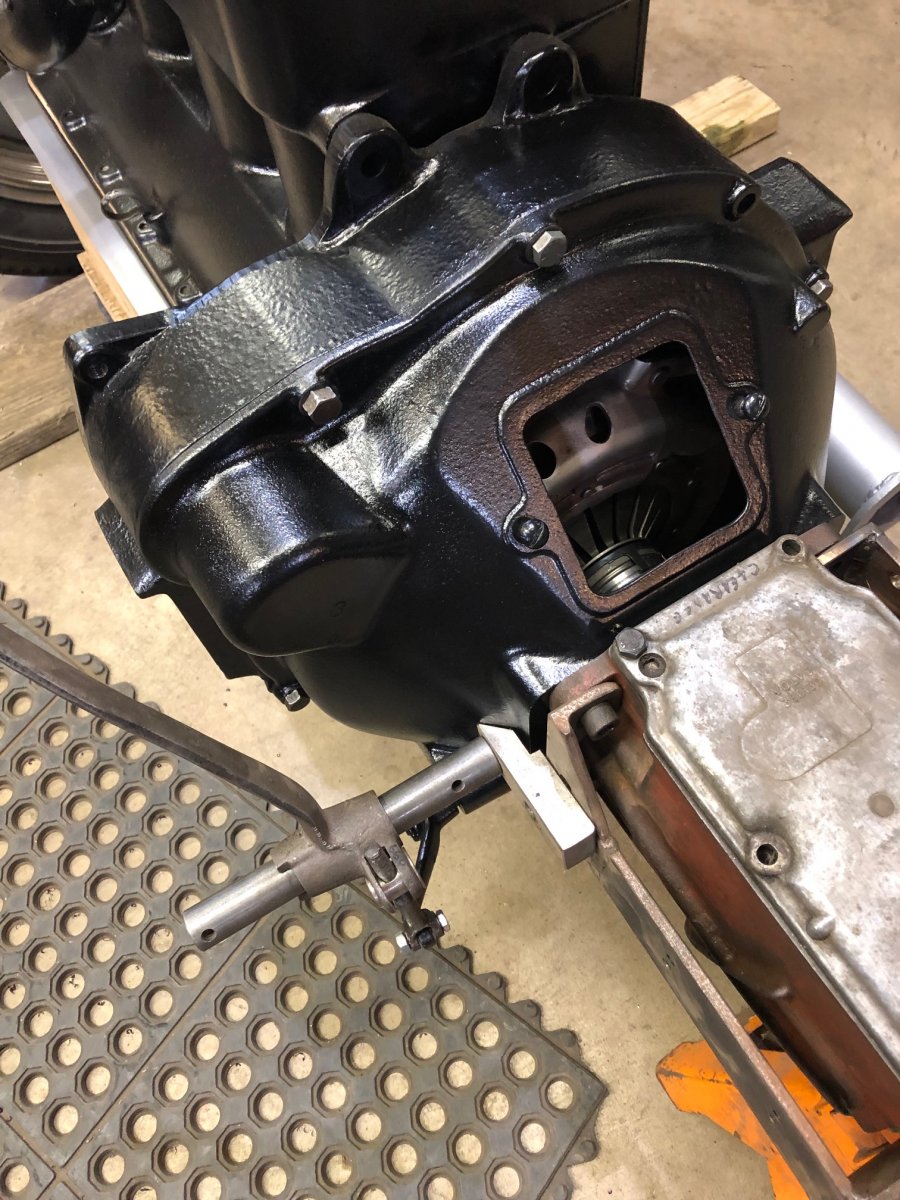

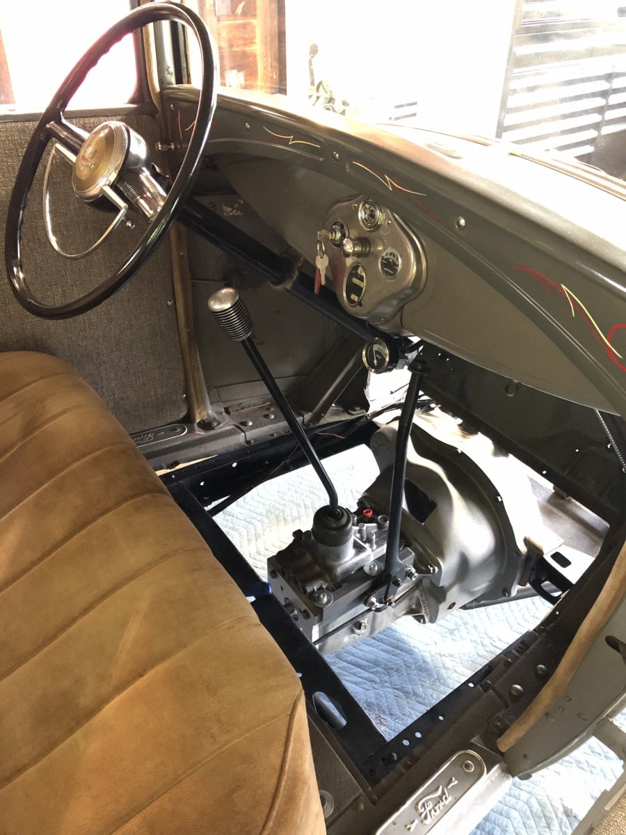

    Working on something similar but a little different.I have better picks I will post later with more of the finished parts together.It took a lot of trial and error to get the brake/clutch pedal shaft in the right spot for everything to work.Had to narrow up some of the areas on the pedals were they ride on the shaft to get them in the right spots to work correctly. Had to reshape the edge of the brake pedal where it hit the steering column as well.Theres not a lot of room in that space to get it to work like it should.I like the support bracket for the shaft shown in your pictures as mine needs more support for the downward pressure the clutch pedal makes when its pushed in.

    BURL , what pressure plate & clutch disc is that . looks good

    Burl,
    Isn't that a Volvo transmission?

    Yes it is I like to go against the grain in the end I hope it all works

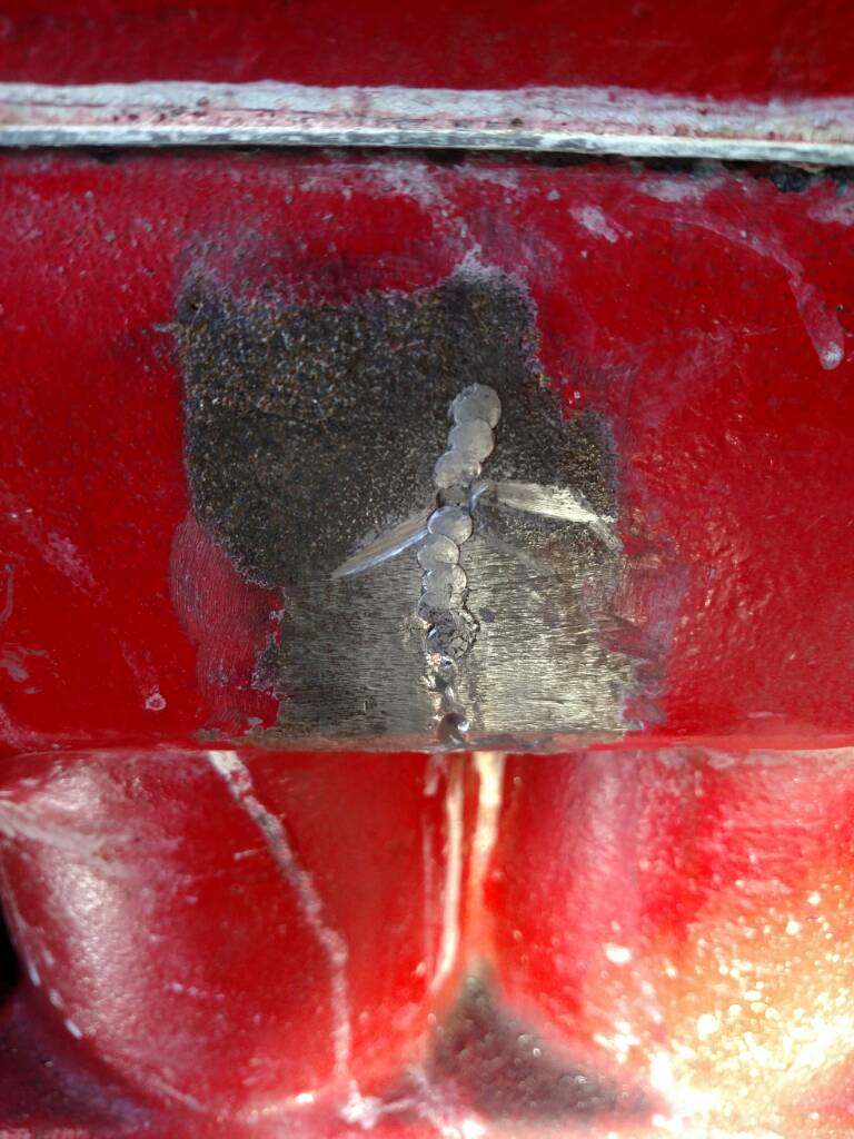

    So my OHV in the Vicky runs really good but....the block is cracked and no miracle in a bottle works.
    The cracks had been bondo up and painted over. The machine shop in Wyoming, Michigan, that I got the engine from, represented it as 'ready to install'. I've had to go thru the head as the valves were so sloppy and rockers so worn it was totally unsatisfactory.
    I'm going to lace the cracks with 10-32 hardware screws. After wasting two and a half days talking to stitch-n-lock folks I've decided to do what I've had success with in the past. I'm using Locktite and peening the end of the screw... IMG_20190420_095301990.jpg IMG_20190420_095304684.jpg I'll post finished photos

  21. winduptoy
    Joined: Feb 19, 2013
    Posts: 3,921
    winduptoy
    Yes, I believe that it is. I am relearning things that I did a long time ago..and had a mentor....should have listened closer when he said "put attention"
    There is a technique and I recall the principles. I got the one on the right laced up. I found that there has been nickle welding on the cracks and I got into some hard stuff, really hard.
    I'm taking a break and I'll post some photos later.
    I haven't shown a photo of the crack under the water pump on the front of the block

  22. winduptoy
    Posts: 3,921
    winduptoy
    Yes it is. I don't care, just tell me what I am getting ready to buy and don't represent it as something it isn't.
    I'm wanting to take this to the dirt drags and I clearly can't run it this way. I'll make it better or worse...but then It will be my fault.
    This is a B block and they have a reputation for having 'thin deck' material.
    The material really isn't very meaty here, about 3/16". I suspect someone got it really hot and put cold water in it....more than once. There is also collateral damage from the welding repairs. The only real way to weld cast iron is to preheat it in a furnace for around 850-900 degrees F. Then touch weld with cast rod. Then you have to have a controlled cool down. The existing welds weren't done that way.
    I really can't loose anything here

  26. winduptoy
    Posts: 3,921
    winduptoy
    You can do this...I know that you are patient. The problem with brazing is multifold. The cast will continue to crack in the heat zone between the chilled and the hot material....you can chase a crack all over. Termination of the crack is difficult. Once the area is brazed you are committed...no turning back.
    I'd had to disassemble to a point, at least taken the head off. I'm still working on the technique but it is coming along. IMG_20190420_124343078.jpg
