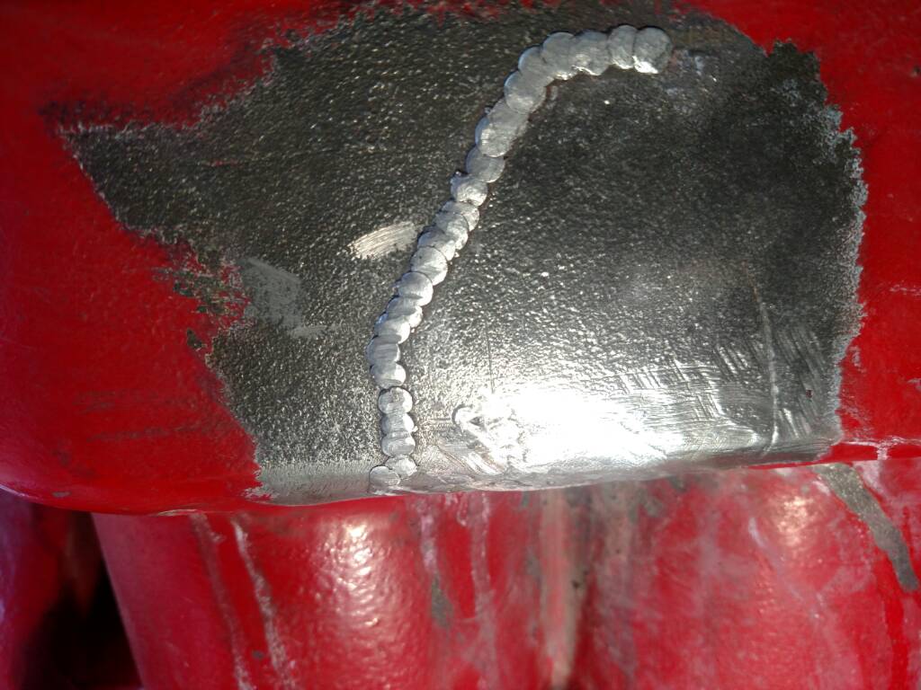

    Nice work...I have a B block with 21 crack pins in the deck..it can be done.Ford mechanics fixed cracks with spelter,a mix of bronze and iron filings,they would work it into the crack by hand then hammer it,repeating process over an over till the desired result was achieved..tedious?

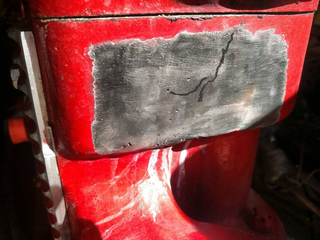

    IMG_20190420_161144467.jpg I believe that I got this one. This block has been poorly repaired all over. I guess this is 25 pins. The spot to the right was welded and has pin holes from porosity in the weld. I was able to get the surface to tin and filled with 95/5 solder and a soldering iron.

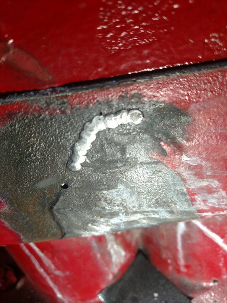

    This area had more weld repair with porosity from trash in the weld. It had a weeping leak. Again I was able to get it to tin and covered with silver bearing solder. I've got some more cracks to figure out how to fix. They are in the adjacent area to a weld. Head scratching required. IMG_20190421_084020841.jpg IMG_20190421_091045933.jpg

    Good work. I am amazed someone could sell this to you without saying something and sleep at night. I hope it is worth your effort.

    Bitchin' Stitchin' Larry!

    I have used this method when repairing a block with freeze cracks, like maybe what yours is, I "v" out the crack after I have drilled a 1/8th" or so hole at each end of the crack and use JB Weld. Usually I have the block on an engine stand so I can position the block to keep the epoxy from running out. You didn't mention if you are running a pressurized cooling system, if not you only have to fight gravity. The crack under the lip of the block at the end of that crack can be "v'd" out, you can apply the JB Weld to the area and quickly apply duct tape over the material to hold it in place while it kicks off.
    I have used this material on the blown alcohol RED, one of my MB's engine deck with success. I have a overhead conversion I am doing on a "B" block, where I am bonding a plate to the deck so I can mount a modern OHV head to the block, we will see how it works. I use a 3M product to bond replacement panels to vintage bodies with great success. All of the car manufacturer's use a form of the 3M product to assemble your new car. Major portions of the Boeing 787 and the whole tail assembly of the A-380 is held together with a version of the material. Epoxy will cure out under water so it will hold in your "B" block.

    We use epoxies in heavy equipment repair,the best I've used is belzona,it handles high load,and is machinable.deals with heat as well. That is some spot on pin work brother,I'd clear coat it so I could show it off..bangers are all about the skills of the builder

    I forgot to mention that when I pin a block or head I clean out the scale and rust by circulating 100% pure white vinegar thru the block for a minimum, of 24 hours. Then flush it out completely and pump in a ceramic material used by the block and head repair industry, you will have to google it, I don't have the name with me here on the west coast. If you need this and can not locate it, email me and when I am near a computer I will find it. You will have to heat up the block with heat lamps and keep it hot for 24 hr's while you maintain 5-10 psi in the block. Follow the instructions that they recommend, the shops use this stuff to do a good leak free repair.

    Thanks for the feedback...
    Yes, I am leaning that way on this one. It is some really, really thin material. I've got some product that I've used at work for temporary fixes on medium pressure/temperature heat exchangers that wound up being more permanent. I'm thinking that I may sandwich a 2 part epoxy between some 26ga sheet metal and the block. I was messing with some 2 part repair putty that I put on a small part of the area. I'm going to let it set up and then try to take off.. It may become a combination of things.

    I'm leaning that way on this repair. I couldn't bring myself to do that on the side of the block. I'm still going to try to make it look like is hasn't been repaired but I'll be happy for a leak free save of the block...added bonus that I didn't have to dismantle to repair. I use epoxies and two part products routinely for customer machine repairs so I'm a believer.
    Thanks for the kind words about the stitching job. The fellow that showed me how, put bread on this table by doing this kind of work every day.

    I'll keep that in mind. I cleaned the tapped area with fast evaporating solvent....well OK starting fluid.
    Then used the Locktite primer and Locktite on the threads. I'm going to pressure test and hope for plain old dumb luck.
