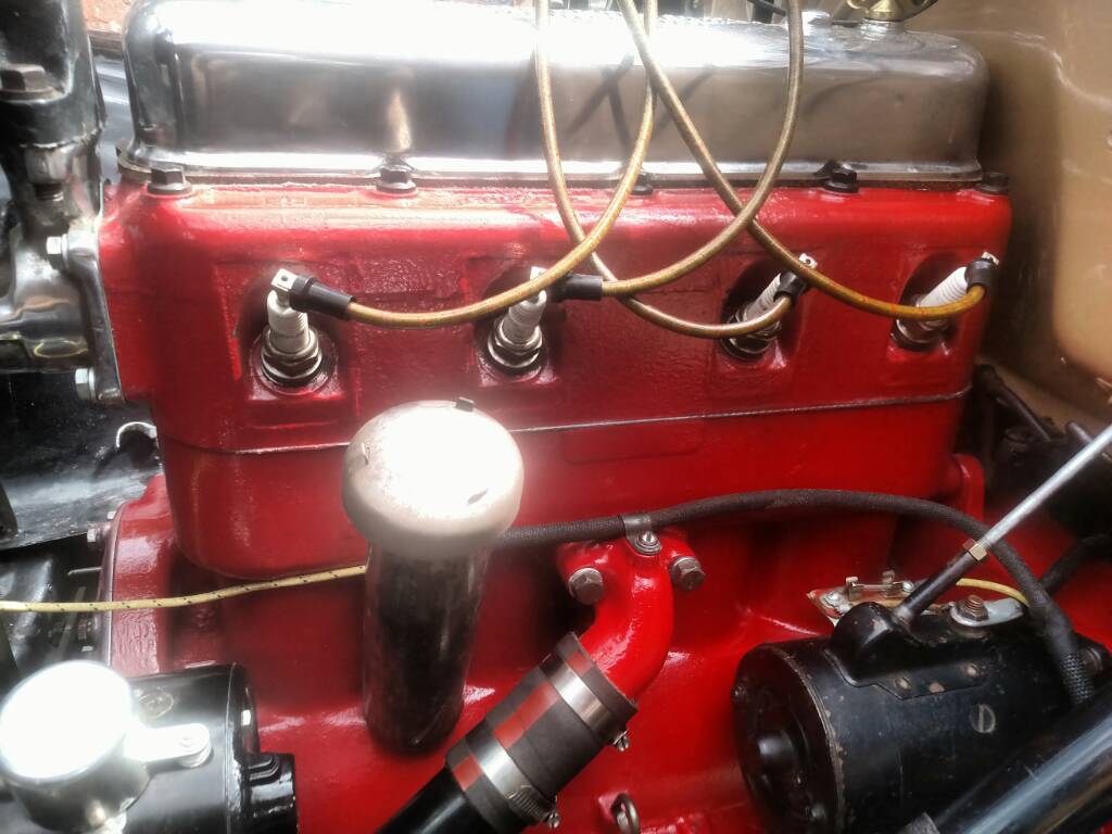

    E9C42648-EC9F-4B39-8573-EFC804C657A8.jpeg Went for a spin yesterday after work. Need to lean it out a little but starts and runs good with the burns/97's combo. One carb had 45's in it, the other 52's(!) A lot quieter with stock exhaust but that's ok. It'll get a straight pipe after I get the timing nailed down.

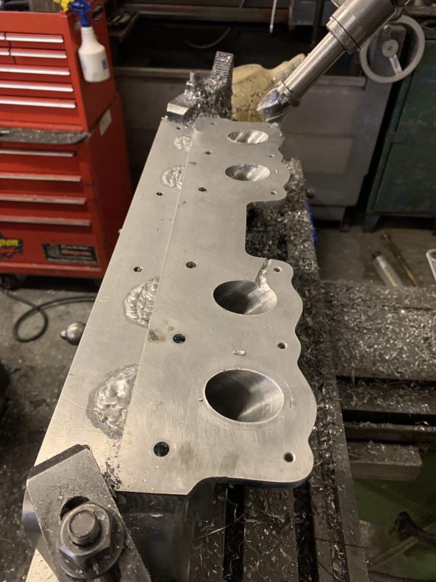

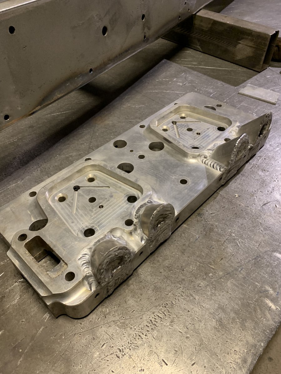

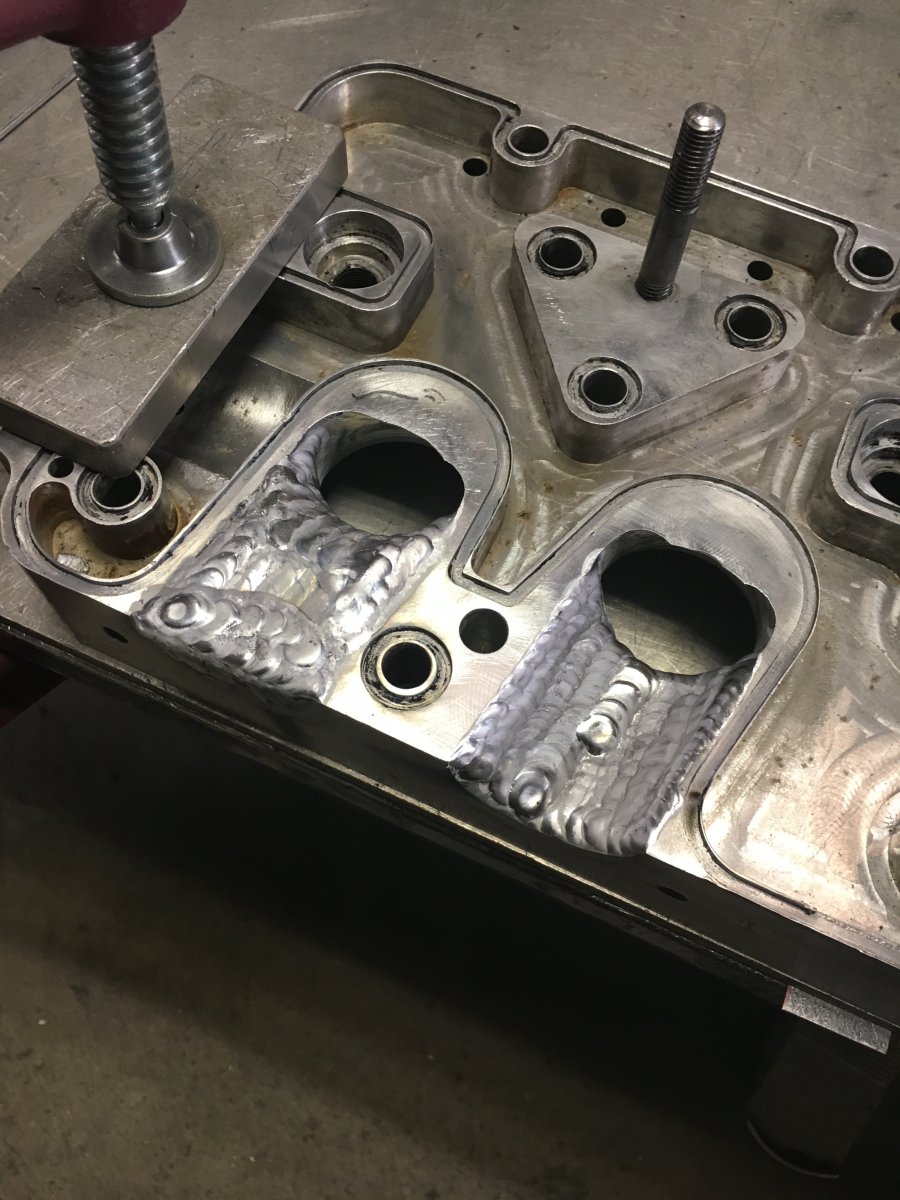

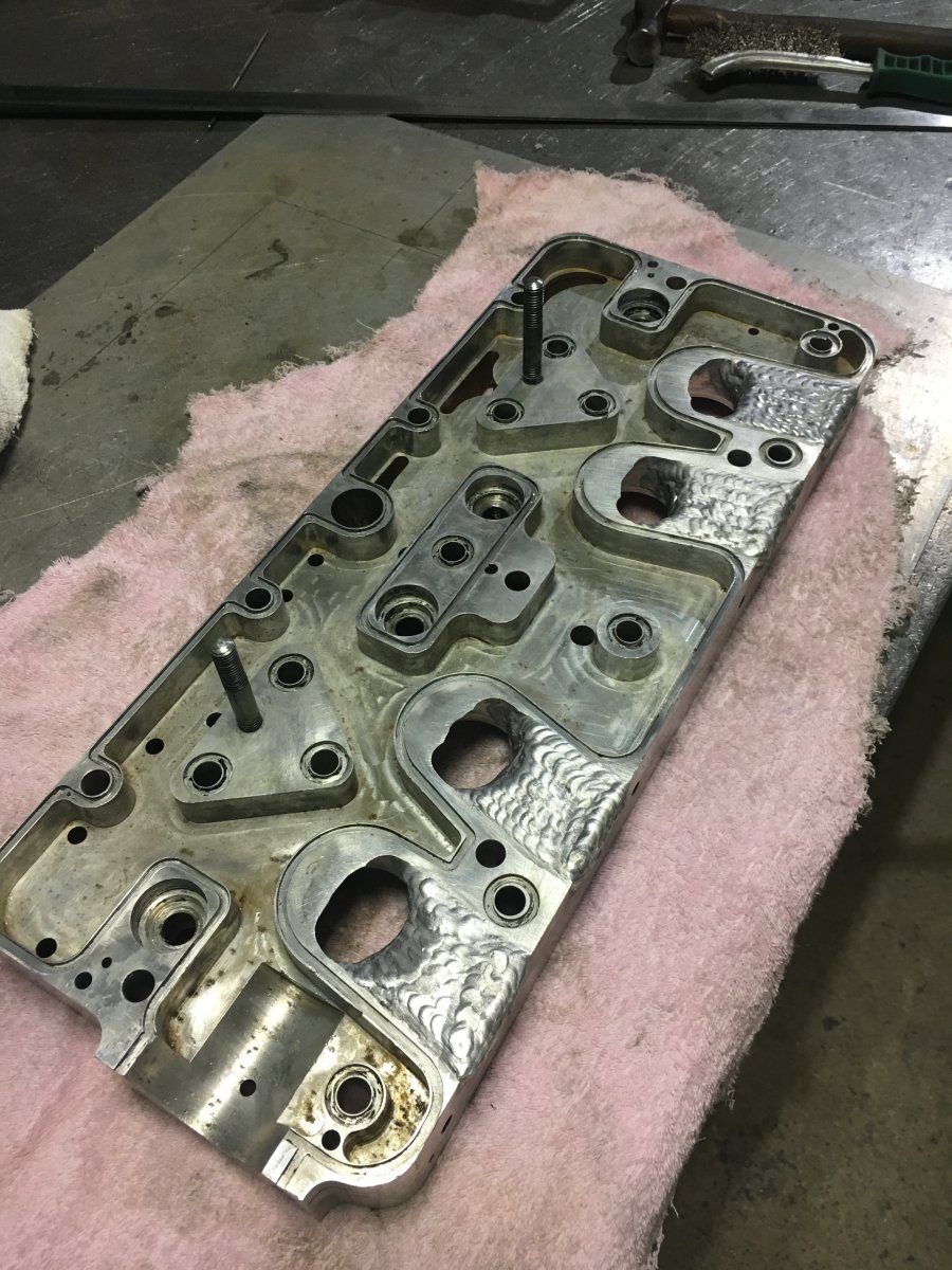

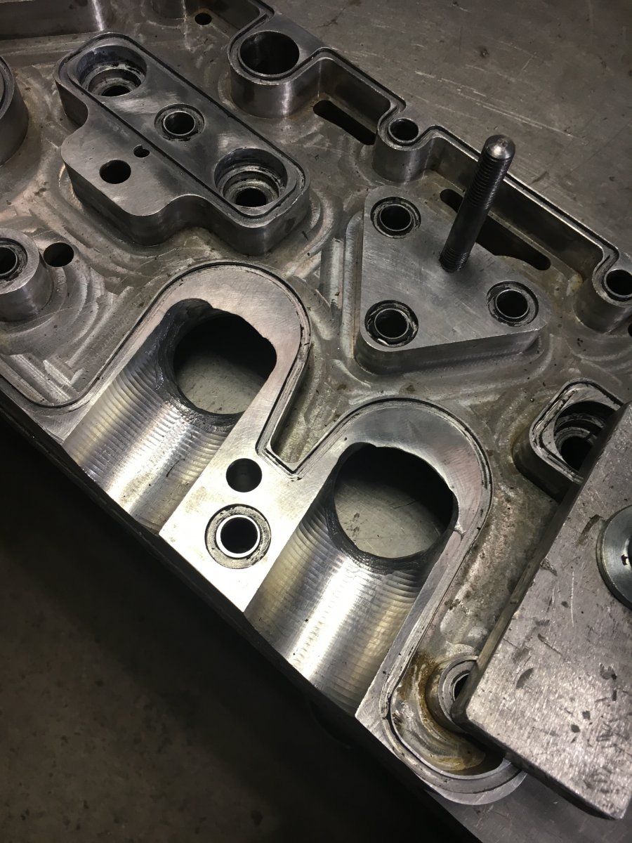

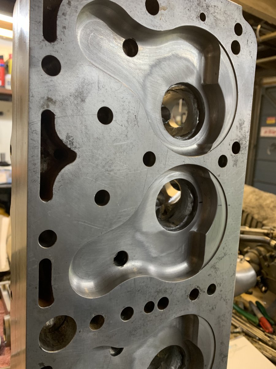

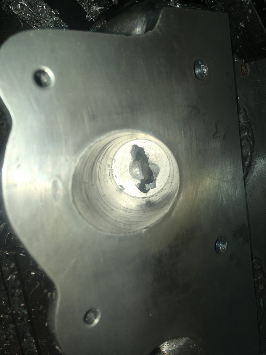

    Bit of an update on the A motor I’m rebuilding.
    I’m changing the ports on the F head from side draft to semi downdraft. The reason is that the ports were so flat that the flow was below 50%. The 1-7/8” valve was flowing less than a 1-1/4” valve in a 1960's pre Crossflow engine.

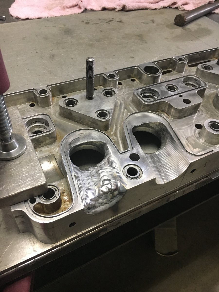

    The head is a two part jobbie so a bit easier to work on. First bit was to weld up the existing ports. For this I filled the void with weld rather than make shaped pieces and weld in. The idea was that when I start the porting I don’t want to be limited, ie not going through the welds and exposing cracks.
    E9F90094-A438-4F56-8CB3-5AA9B7991131.jpeg 104FCDD2-26B0-4044-81F4-8EA87636453E.jpeg 49866218-E3FE-4FA6-ABEC-E54DA2F17757.jpeg C311F2AF-7340-4F0C-9AA9-C54D223D245E.jpeg

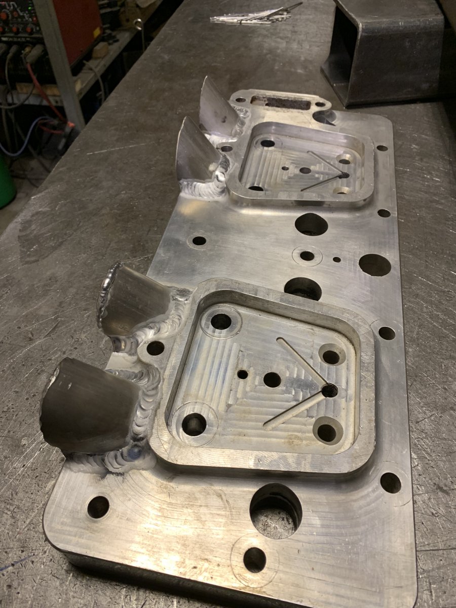

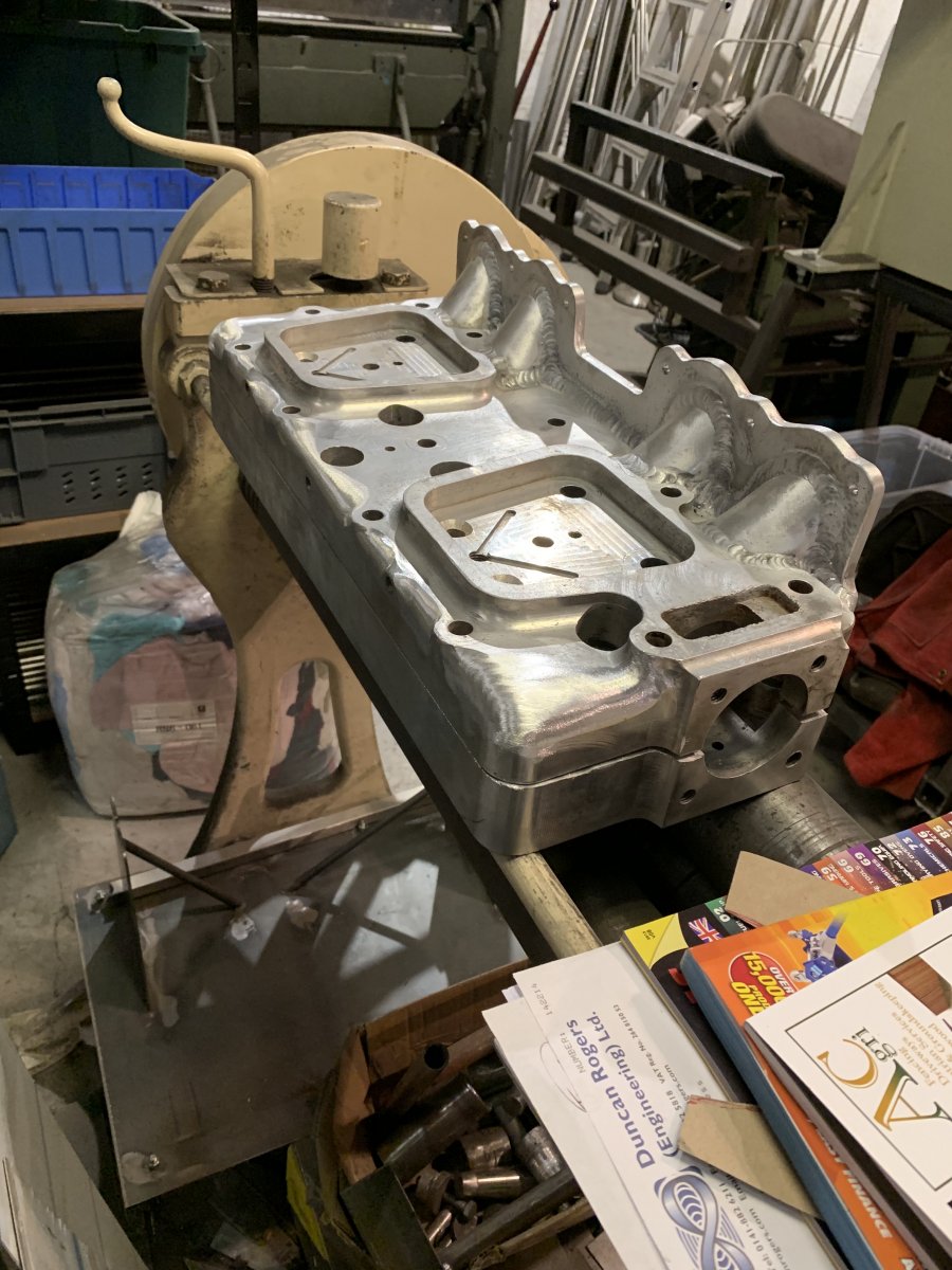

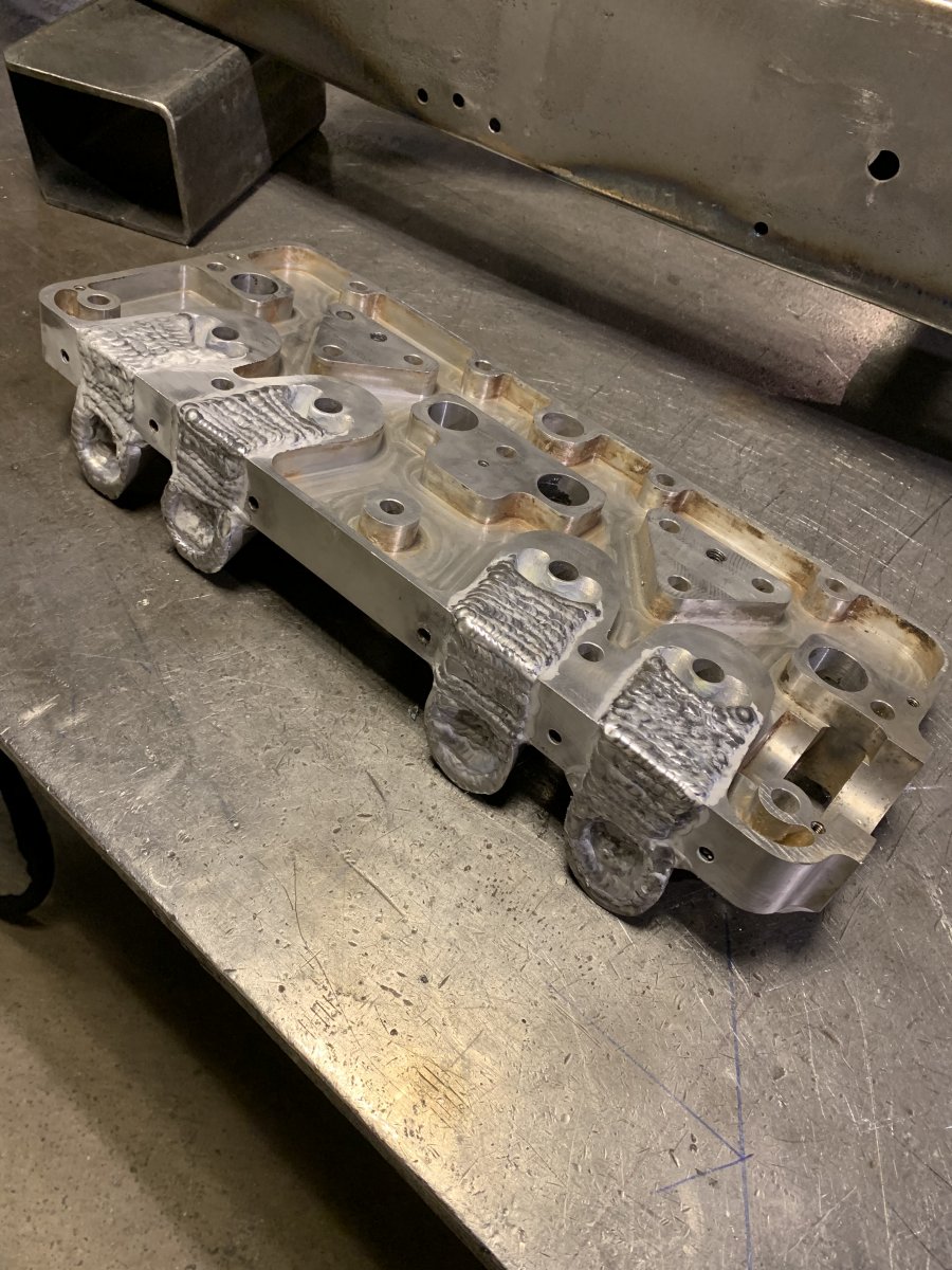

    The top part of the head I welded four tube parts at a 40* angle. This will be the new port angle. And like the first part was fully welded. Total Welding time was 20 hours.
    15889677-4C27-4CFE-9A55-D20C96147409.jpeg 97F45BF3-7143-46FA-A5AB-0F4435878CD3.jpeg EB649037-707C-4817-BD78-AB3267009E35.jpeg

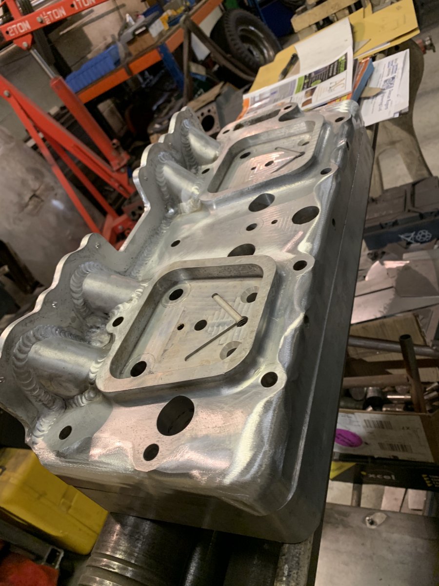

    A plate was welded on as a mounting flange for the intake manifold. I also couldn’t stand the hard corner billet look so attacked it with a sander to give it some shape.
    6863179E-9647-47F5-A62F-8FCC9D5065A8.jpeg C8AA933B-3C8E-4AA2-AF80-2965CA843BFF.jpeg

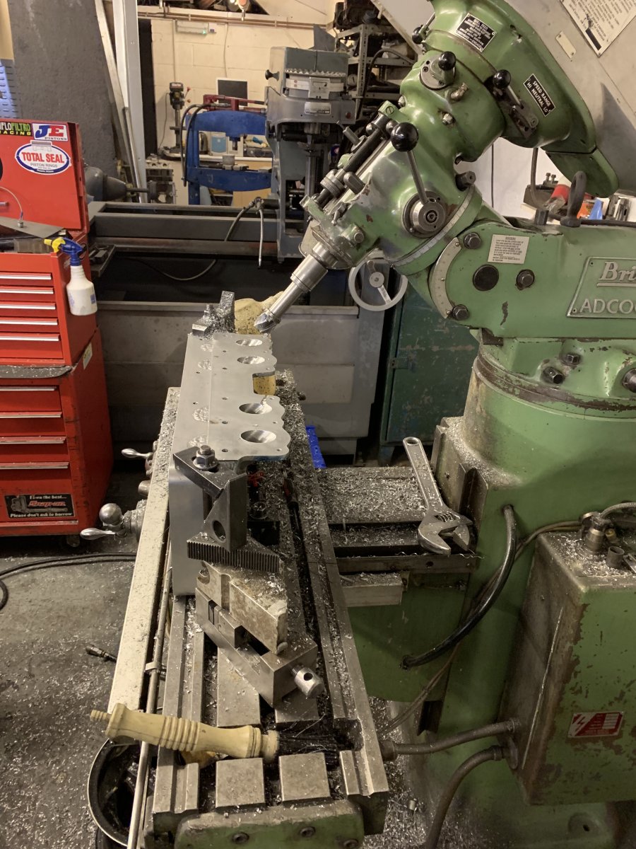

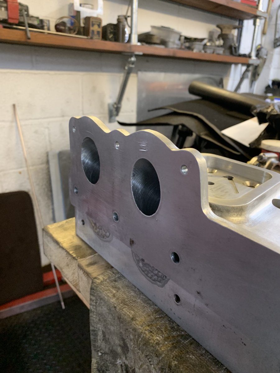

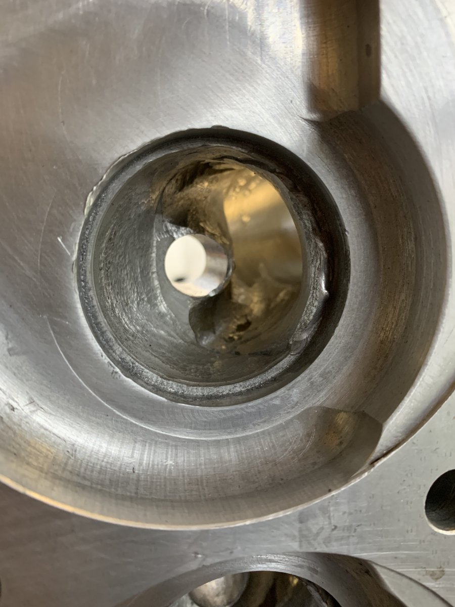

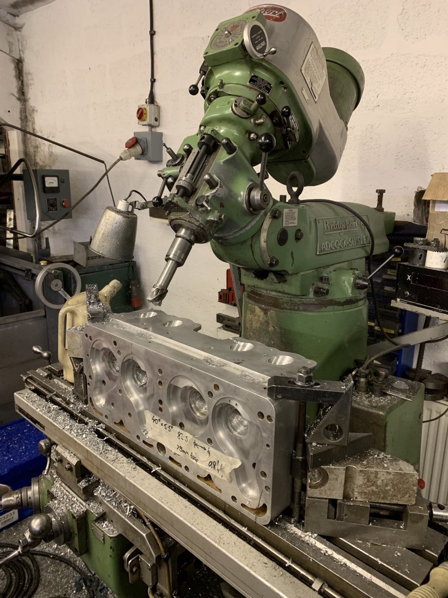

    Using a friends mill the head was set up on the table and a 35mm hole bored through. Ignore the slight scar, the end mill jumped out and skipped along the face because I didn’t bolt the mill head up tight enough. It welded up fine.
    05B936E7-F2DF-4CA4-8328-505B420C5209.jpeg 0F75DC24-8D7A-484E-A2EA-101177E85D0A.jpeg C24F348F-97F7-46C3-8304-B0BF7B29975C.jpeg ED0C989A-DAE3-4542-96F1-B9182A1698A7.jpeg
    Still with only 35mm bore I finished up the ends of the port by hand. Just to see where we were and in the right place. The head will go back in the mill and eventually be opened up to 45mm.
    1B169963-5C7A-417D-8664-48F45F472CFC.jpeg D337C6BB-4CFA-445C-9F16-B9F698BFA7FE.jpeg D0B6ACCB-0E1A-40F0-B1D8-8612DC9FEC26.jpeg

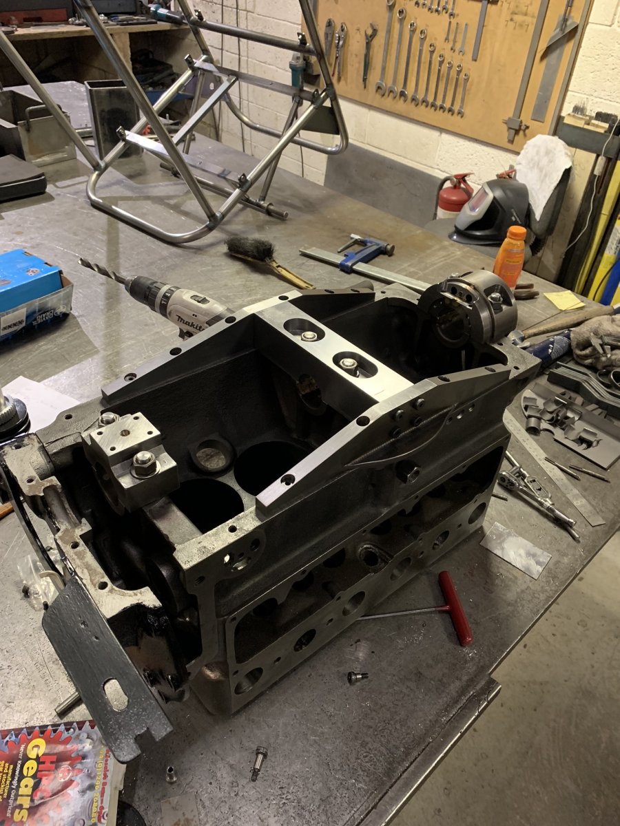

    I’m also working on the bottom end. The front and rear main caps were already fitted to the motor by the original builder as was a similar centre cap. I’ve made a new centre cap wider so it can be bolted to a couple of plates to tie the block together and strengthen the centre bearing.
    D2F05127-61A3-409C-9CDD-AD73A2072A7C.jpeg 8741B527-D00C-4EE1-8968-BEE1DC09F4E4.jpeg
    Pete.

    BTW Pete:
    I have an original alum Cragar intake (single) that would benefit from a guy with your skills/talents. A lot of these old intakes had an 'ear' broken off, as in this case.
    I'd give you this intake, if interested, so that you can perform your creative magic on it ! PM me if this interests you.

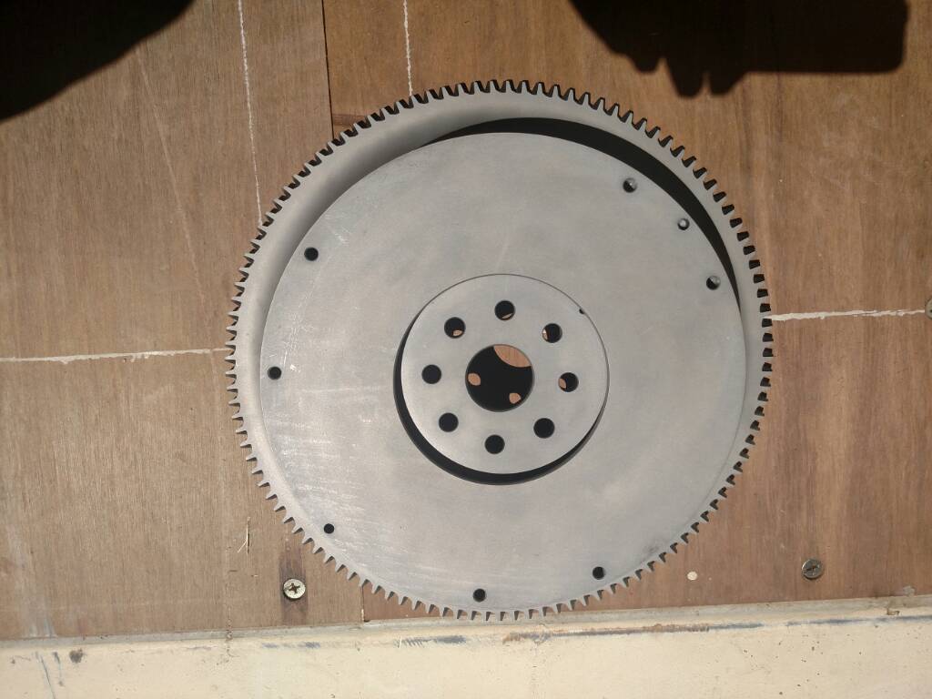

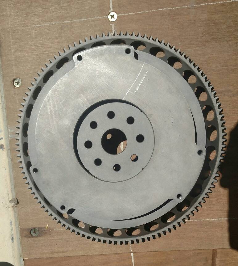

    That's pretty cool.I did a lot of cutting on mine but still ended up around 43lbs.Not sure were it would have been safe to remove more without reducing wall sections.Do these bangers need some weight to offset some balance issues or is that just a myth ?
  26. JT1930
    Joined: Jul 1, 2018
    Posts: 220
    JT1930
    @burl I've heard that also. But from what I've gathered is the weight of the flywheel was to help lug the motor if you were stick in mud and was easier to get the motor going when hand cranking it. Are any of them true???
