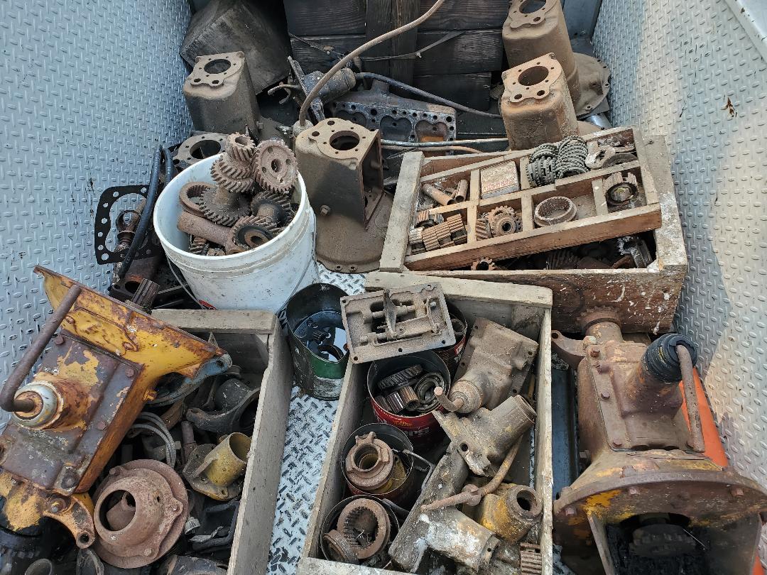

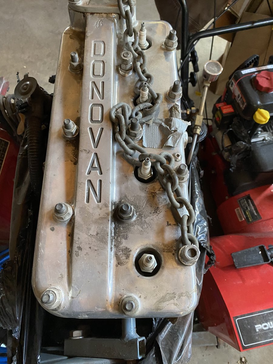

    4102758A-A64E-4A4D-8946-1538BE78A3A7.jpeg CA9F28AC-326C-4044-9FFC-F78650C39105.jpeg BB5A1FC7-A9CF-483F-A467-8C22EA159AD7.jpeg
    Some of the stuff in my $3000 model a parts grab bag. See HAMB cl***ifieds

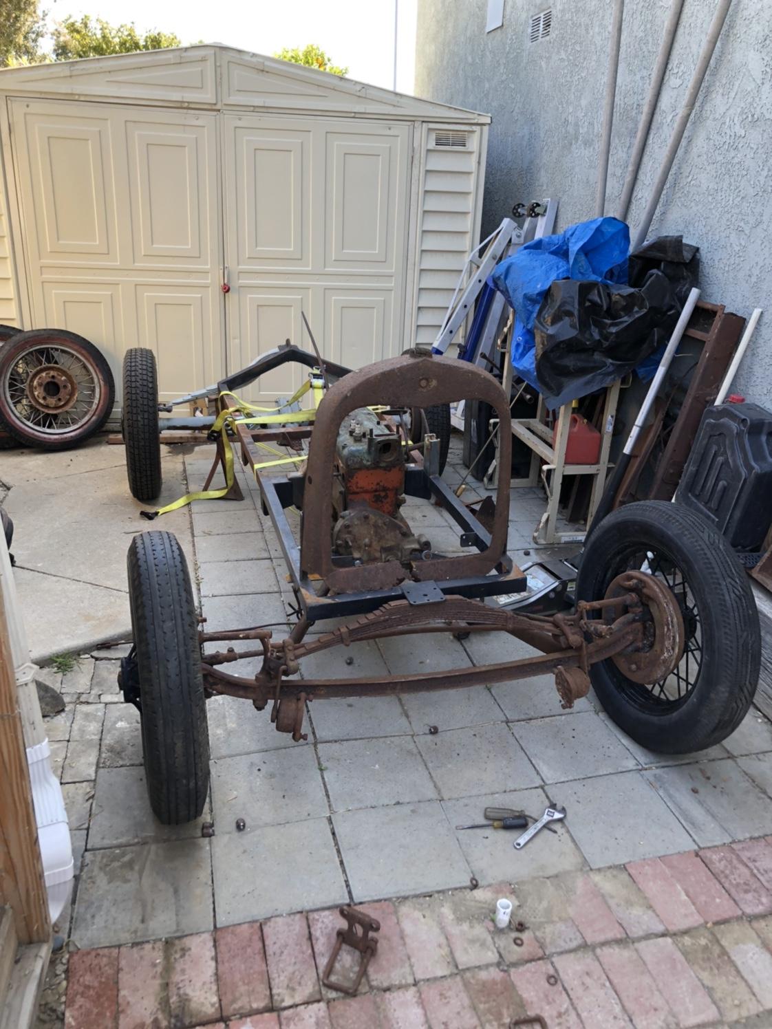

  8. With the baby in the way, it’s hard to work on the cars.
    Spent a few hours today yanking the A front end out, and throwing this 32 heavy on!!
    Using it as a mock-up, I got a dropped and drilled one coming!

  9. hotrodA
    Joined: Sep 12, 2002
    Posts: 7,409
    hotrodA

  11. Oh boy, those timing cover and side timing covers sure look rad!! I wonder how light they are compared to the stock ones.

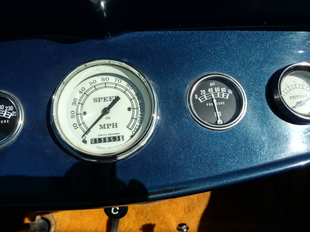

  12. 97
    Joined: May 18, 2005
    Posts: 1,983

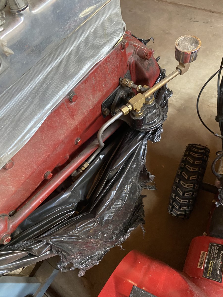

    97
    Great oil pressure, what pump? or did I miss that part? :eek:

  14. Probably not as light, I don't think the side cover will fit on the "A" motor, not sure about the "B".
    The front cover has added material for placing a pump in front of the cam gear.
    The "D" block is just hella stout, the way a race motor should be built.
    J

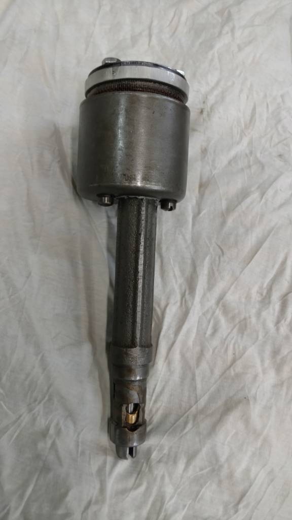

    Modified A pump with early V8 gears.
    They are the same diameter as the A/B gears but longer. Add a spacer plate with the same internal profile as the housing. Pay attention to the end clearance to the cover as little as possible to eliminate byp***...

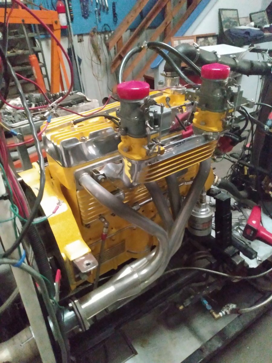

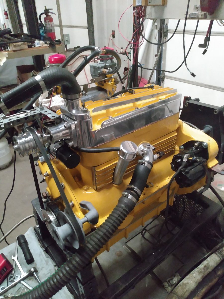

    B Engine 2.jpg This is on Joe Abbins dyno at the moment.
    I don't know much about it other than I believe it is Ron Coopers. It was supposed to have done 94hp on a previous pull but the dizzy was acting flakey. A new dizzy is or has been installed and there is another session this Saturday.
    I have an invite so I'm planning on checking it out. It is pretty and there is stuff on it that I need to understand.
    I also have been told that it is a babbit engine and he wants the dyno pull to be limited to 3000 rpm.
    I believe it is a Thomas head and has a Stipe cam

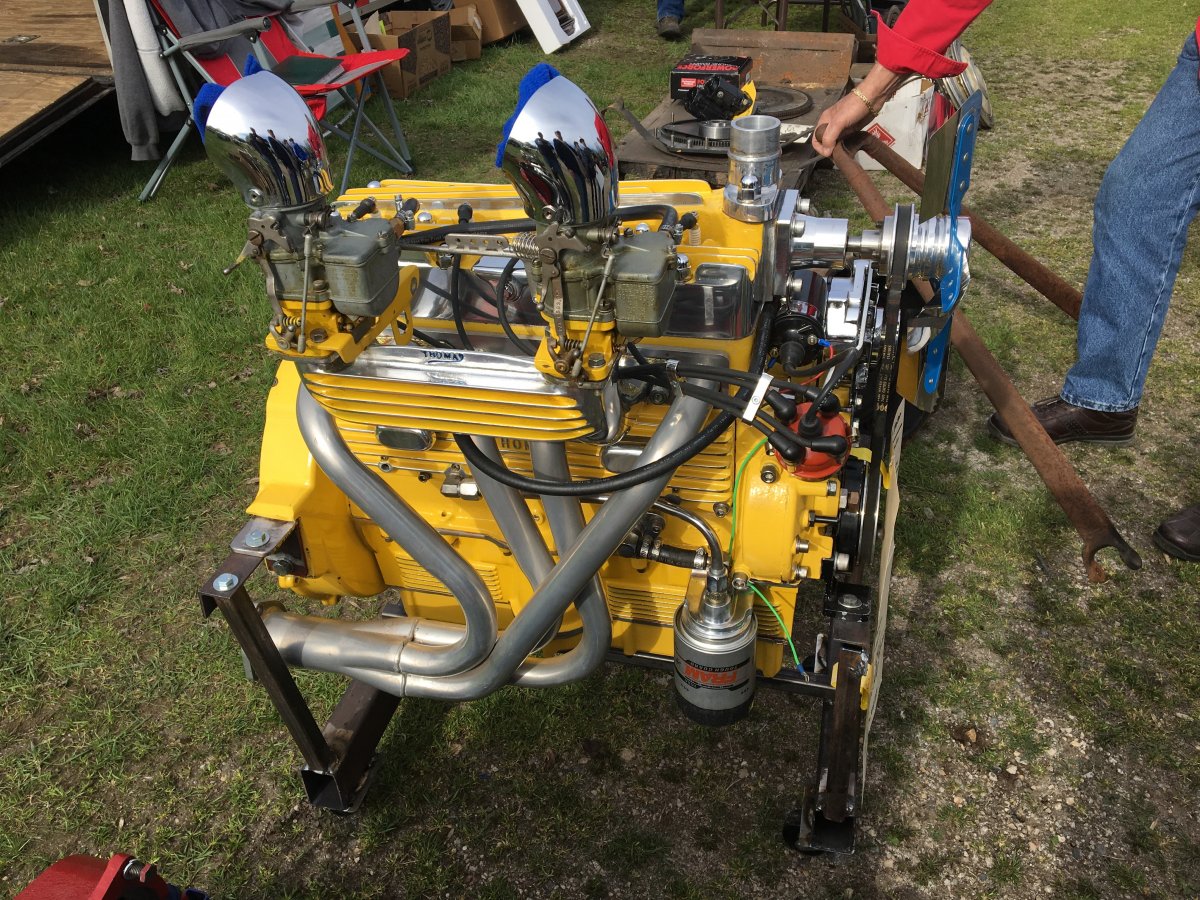

  24. burl
    Joined: Nov 28, 2007
    Posts: 890
    burl
    from Minnesota
    I wondered where that ended up. Looked at it in 2018 but was out of my price range. Had lots of cool stuff that was custom machined. banger.jpg

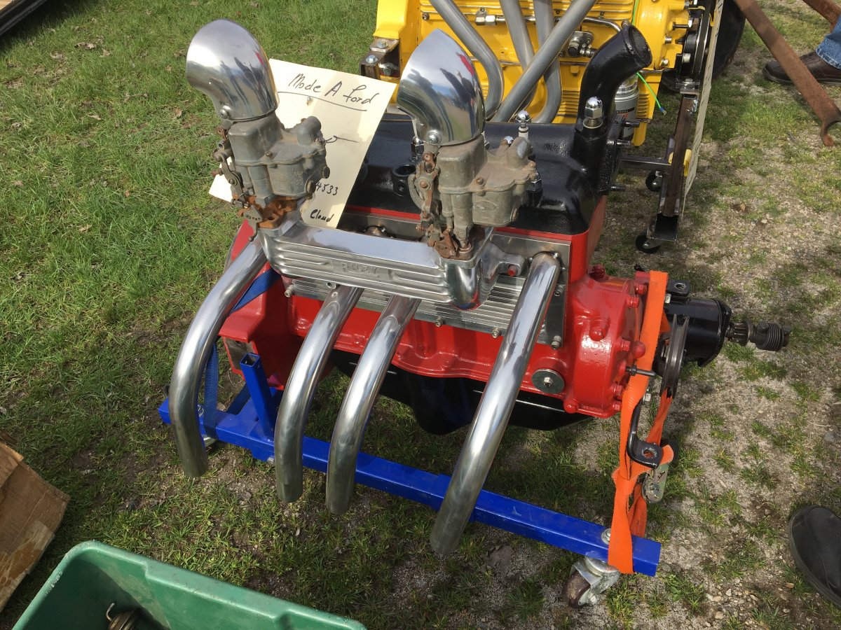

  25. That's bad***! I plan on painting my banger CAT yellow.
    Mind posting more photos of it? The distributor, oil pan, and V belt pulley tensioner all look super interesting to me.

  27. winduptoy
    Joined: Feb 19, 2013
    Posts: 4,182
    winduptoy
    I'll definitely take some more photos and post them

  28. burl
    Posts: 890
    burl
    from Minnesota
    Was for sale at the twin city's roadster swap fall of 2018.Was put together by a guy out of central Minnesota. Had this other one for sale plus additional parts to build more.The price on the yellow one was rather expensive but it did have a lot of expensive parts. banger 2.jpg
    Jet96 and camcrusher like this.
