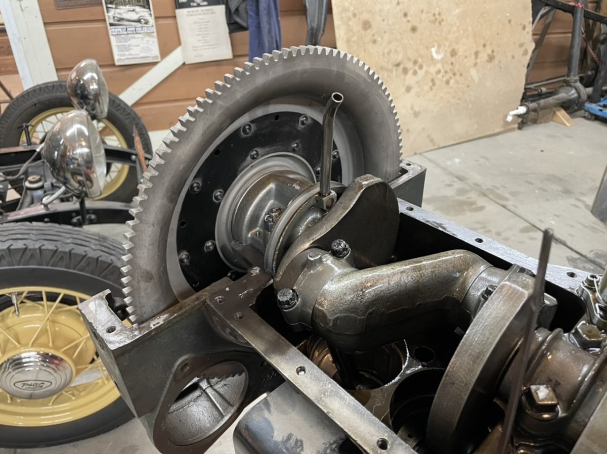

    It feels good to be back in my shop. I don’t get a lot of car time and that’s ok, there’s more important things. Working on some not so good vibrations. Thanks Winduptoy.

    You will have "Good Vibration" now ‼️ vey satisfied with my Rattler flywheel from Winduptoy nice oil pump to .

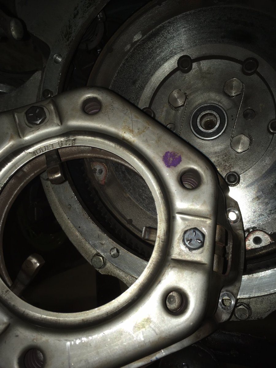

    IMG_4831.JPG out for a drive Saturday night clutch would not disengage, had to step on brake and kill the engine. While waiting for a tow I popped off the cover for the throwout and saw that one of the three levers on the pressure plate had broken off.

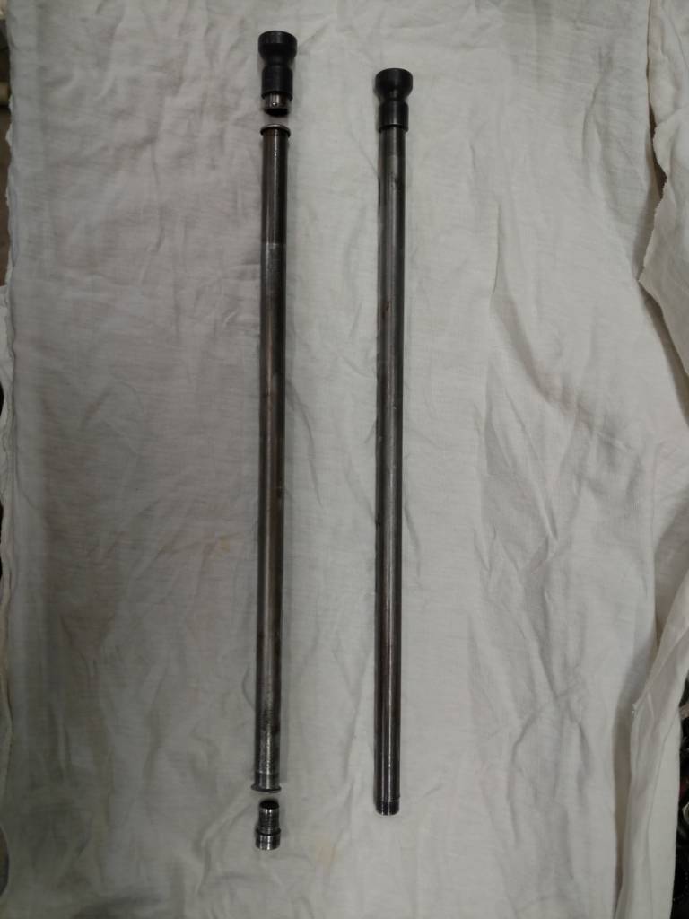

    Haven't gotten back to this thread, waiting for the Dyno owner to get back into town so I can get clarification on the corrected numbers on the readout.
    Went to see my buddy east of me, a 120 mile round trip, and took the Vicky. It dropped a cylinder on the way home. It broke a push tube.
    There is an advantage to a flathead...
    New ones on order from Smith Brothers.
    If you drive them, something will eventually break

    That ****s. Must have been abused in Iowa and at the ice racing!

    Yes, 1 time I dumped it MUCH harder than normal in the Iowa hillclimb.
