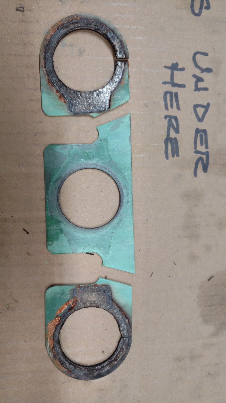

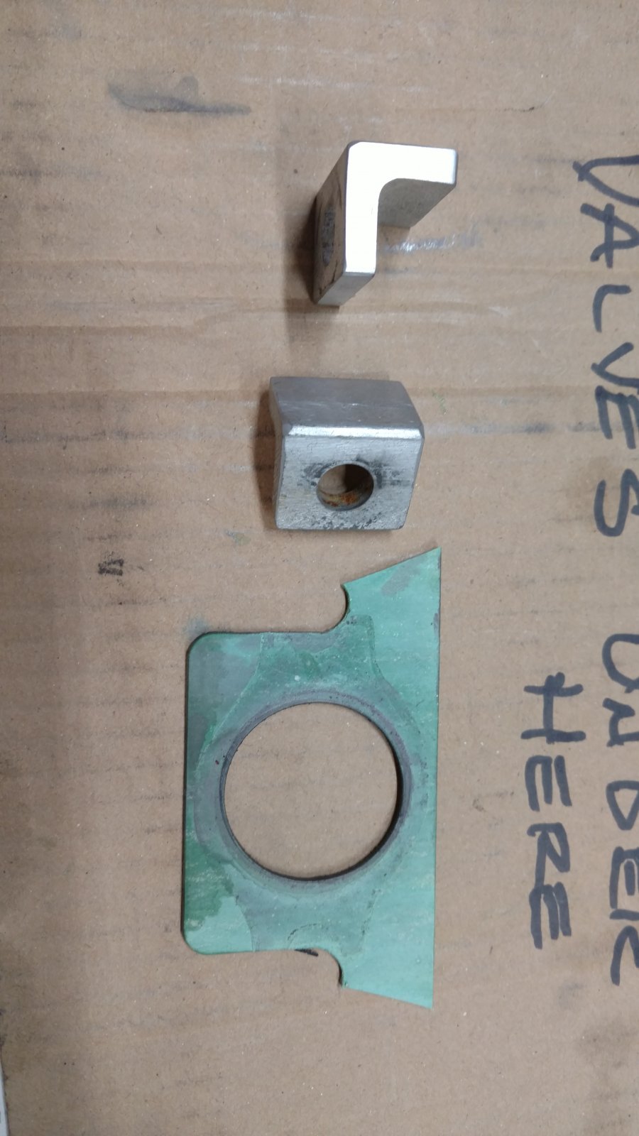

    what are the metal parts for?
  4. jim1932
    Joined: Jan 26, 2011
    Posts: 1,165
    jim1932
    I sacrificed a new one.......

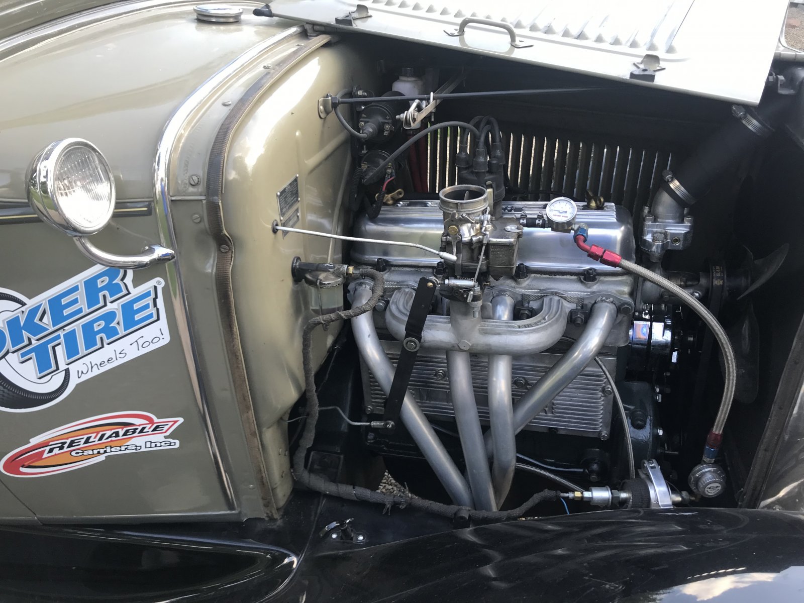

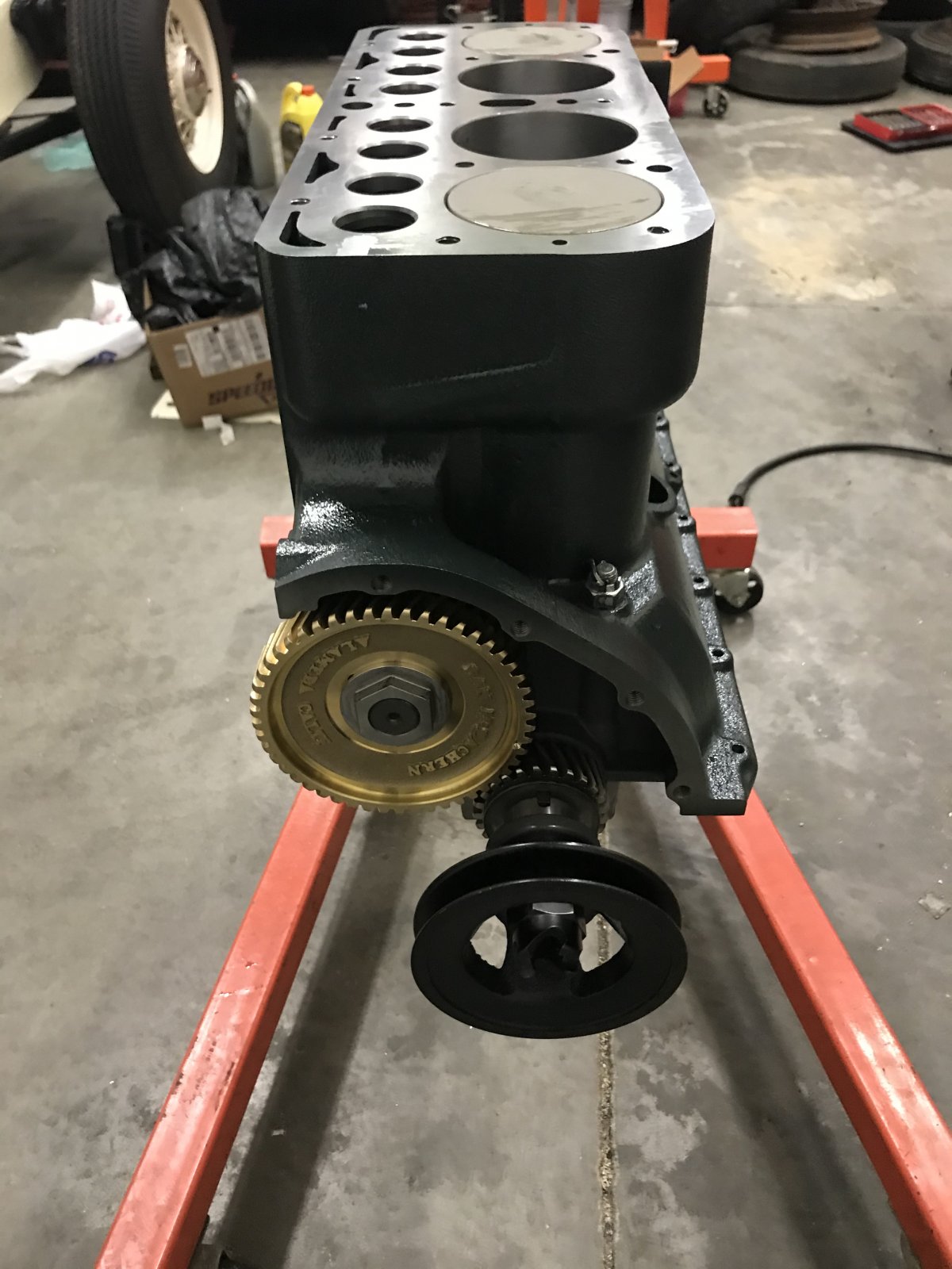

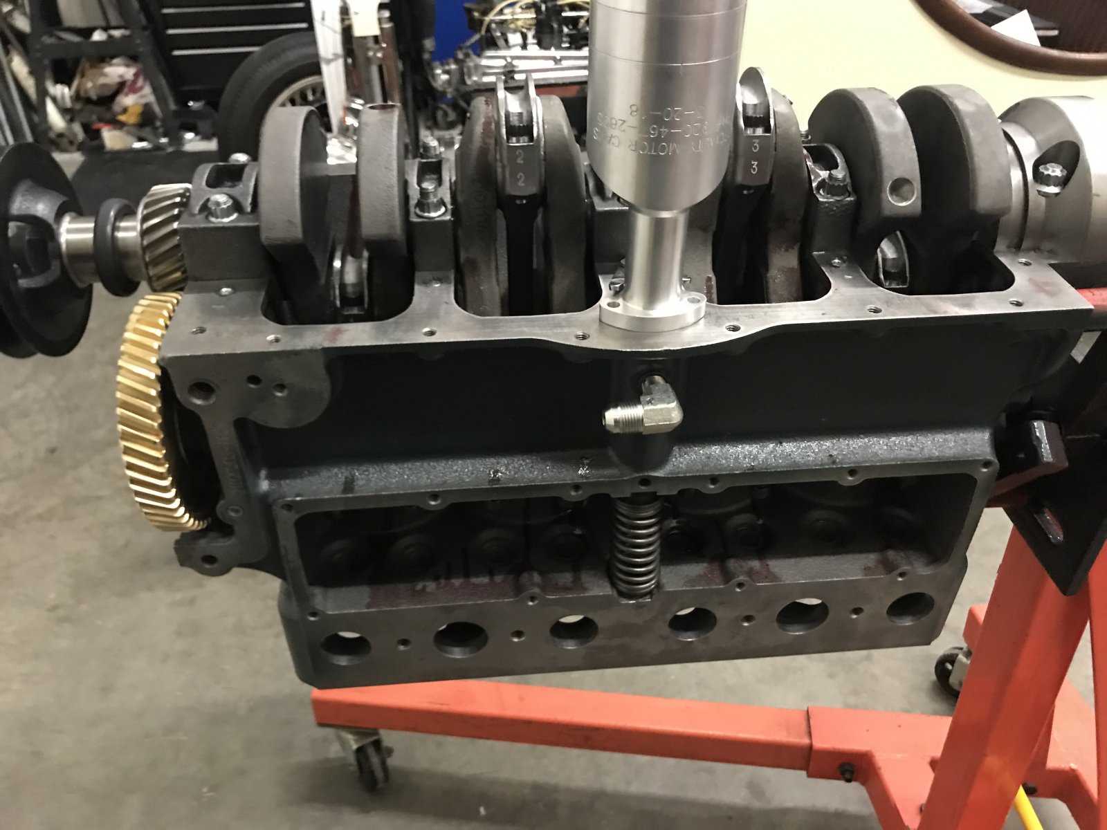

    This is our Burtz/Miller Engine we ran in the 2022 Great Race.
    The Specifics are:
    Brierley M-13 Cam; Good Street, good low end torque
    Stipe Oil Pump with Remote Oil Filter (John Nielson’s Pump would work as well)
    FSI Electronic Ignition
    Single Stromberg 97 Carburetor (Used to meet Great Race Rules, for Street, I would recommend a Weber as Dennis 4X4 recommended)
    Ceramic Coated JE Pistons (the pistons recommended by Terry’s Build Instructions are fine)
    Bronze Timing Gear

    We have a Single Stromberg 97’ with .045 Main Jets that runs fine on the street, more details regarding engine a few posts up.
    It had 80HP on ch***is Dyno, I think it was ~3600 RPM. We are also above 5,000 feet in Colorado.
