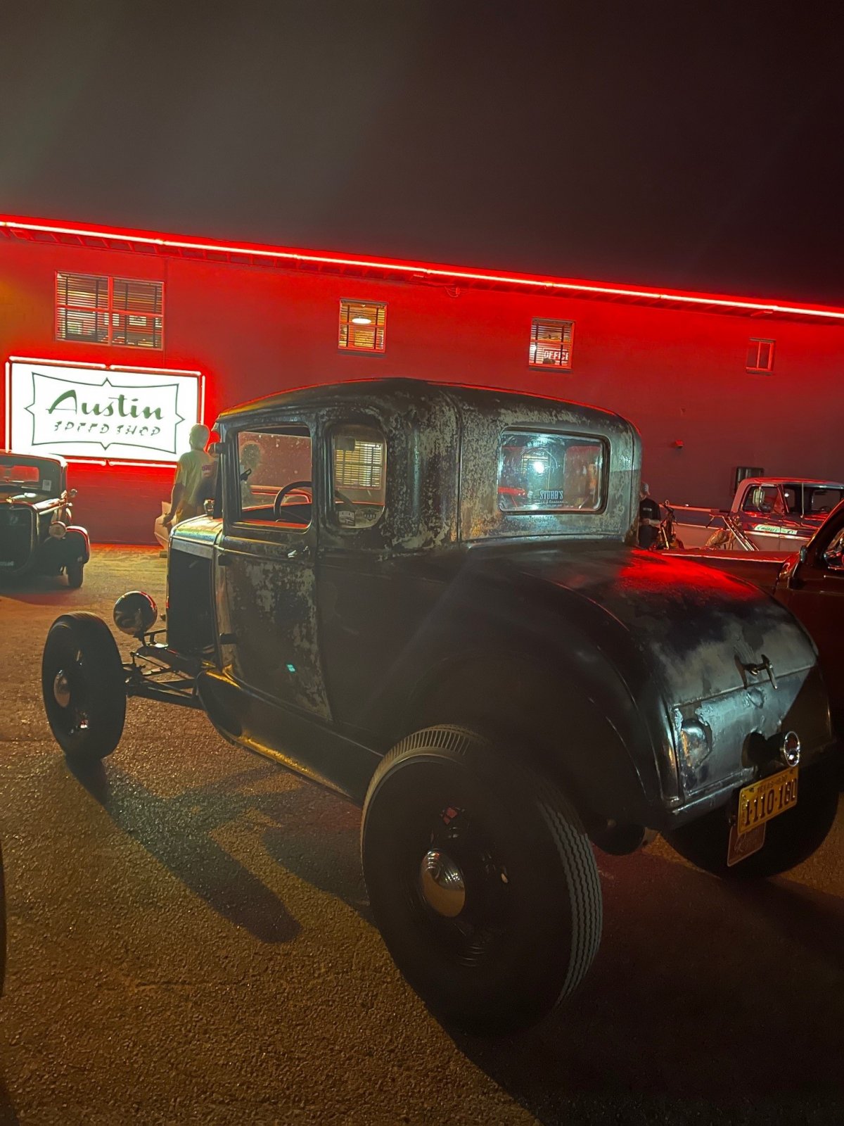

    Drove my all over Austin Tx for the Roundup... No pics at the show but here are 2 on opposite ends of town on the same day... Alot of people amazed by the banger and tons of great comments and love.

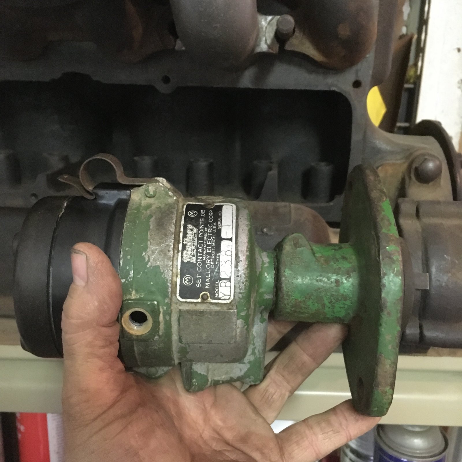

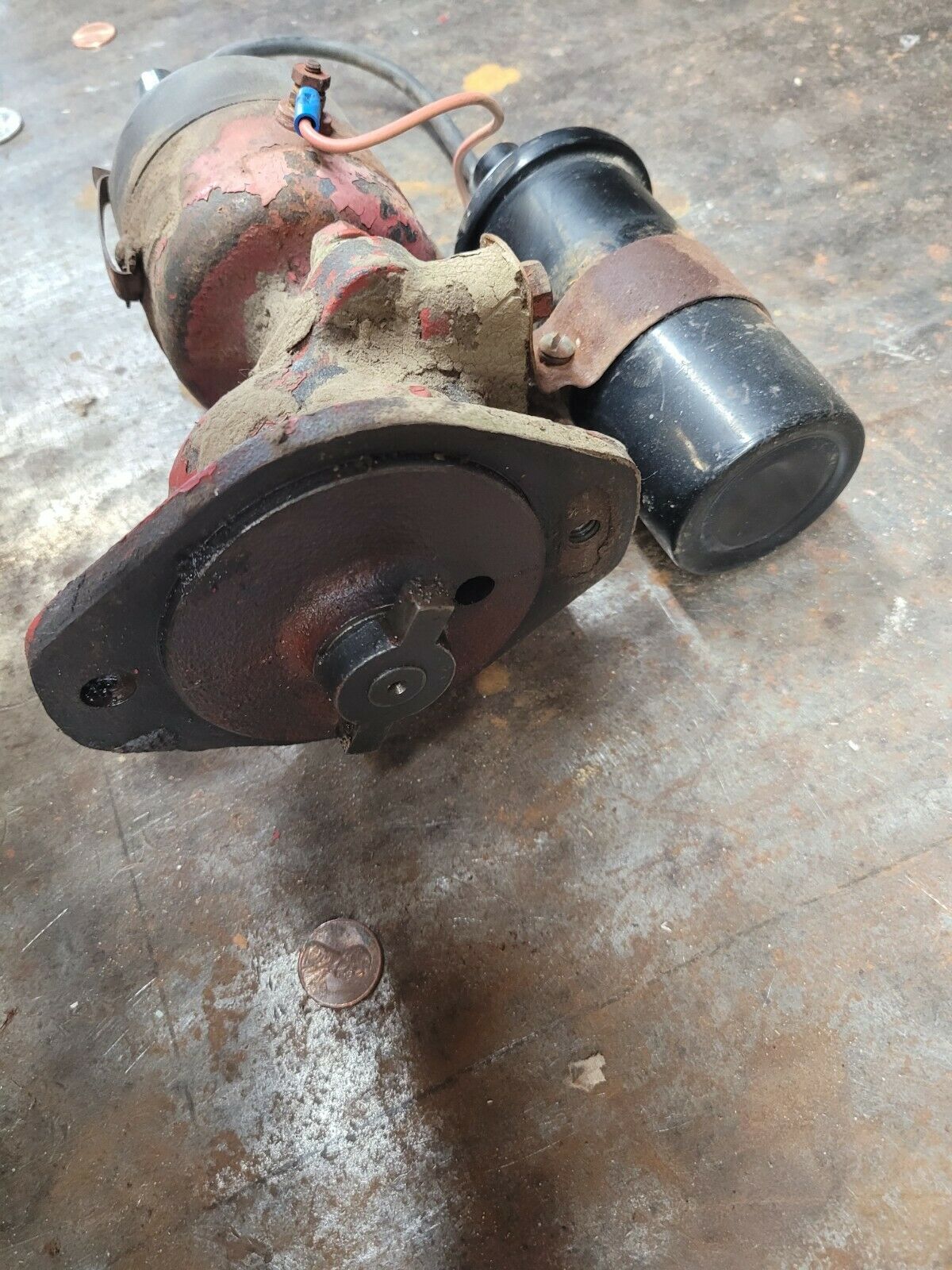

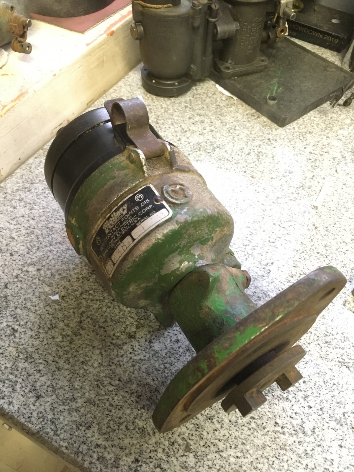

    Burl and I went to a tractor swap meet and I got this old 4 cyl Mallory it’s painted John Deere Green has a coupling to be driven.
    John I know that the distributor will twice the speed but can’t I just have it spark every time the Pistons TDC just like my Harley in my triumph motorcycle do? I’m thinking all I would need to do is change the springs on the weights. And of course I need to use a distributor that can handle 6000 RPMs. It’s a good thing I have a distributor machine.

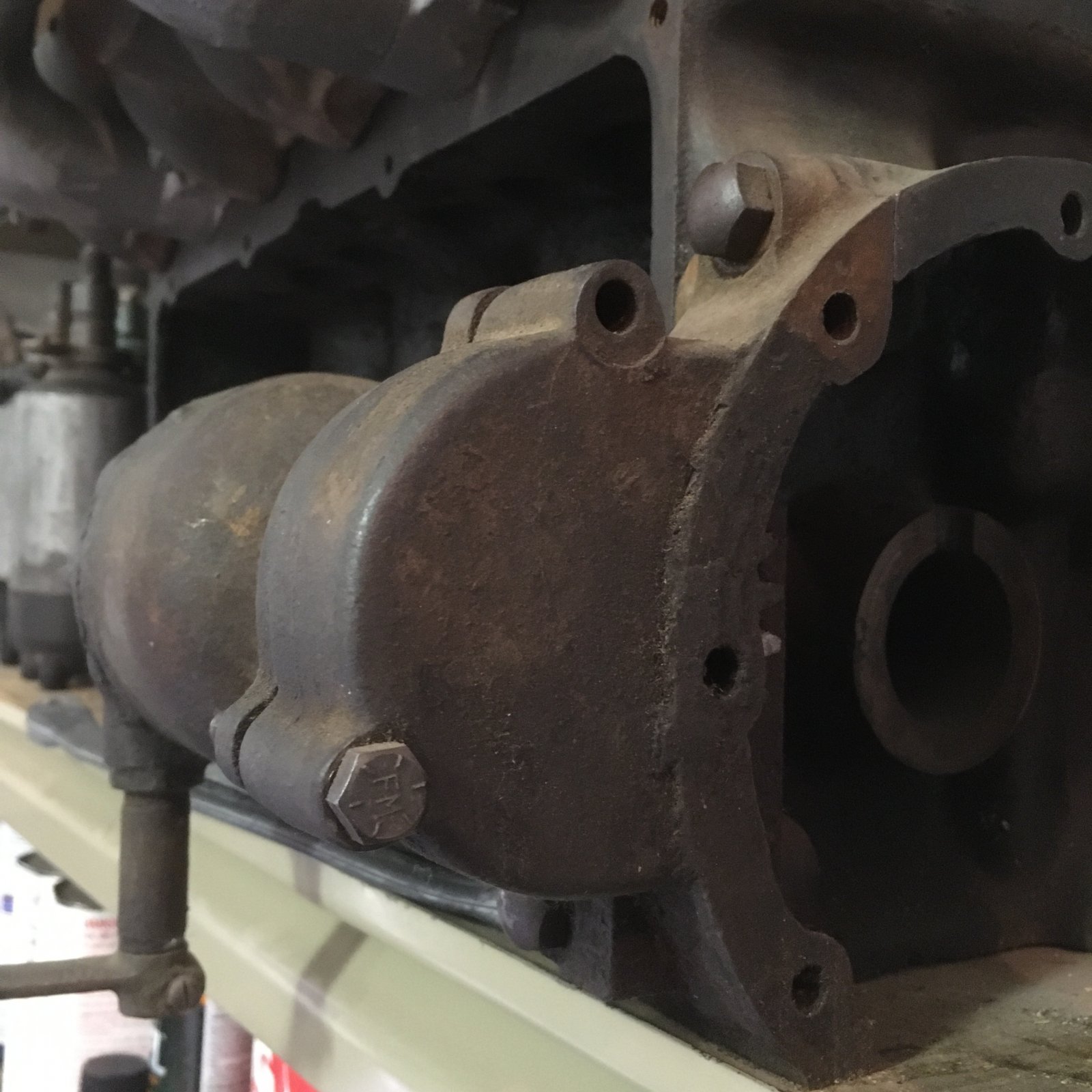

    Governor from an model A-compressor

    it is not about speed, it is about position, well and speed, the points will need some attention to prevent floating too.
    But, back to basics, crank has basically two TDC positions (1&4 and 2&3 stock config)
    If the dist runs 1:1 with crank, then both 1&4 fire together and 2&3 together in a wasted spark configuration as the Harley. The other two positions in the dist are not used. This has been attempted before, not with much luck.
    But, if you use a 90 deg V8 crank.....J

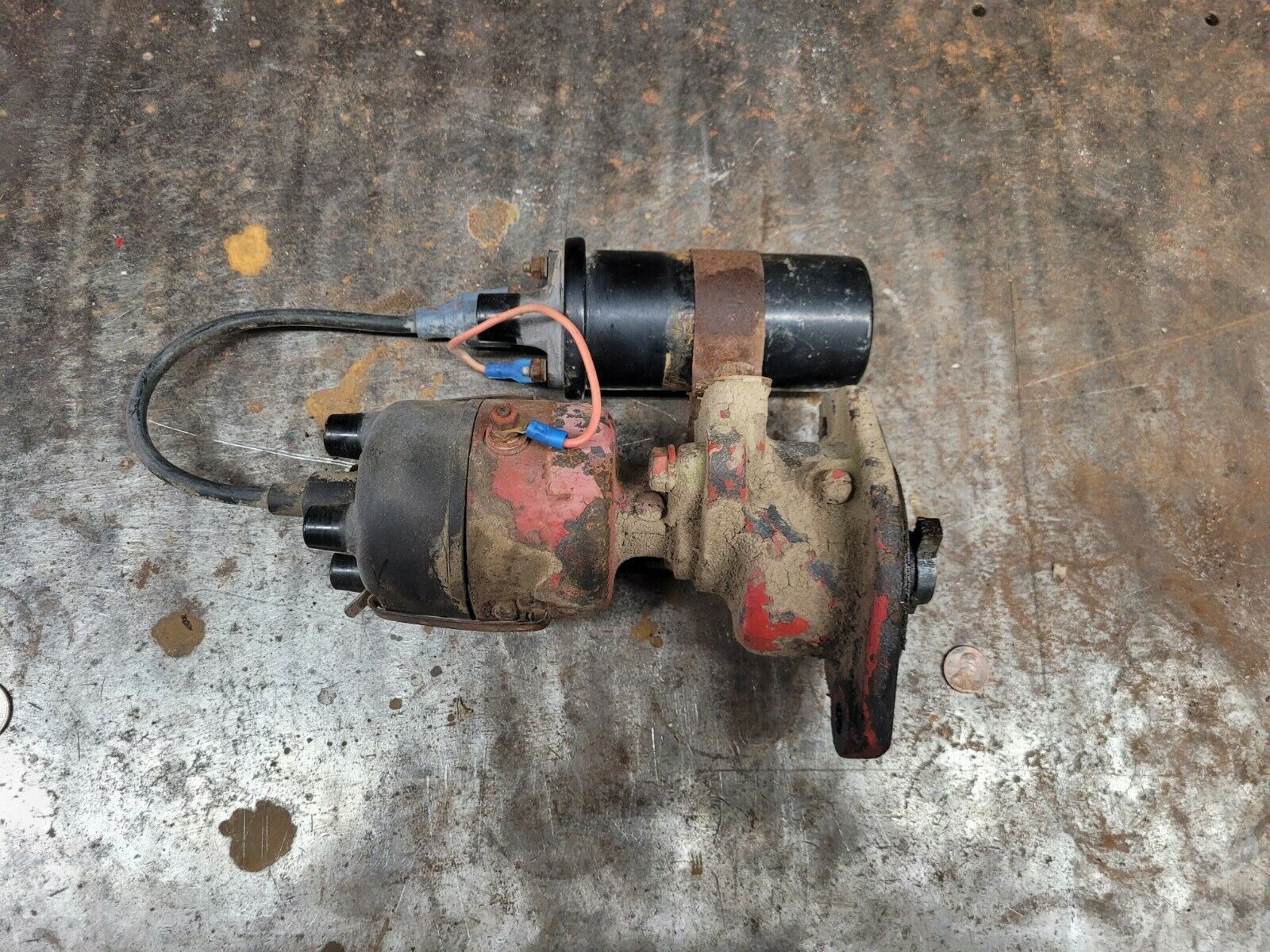

    This distributor would work well with that. it has an internal gear reduction that drops the distributor to half speed.
    Farmall Super C SC IH tractor

    Yes my father gave me one of those. I was going to look to see if there is an adv ***embly in it and it seemed like a step backwards.
    I should google about the adv.
    But to be honest, I do not need to change the tach drive Mallory I have been using for the last 18 years.
    JOHN, THANK YOU, I see the error of my thinking, in my head the I envisioned a TDC at every 90 degrees, but it is 180.

    your welcome, like I said, this has been tried before...
    You should hear some of the conversations when talking about changing to the Winfield 2up 2 down crank, and then reverse the cam or change the port layouts...
    Keep at it, when you get something unique working it's fun, J

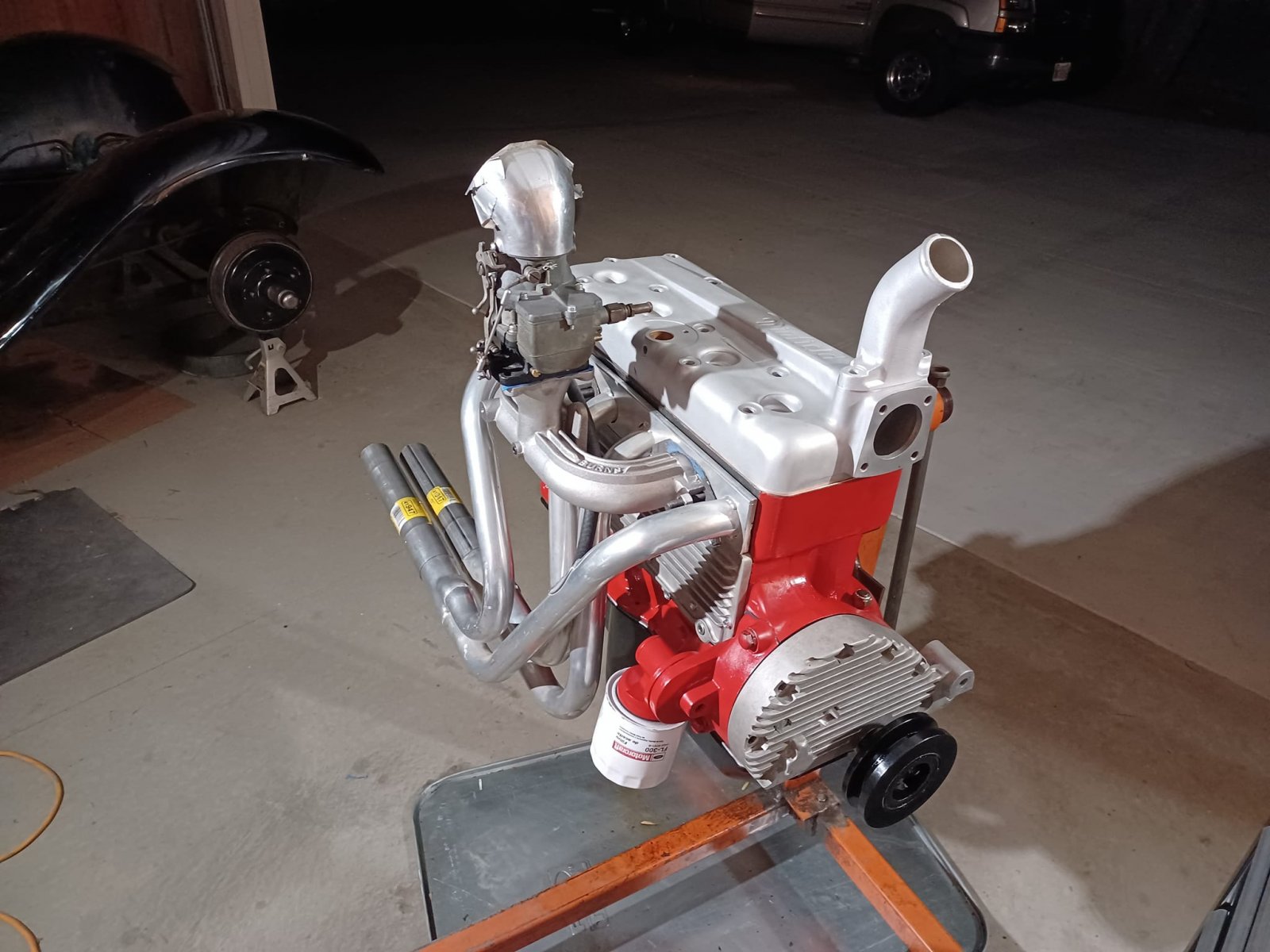

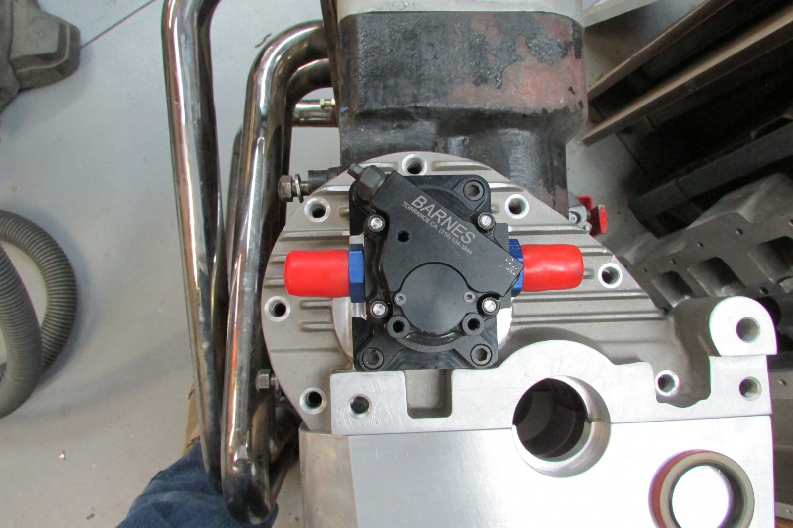

    Thrashing to get ready for the Antique Nats.

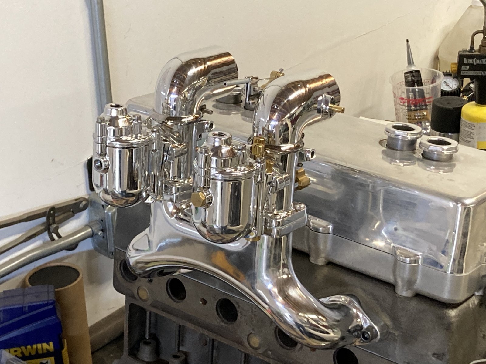

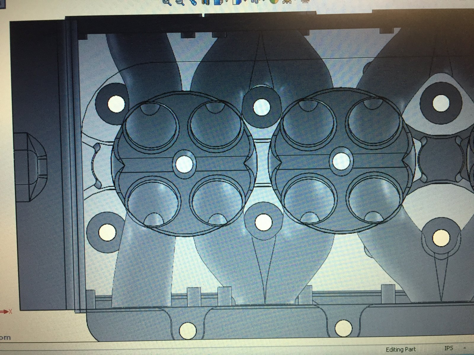

    I’ve always had a thing for the Fronty Stagger Valve head myself. I started modeling up the head several years ago... but don’t have any A bangers to put it on:rolleyes:
  22. Kevin
    Oh yeah obsessions
    That Fronty will keep you busy and the carbs are killer
    J
    I am taking a break after the 16 valve motor

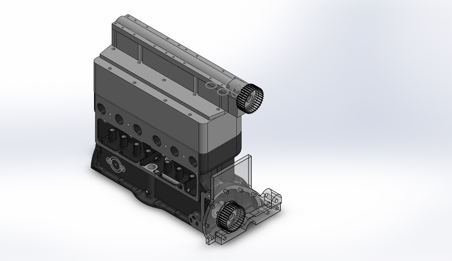

    Any banger with intake and exhaust manifolds on both sides... is friggin awesome in my book!
    A friend dug up a Gemsa produced Stagger Valve raw casting set several years ago, and I made up this model to ***ist with the machining. I don’t much care for the dual siamese intake ports, and figure if I ever followed thru with making my own, I would rearrange the intake ports so that each intake manifold only fed 2 cylinders. The intake porting would probably be a bit sloppy to one of the valves in each cylinder pair, but it would allow the motor to breath like a 4 port instead of a 2 port!
    Who knows if I’ll ever do something with it... but as long as I have the model, I can always have a 3D printed sand casting made up. Hell, it might be worth the money just to have it hanging on the wall...:cool:

  25. Yeah, a wall hanger might be nice or build for a nostalgia type car.
    The attempts at making HP for the time are very ingenious, but some better than others.
    Have you ever noticed that internal combustion engines were originally just modifications of external combustion engines? The original DOHC design was built in 1912, had success but was too costly to build as a production engine, hence the steam engine designs.
    Struggling to get .25 HP/cu in displacement was difficult.
    Move up to the 60's and 70's where 1.2 to 1.5 hp/cu in, now, even without manifold compression 2.0
    This is fun, stops me from wasting money on booze and Ladies of the night.

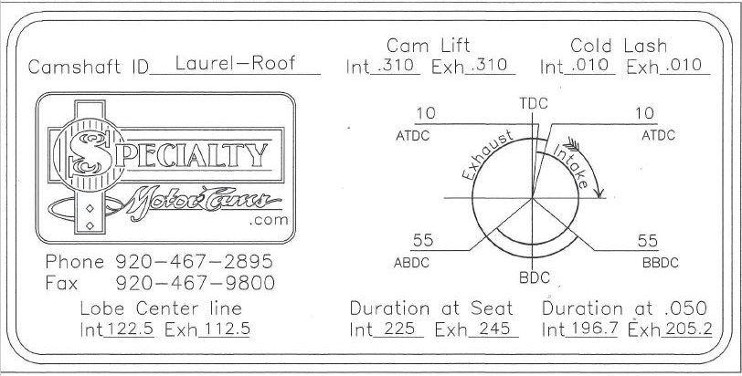

    Id like to know more about this. I have probably a less than ideal cam in my T so I'd like to know any information on secrets of unlocking some power.

    Anyone else remember when Harvey Crane Jr. was doing custom cam design...? He designed the profile I run in my T speedster, and it’s fantastic for a flat head! Good idle , good low end torque, and happily pulls to 4K. The head measures at 7.25:1, but makes about 180 psi on a gage. The cam would probably be happier with a 6:1 compression flathead, or the same with overhead valves.
    My specs are very similar to your Laurel grind above
    .300 lift
    209/208 duration @ .050”
    241/245 duration @ seat
    14/60 open/close
    115 lobe centerline
    I had to retard the cam 5 degrees and tighten up the lash to combat detonation issues by bleeding off some compression. This puts the open close numbers right at your 10/55, but increases the duration to 213/212. I don’t like the cam as much with the 5 degrees of retard as it kinda runs like a tractor now... it still pulls to 3500, but I have to push it, and not nearly as snappy. It’s probably for the best as I run the stock T trans and Ruxtell rear end...

    When Mike Bender did all my machine work, his advise was install the cam straight up. But I know others may have opinions that vary. I am running 7.5:1 in my engine also. I cloned the whole combination around someone else's hill climb car that ran this exact combination at one point.
