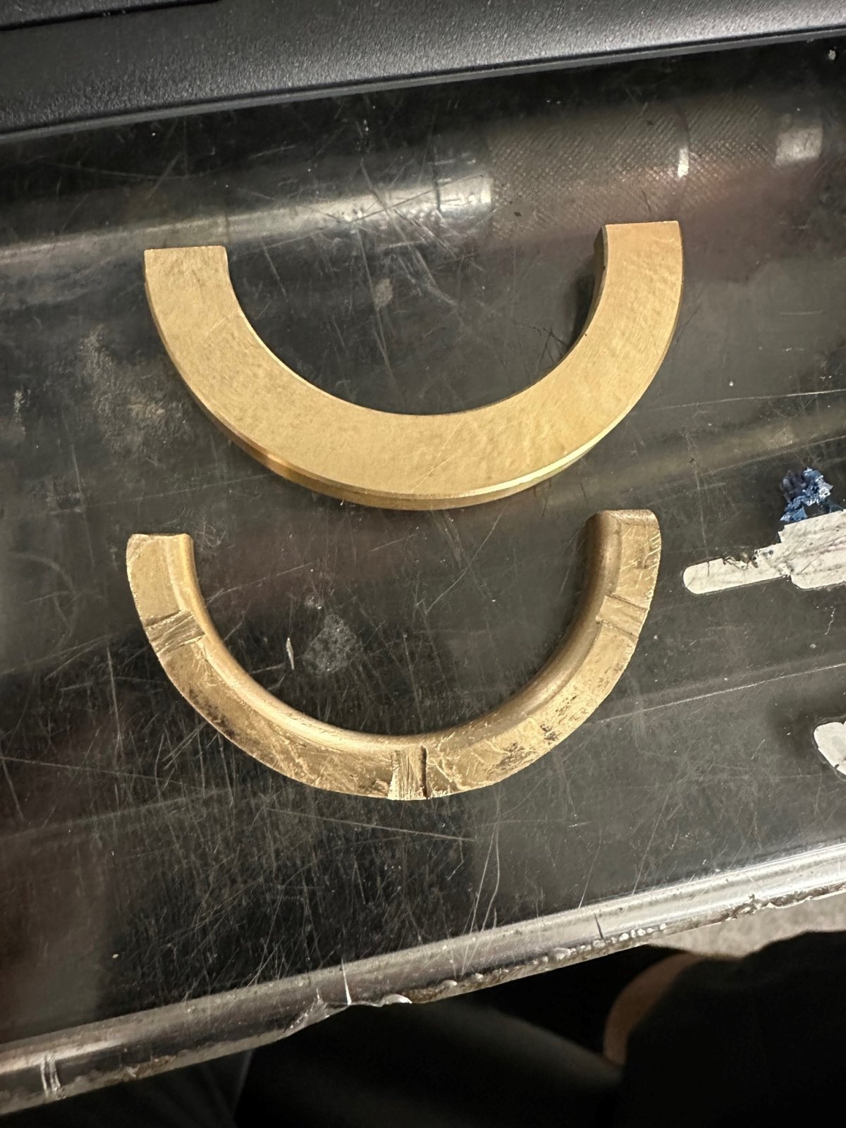

    Had to machine down the new B thrust washer, added some oil grooves to it and chamfered the leading edge to hopefully not wipe the oil film.
    Top one is the stock one for the B motor that they are selling.

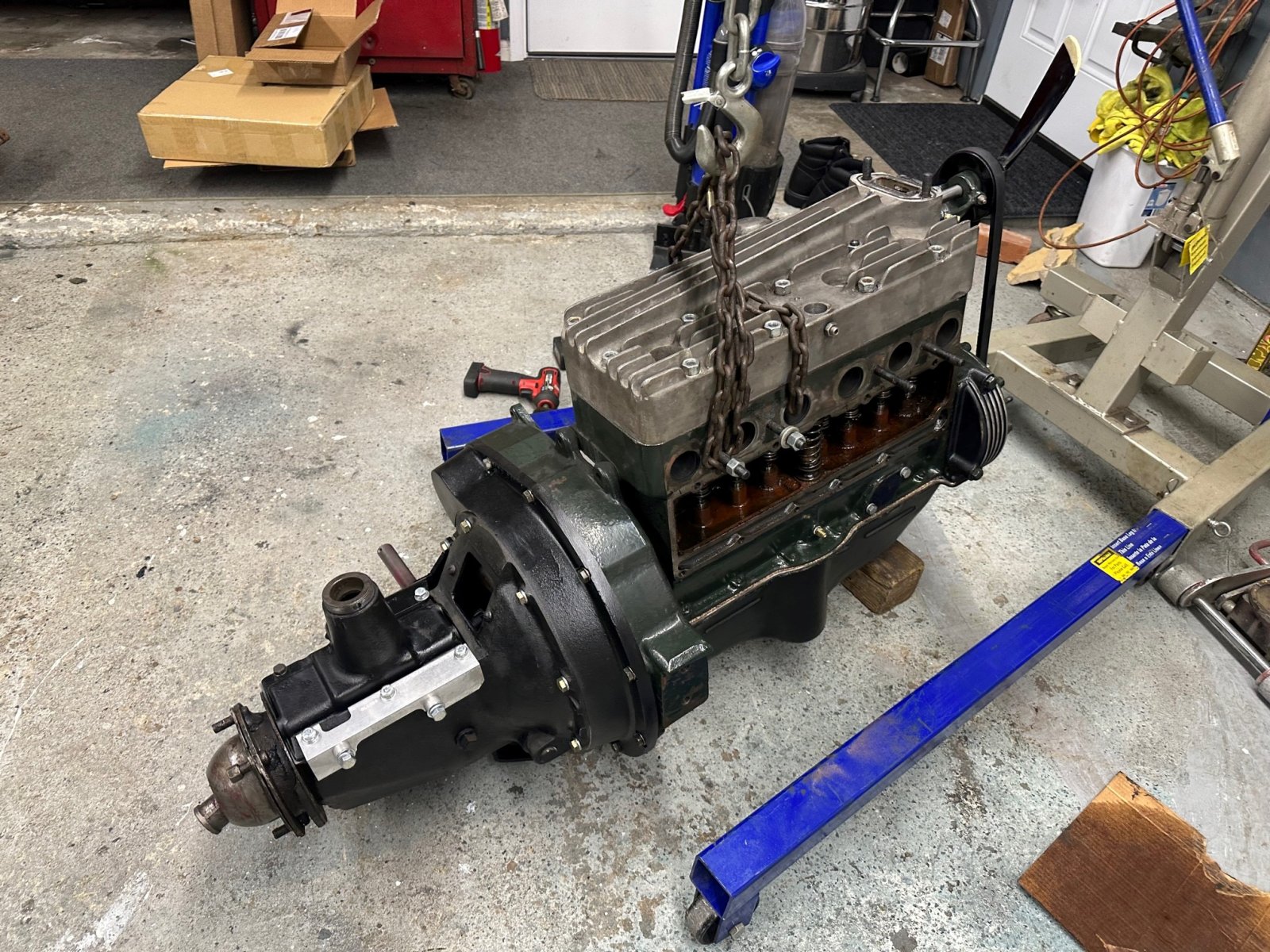

    Here we are with the 34 trans rebuilt, clings adapter etc...
    And installed on the mounts and torque tube attached in 20 min.

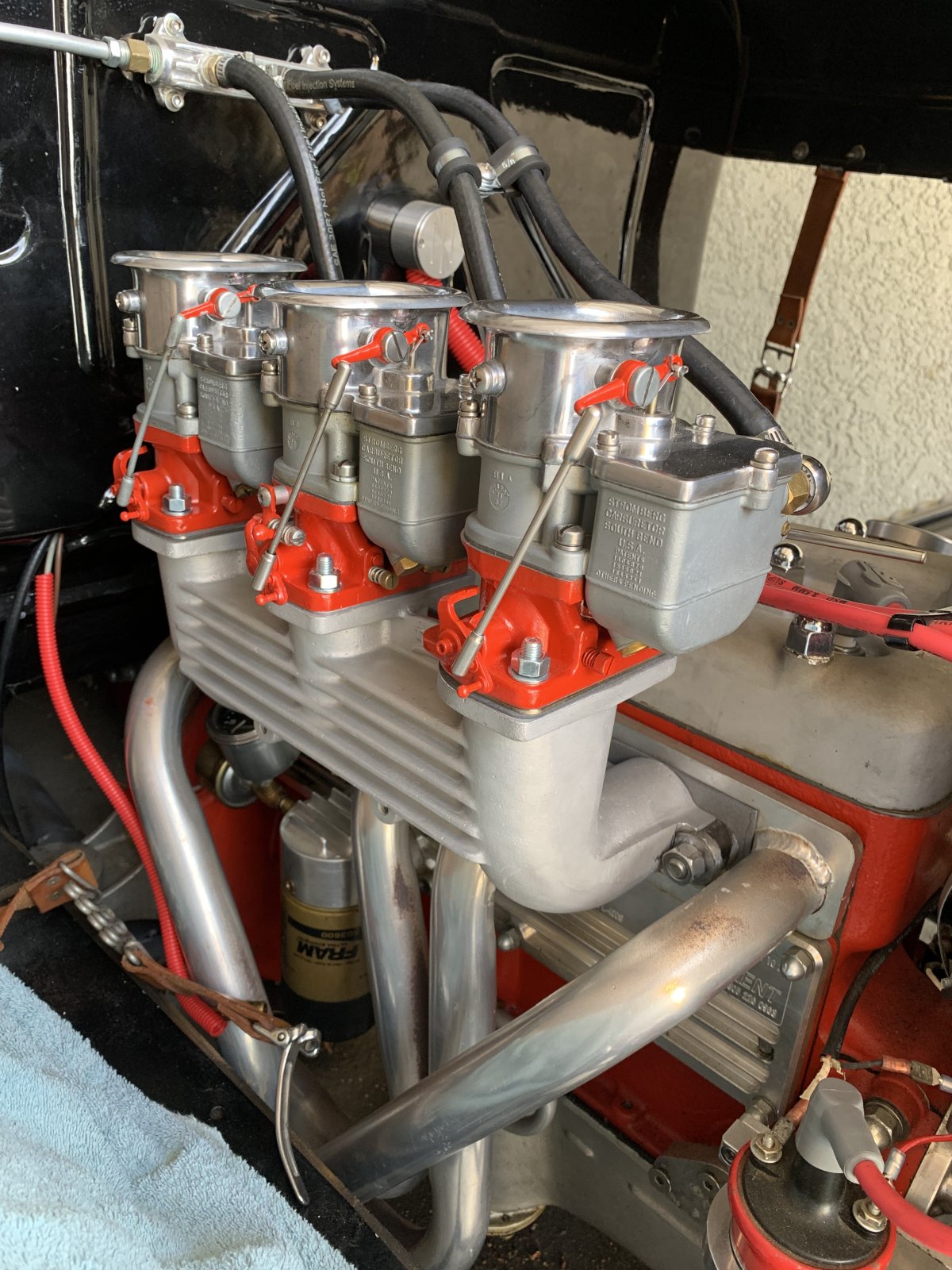

    I scored this Zenith today, up draft, dual 1 3/16" throats, it's frozen up but will look at freeing it up, I just think it will end up on my banger IMG_20230404_173615321.jpg IMG_20230404_173558930.jpg IMG_20230404_173542133.jpg
