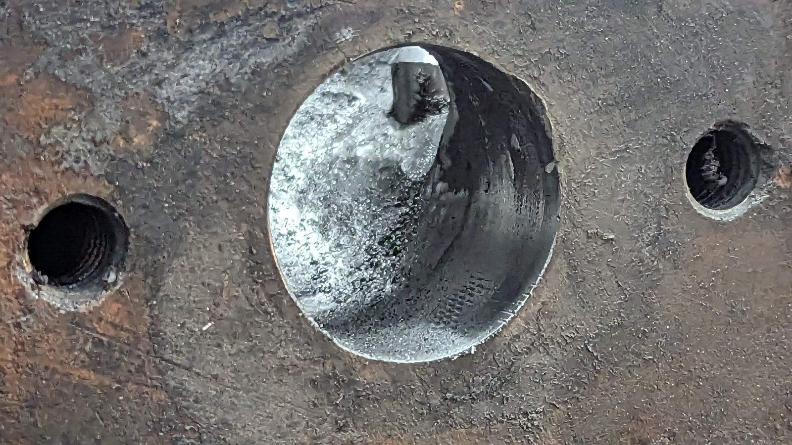

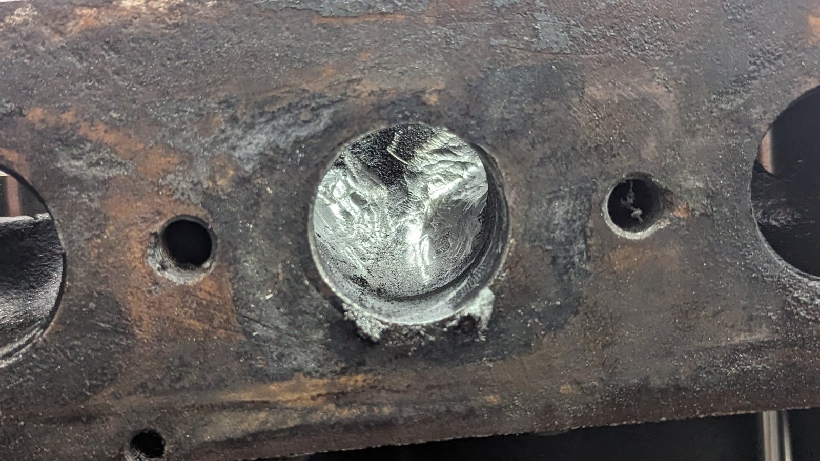

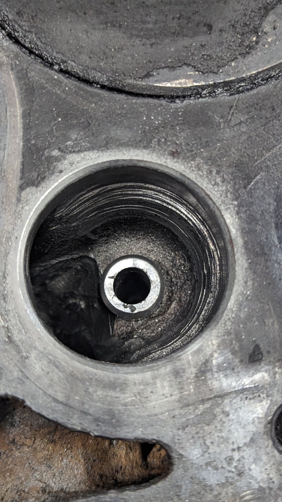

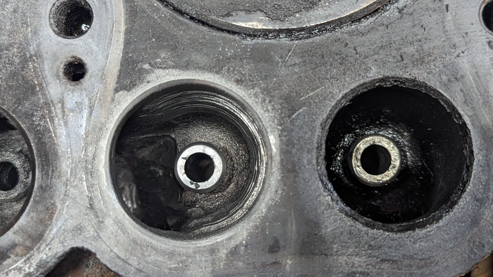

    Here's some pictures of my work on the first intake port. Still needs a bit more cleanup and some more valve seat work. Any thoughts/suggestions? Is there any real benefit in porting the exhaust? I am assuming that the intake is going to be by far the major restriction, with siamesed intakes and (stock) the same port and valve size as the exhaust. PXL_20230412_053803181.jpg PXL_20230412_053817448.jpg PXL_20230412_053824510.jpg PXL_20230412_053854580.jpg PXL_20230412_053904614.jpg

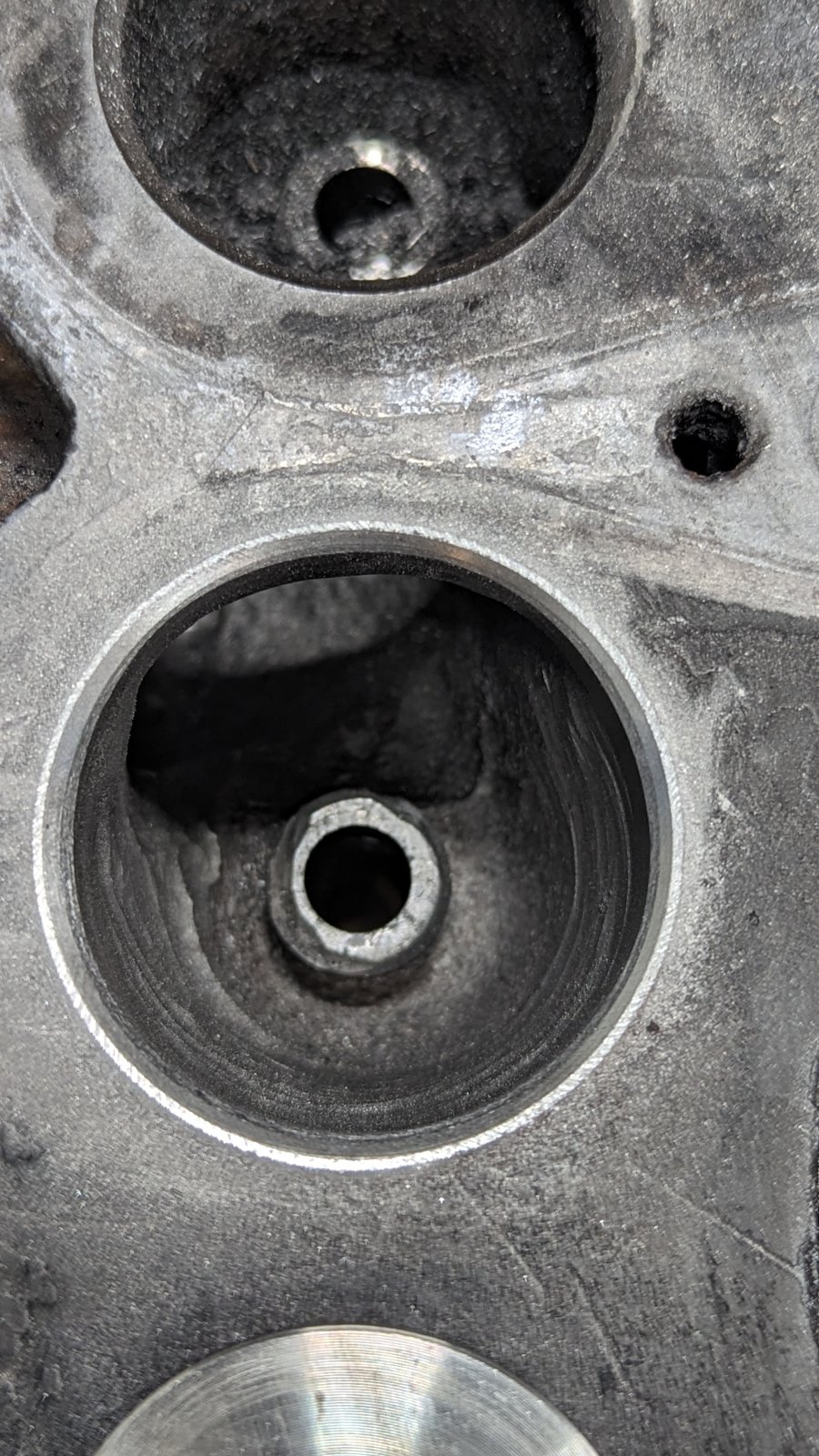

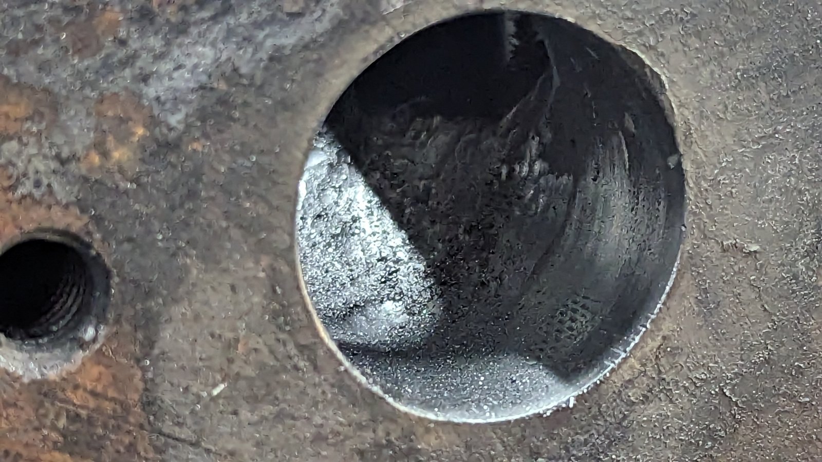

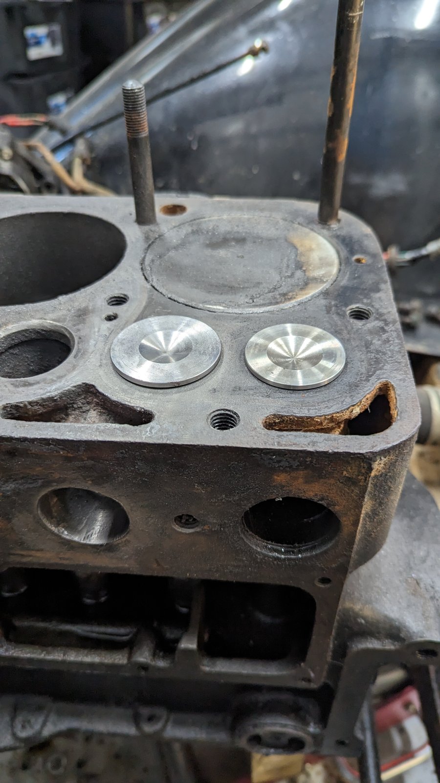

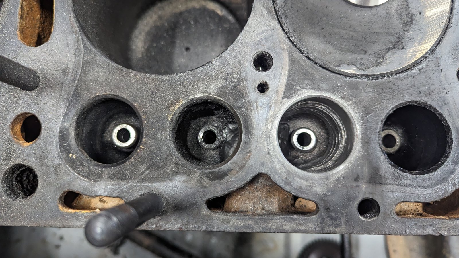

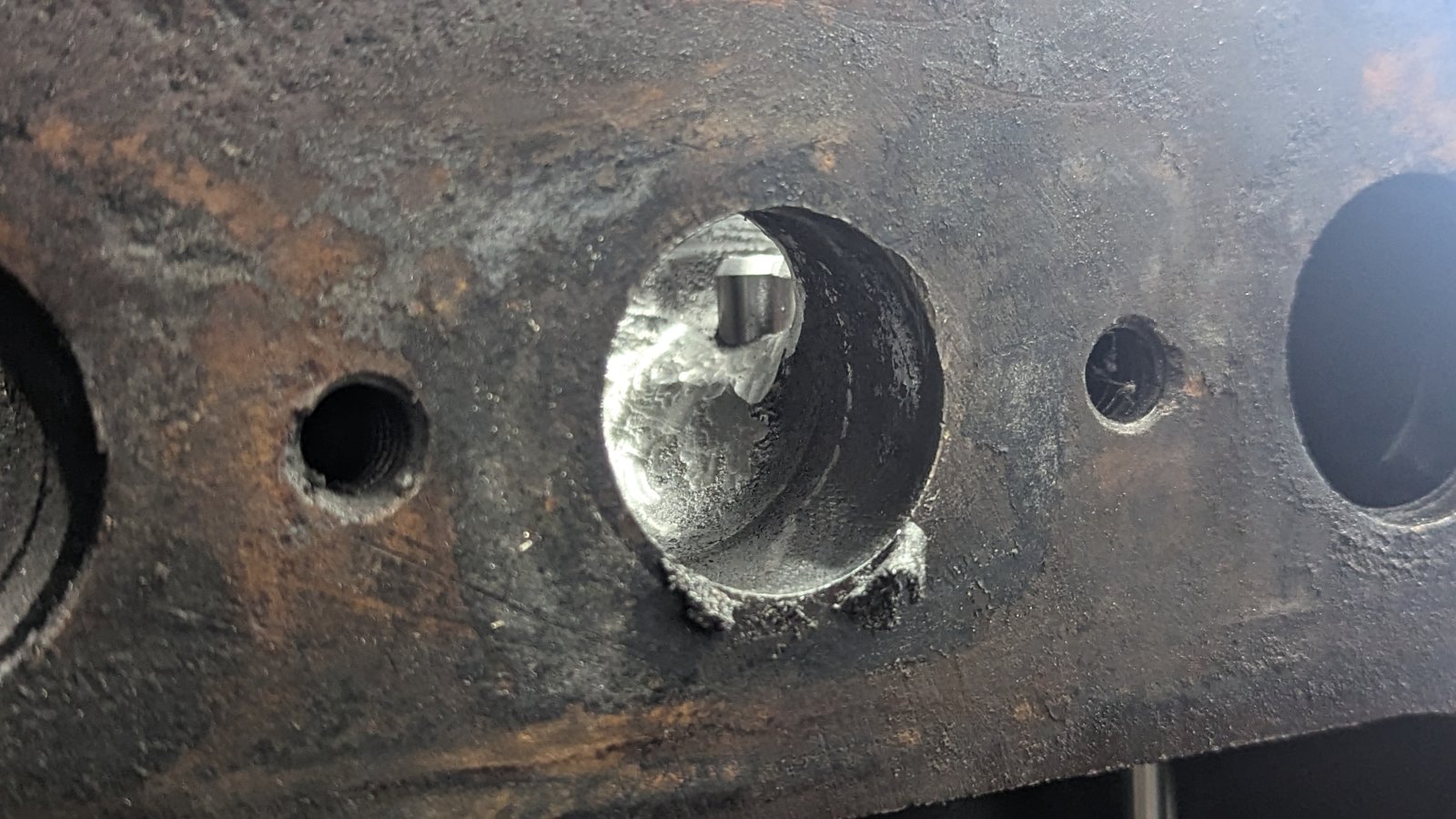

    The finished number 1 intake, unless someone can tell me what to improve? Please keep in mind that I have no idea what I'm doing, all ideas and advice accepted! While I've read plenty about it, I've not even ported a cylinder head before. I'm really just trying to smooth out the port and open it up for the larger valve. Surely I'm not in uncharted territory here? I feel like the port would probably work better with the short side straightened a bit, but I'm concerned about the proximity of the water jacket, and I know you normally stay away from the equivalent area on a cylinder head! But I feel like it's a bit different with the angles here. Anyone have any pointers?
    PXL_20230412_071720216.jpg PXL_20230412_071734509.jpg PXL_20230412_071750017.jpg PXL_20230412_071808599.jpg

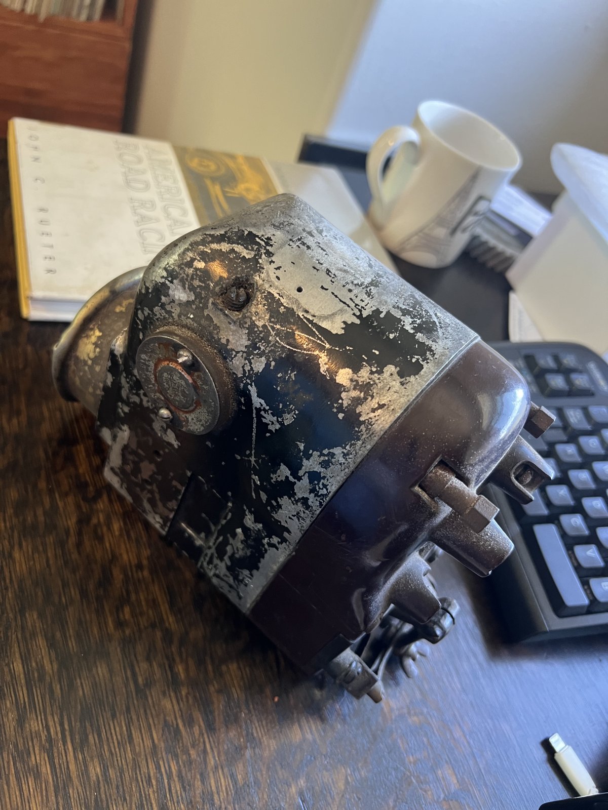

  12. Sent my mag off to be rebuilt for the model T, been kind of a pain in the ass to find a clockwise rotation, mechanical advance, four-cylinder mag with an impulse. Mag Guy calls me up, and says in 20 years of rebuilding mags he's never seen something quite like this, the guts to the mag are completely custom. He calls his buddy who's been building mags even longer to ask for help on what I sent him. There were to giveaways on the exterior that it was something odd, custom bolts, instead of screws, holding plug wire plate, and the plate to set the mechanical advance. Inside the mag, all the serial numbers were completely different from what he was used to seeing. Turns out it's for a Sherman tank, they ran dual four-cylinder magnetos on each of the V8 Cadillac engines. So, neat mag to sit on the shelf, but there's no way you would want to run this on a speedster.

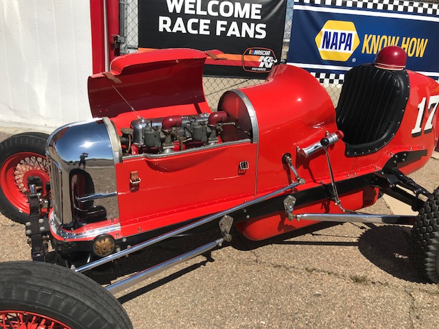

    We recently tore down the engine of our flat Tail Race Car to freshen it up, and check things over. Today, we started the engine, it ran fine, lot of compression noticeable when starting, good oil pressure (driven from cam gear) very responsive, but I now have a greater appreciation for the brave soles that drove these machines. My left arm is exhausted trying to keep fuel pumped to the carburetor. Best news…no leaks when it was shut down! I’m sure this car is glad to be back amongst the living.
    Oops, couldn’t load the video, but this is the car.

    Thanks! I don't have any broken head studs though, I just removed some of them? I had huge difficulty getting them out 12 months ago when I first pulled the stock head, but with lots of heat, penetrating fluid, and double nutting them I eventually got them all out intact (which was the only way I could get the head off as it was rusted solid to them).
    I've really been looking for some advice on what others have found effective when porting out the block, but I guess it's a secret!

    Here are a couple pages from an older document in which porting on the block is discussed.

    Thankyou so much! That's awesome... And luckily enough lines up very well with exactly what I've done so far. I really hadn't found anything after a lot of searching, but I knew I couldn't be covering new ground. Out of interest, I don't suppose you have the rest of that document...? Looks like it would be worthwhile reading.

    I wouldn’t suggest any more than a simple blend and polish on any block that has had any machine work or babbit work done already. There is not much material around the ports and if you burn thru… it’s scrap! The stock port size is sufficient to support a really strong running engine. The larger valves will no doubt provide a far more noticeable improvement than porting for most motors

    Thanks! Yeh I'm cautious about that. The shape around the valve guide was pretty horrendous, and that's obviously a solid part, so I did a fair bit of reshaping there. I think the bigger valves and opening up the throat should make a big difference too - there's a nasty crevice under the deck that I would think would be terrible for intake flow (I'd think it doesn't matter as much on exhaust, it's huge anyway, and maybe would help stop reversion?) - that is removed when opening the throat for the bigger valves. But again... I'm no expert at all, just going by what I see and my limited understanding and research. That's why I'm looking for any and all input. Thanks!

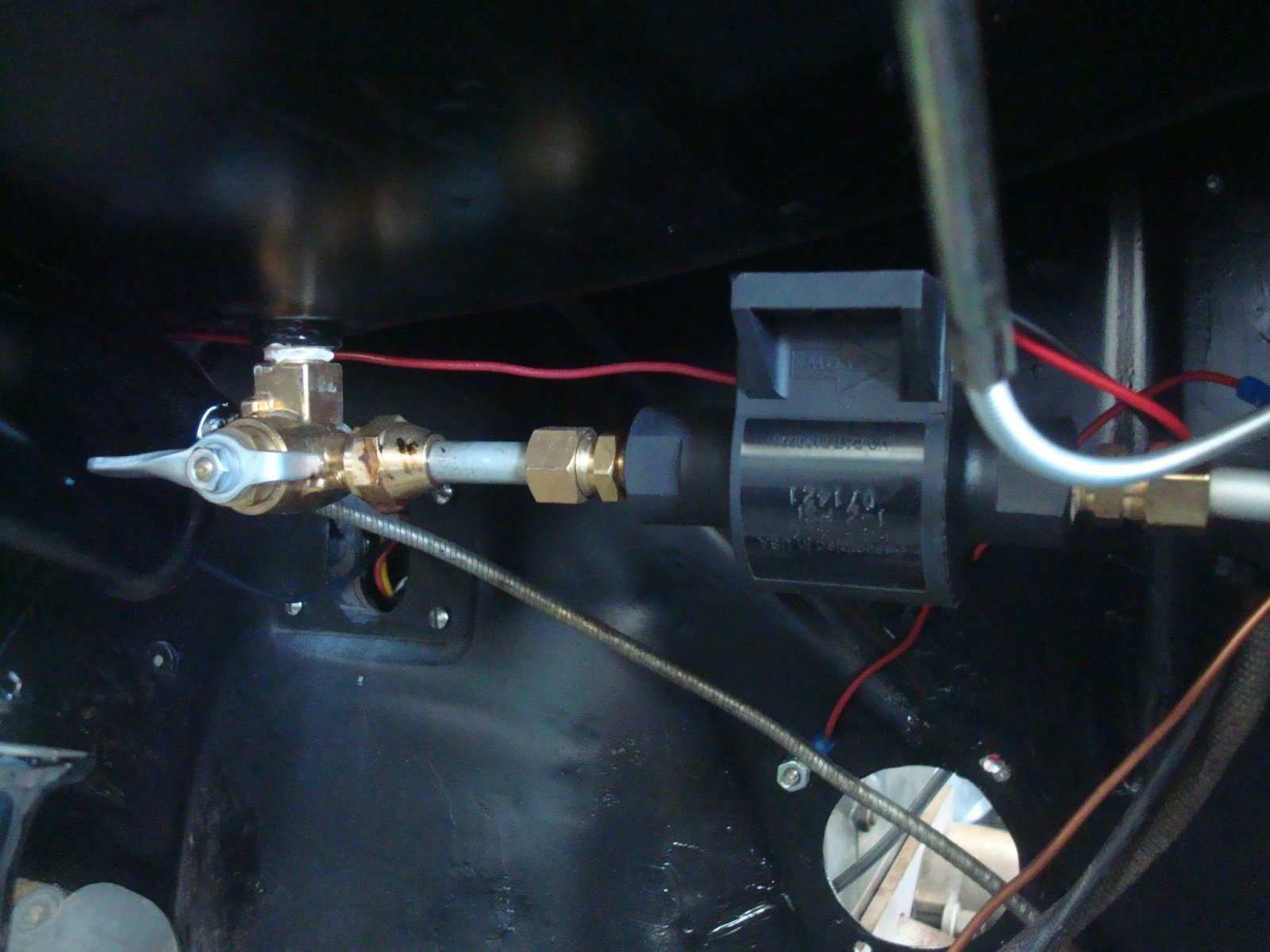

    Who is RKE? I would install this. The inclusive all in one unit certainly meets all criteria, especially with the built in regulator. I am currently running a supposedly 1.5 lb pump under the dash/tank and I hate the sound inside the cab. Is the RKE unit noisey, at least it is outside. I think it looks great and has no negative impact on a banger already running a FSI distributor and a 97.

    Thanks hotrodfil, I have sent a query to RKE.
