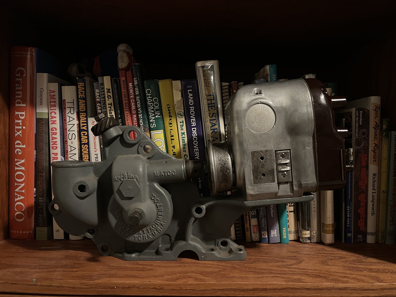

  6. Little progress. Now to ream or hone the bushing in the cross drive. Rebuilder made it "friction" fit.

    That’s an interesting variation of the MATCO drive plate as it doesn’t have the typical higher oil filler neck and oil tube to the shaft bushing. What’s your plan for connecting the impulse coupling to the “rubber hose” connection on the drive shaft…?
    I ran a MATCO on my ol roadster without an impulse and had no issues. Was even able to hand crank on occasion. Watch the gear mesh when ***embling the front plate to the motor, I wound up with sumpin like 3 extra pan gaskets under the timing cover to get the gears to mesh correctly
    Jet96 and Outback like this.
  8. Never thought about the plate variances, you're right, usually they they have the tall filler. Thanks for the heads up on the gaskets, I'll make sure to order a few extra.
    The gentleman who rebuilt the mag seemed to think he'd be able to make a micarta coupling, if he didn't have something bolt on.
    How did you handle the timing? Were you able to fine tune through the mag connection?

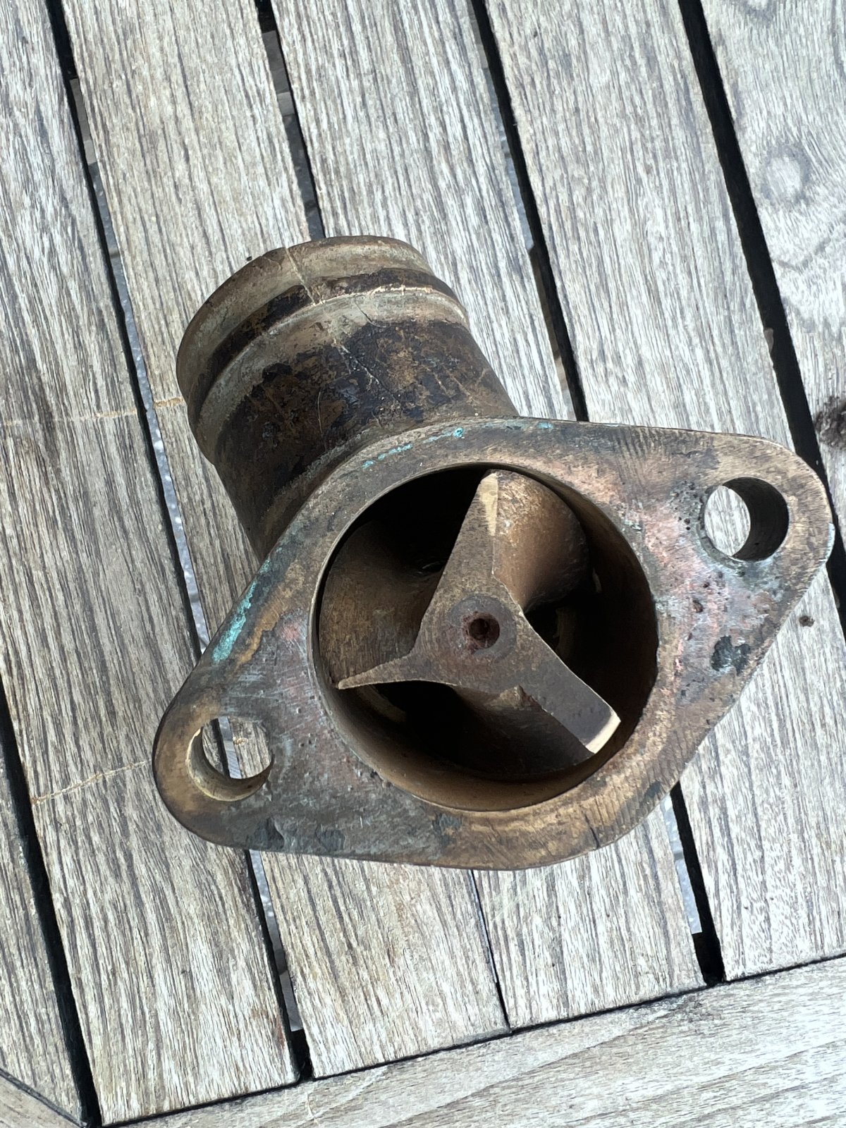

    Finally got a "decent" looking head mounted water pump. All br***, actual impeller. Clearances could be tighter, but it is a start.

    The taller filler neck had a built in baffle that acted as an oil reservoir and would be filled while adding oil to the engine. You can see the baffle and oil puddle in my pic above. Does yours have a grease fitting for the bushing…?
    Your plate has the typical MATCO drive shaft in it. Basically it used a piece of 1” ID rubber hose to connect the drive shaft to the mag. The drive shaft end uses a 1/4” screw and nut holding the hose rigid, and the mag end used a cast bronze hose clamp to hold the hose to a 1” diameter hub mounted to the tapered shaft.
    I ordered a length of straight radiator hose from the local auto parts house, and machined my own hose clamp and mag hub. I’ll see if I still have the hub and hose clamp designs laying around…

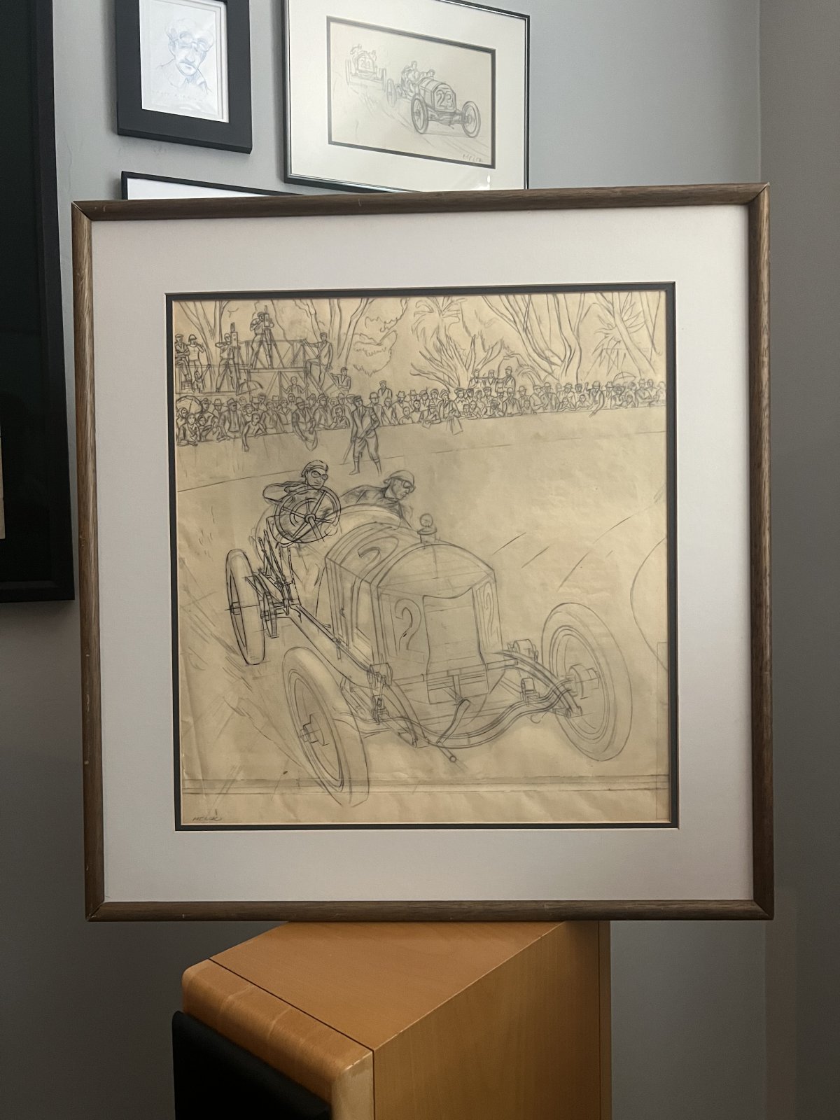

  10. If hunting for Winfield intakes takes time, waiting for original art work to pop up, is equally a roll of the dice...the sketch looks like a study for the final.

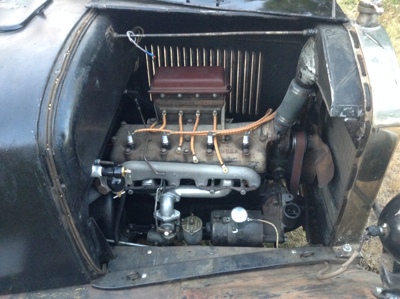

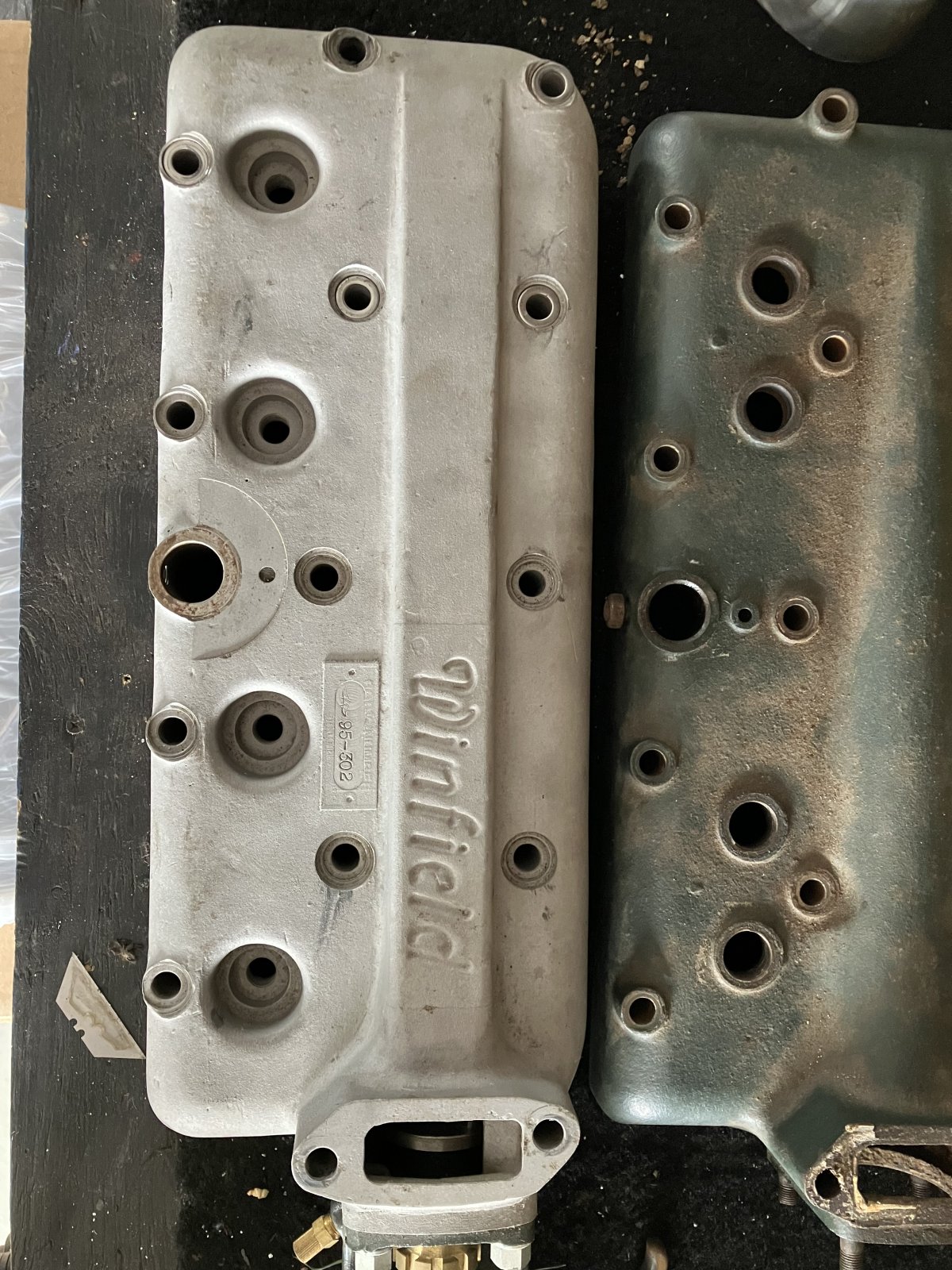

    Had some good luck today.
    Picked up an aluminum Winfield for a fair price.
    I haven’t seen any being sold for a while. Decided to buy and maybe sell the Lion I have to offset the cost.
    Looks pretty decent. Anybody have a guess on details or own one and care to give an opinion?
    EDIT: looks like the “flying A” means it’s was made by(for?) Specialty Ford Parts from Rosemead CA.

  15. Hitchhiker
    Joined: May 1, 2008
    Posts: 8,507
    Hitchhiker
    Older reproduction.

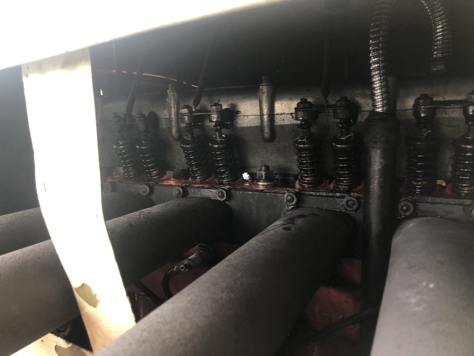

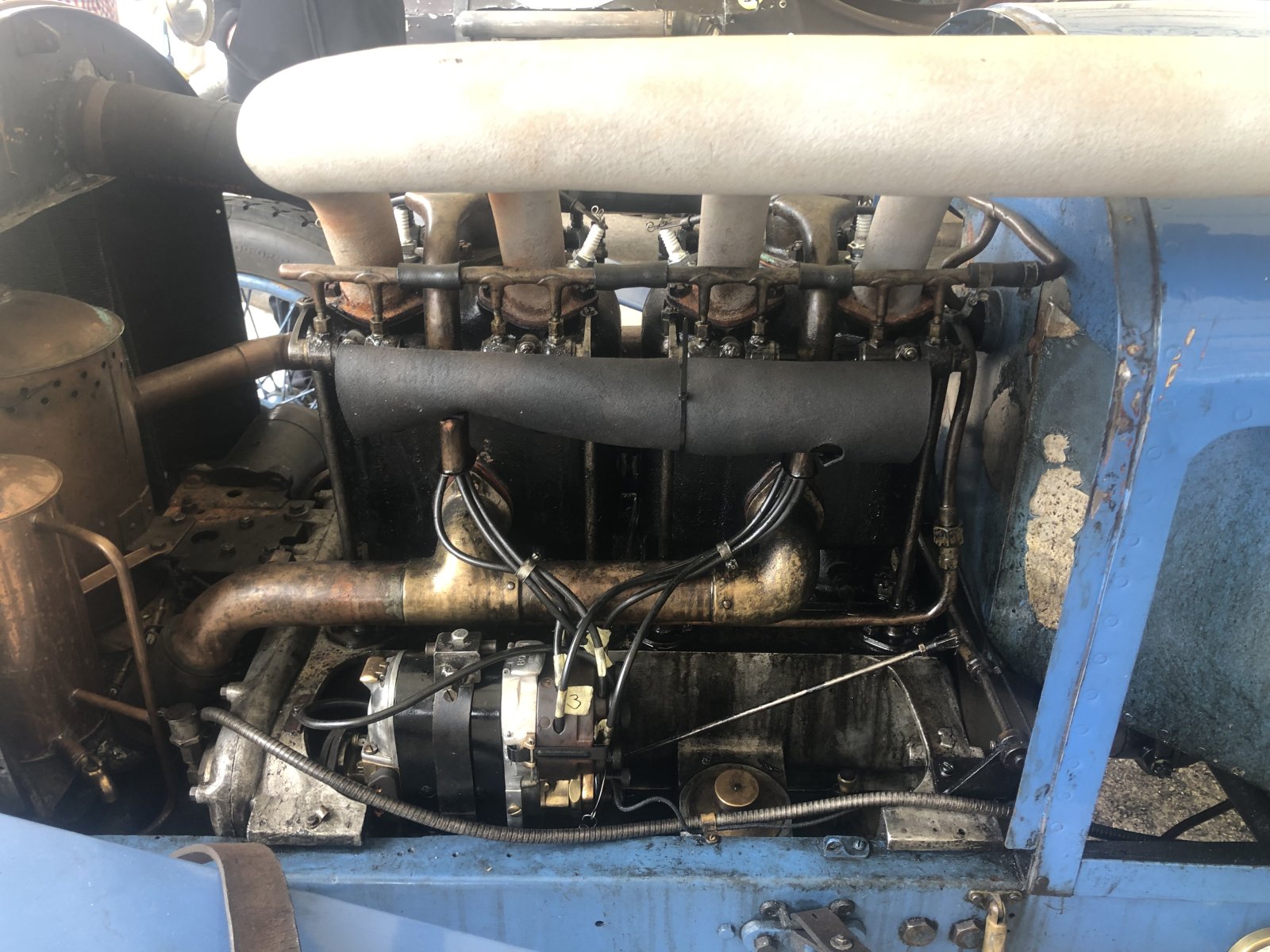

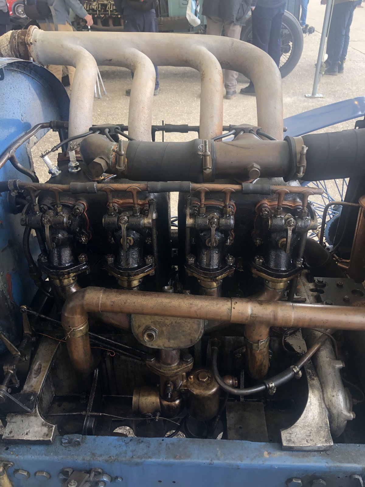

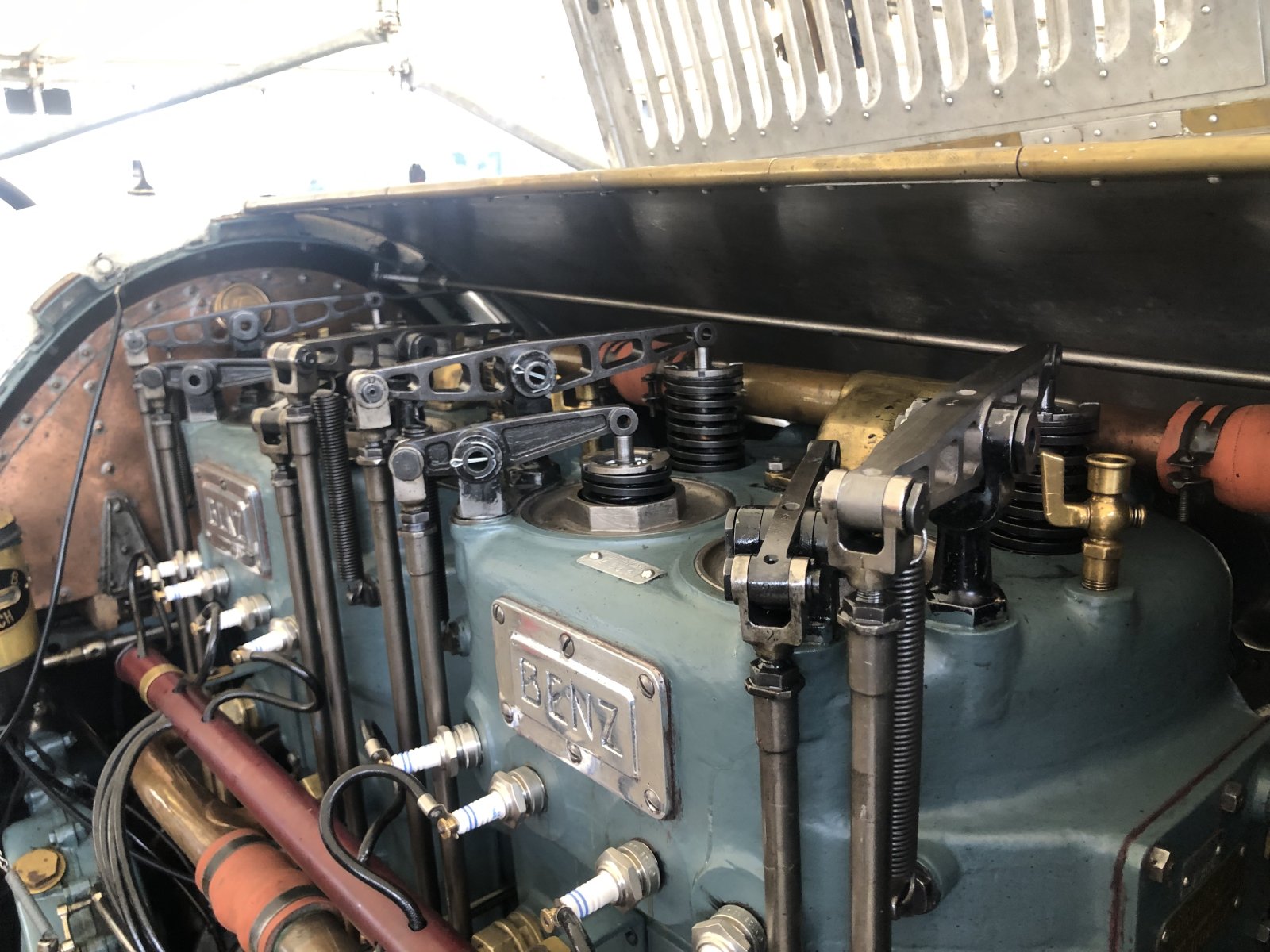

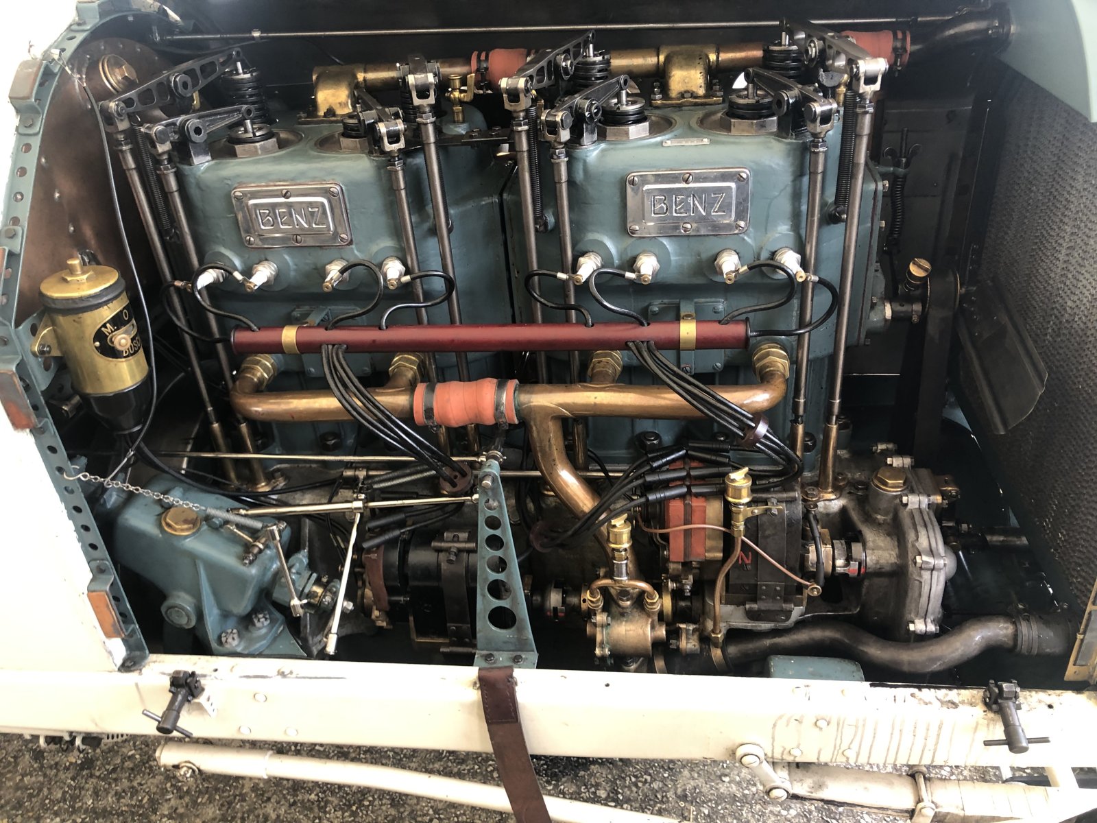

  21. Went to the Goodwood Members Meeting yesterday. Plenty to see and watch. Didn’t take too many pictures but couldn’t resist a few shots of four bangers in the Edwardian pits.
    Single overhead cam 16v T engine.
    Benz overhead.
    D7FF4053-8AC3-4BC8-8ABA-8CBC7AE79573.jpeg 32F21432-8A4F-4A44-A961-6BB4BD97BDDB.jpeg 6DF80AC8-6368-4429-8DEF-F00339068F32.jpeg 5F7A66BC-4794-4BBC-86A2-4F75BB40E24E.jpeg

    Beautiful engine pics!! The single stick T is a Craig Hunt (later became Speedway) head. I got to look one over year several years ago and was amazed at the simplicity of the design. Was surprised to find there is a standard T cam and forked rockers under there…
    Would love to more about the other exotic motors!

    Nice! I had an original Peter Helck work sketch that I parted with years ago, the painting of the Simplex pitting at night. Wish I could have kept it, along with a lot of things. Has your new speedster project arrived?

  26. Follow a couple of the owners on IG, asked one of the Benz gentleman what their speeds were, he said through the second timing point (where ever that is) he was hitting 90. He also said that Julian Mazjub in the Indy Sunbeam was going 97 and Mark Walker in the Darracq was doing 96 mph. Definitely moving along!
