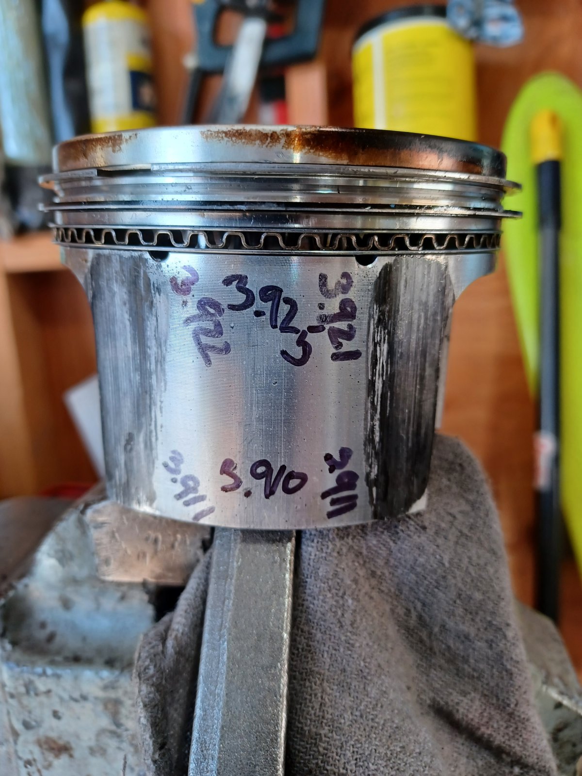

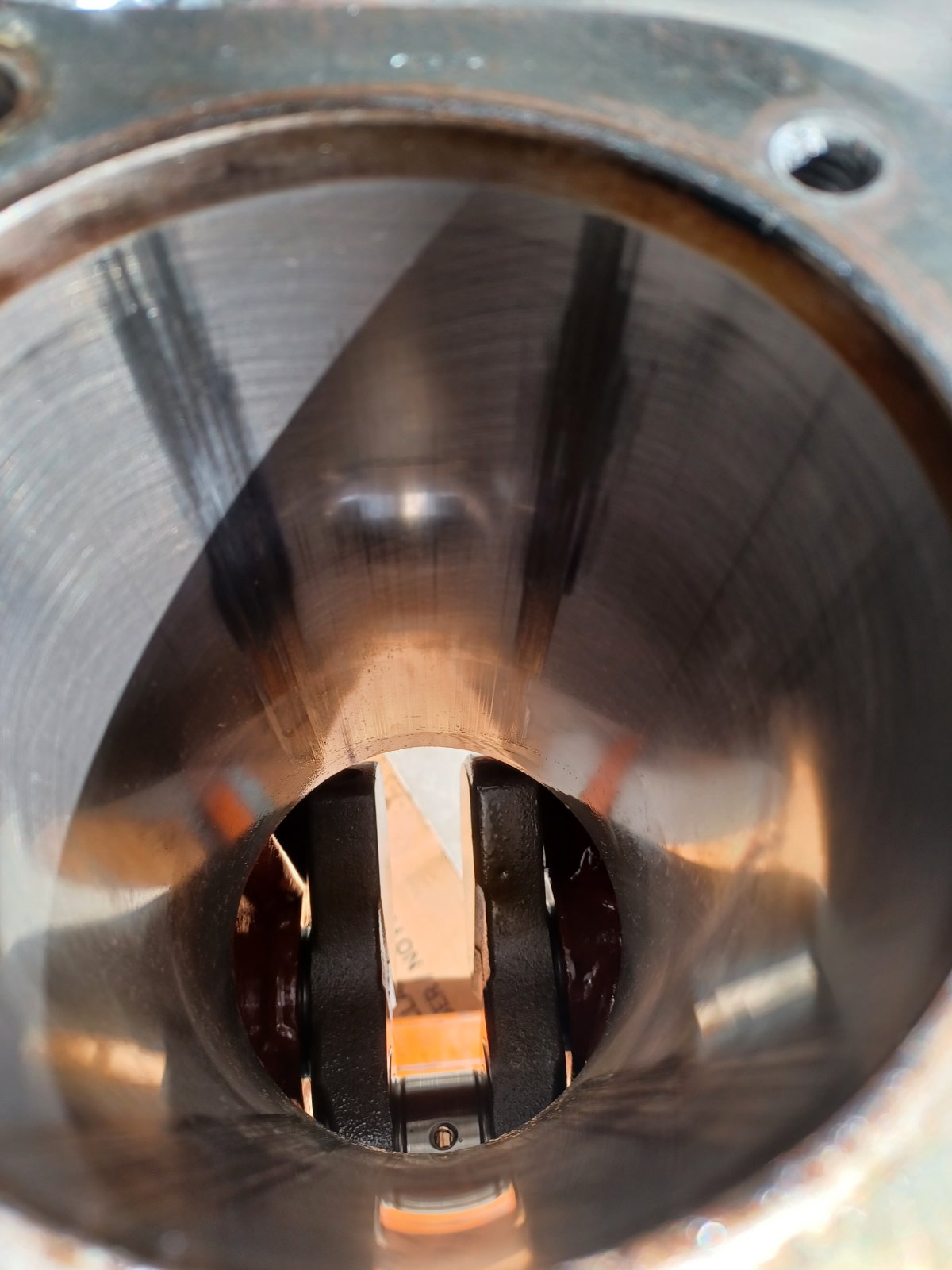

    Mine is back out. #1piston issue. @ 250 miles

    I was on a drive Easter Sunday and was cruising @ 1600 rpm in 5th. (@60 mph), started up a grade and down shifted to 4th. Was running @ 2500 rpm and it started to "labor". Oil pressure was @ 35 psi. and engine temp was @ 155deg F. the power dropped off like it was binding up. Pushed in the clutch and pulled to the side of the road. Engine was idling fine. I sat for a few mins, oil pressure and temp were fine. Blipped the throttle a couple of times, put it in gear, and drove off. Drove it home and noticed a knock when I parked it. let it cool down, then checked the valve clearance. The valve lash was good. started it up and it was making a very loud knocking noise. Much worst then when I parked it. Thinking it was a rod knock, I pulled the engine. All the bearings are in good shape. All of the fasteners were still torqued to spec. This piston got hot and seized up a little. The scoring on the cylinder is material transfer from the piston. I have checked the bores, and all are the right size ( I had it bored .060" over). All the pistons measure good too, except the lower skirt on # 1 is @ .012" smaller then it should be. I think the knock is piston slap on #1 now that the skirt us not able to guide the piston.

    The clearance was in spec at ***embly. The piston got hot and transferred aluminum to the walls of the cylinder.
    I'm not sure of what caused the piston to get that hot, but it did. everything seems to be getting plenty of oil.
  8. Dan,
    It looks like the piston heated up and expanded along the internal area supporting the pin.
    And your measurement does in fact show the skirt smaller in OD than the areas touching, by a bunch.
    The area where your 3.910 dim is written should be the largest dia on the piston.
    Maybe the piston cam grind was off index? rotated 90 degs?
    Glad to hear the pump is working, 35 psi is nice, what oil?
    Nothing catastrophic, just a bum piston.
    Best, J

  9. Crazydaddyo
    Joined: Apr 6, 2008
    Posts: 3,374
    Crazydaddyo
    My thoughts also. I'm still investigating.

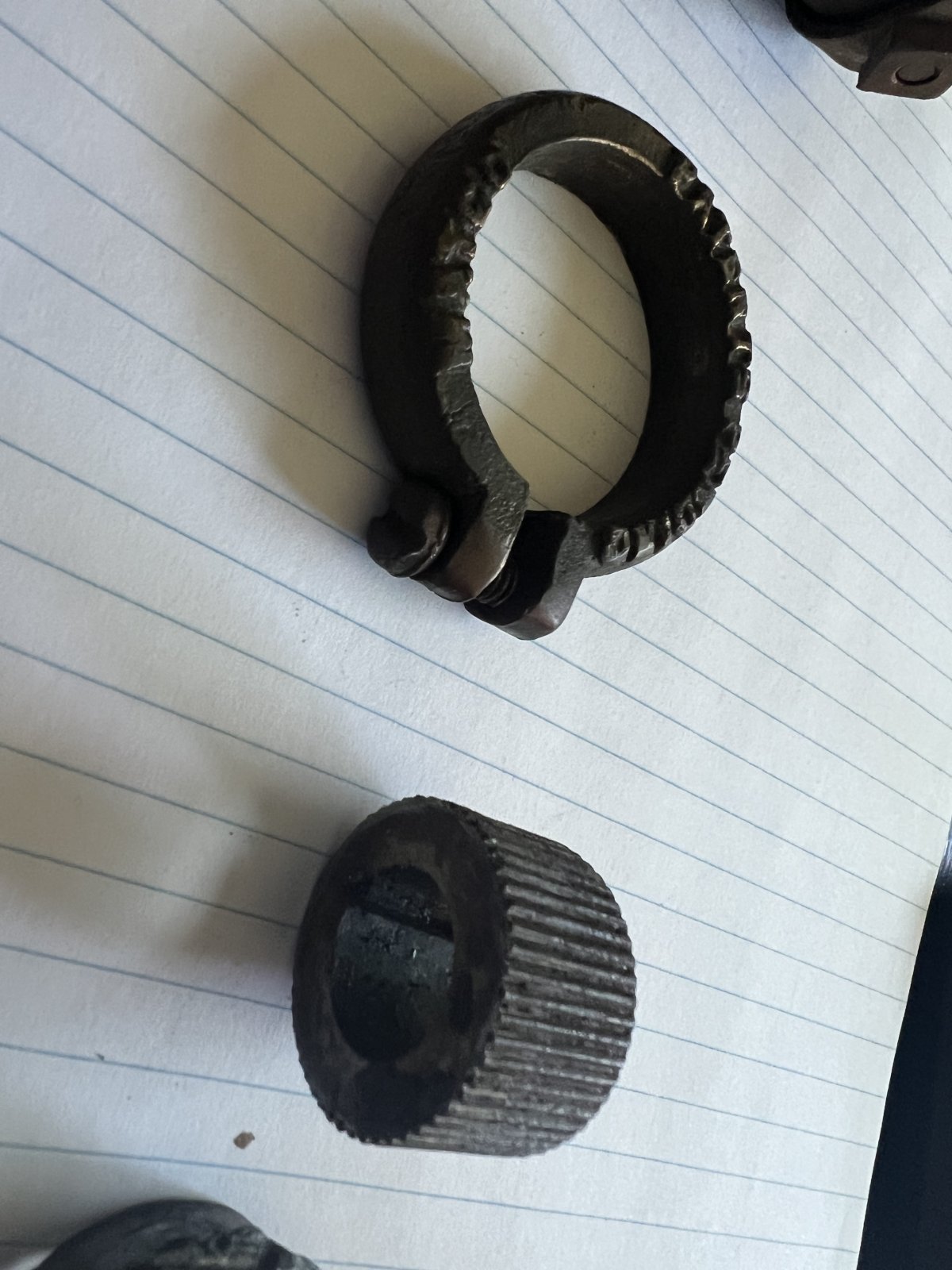

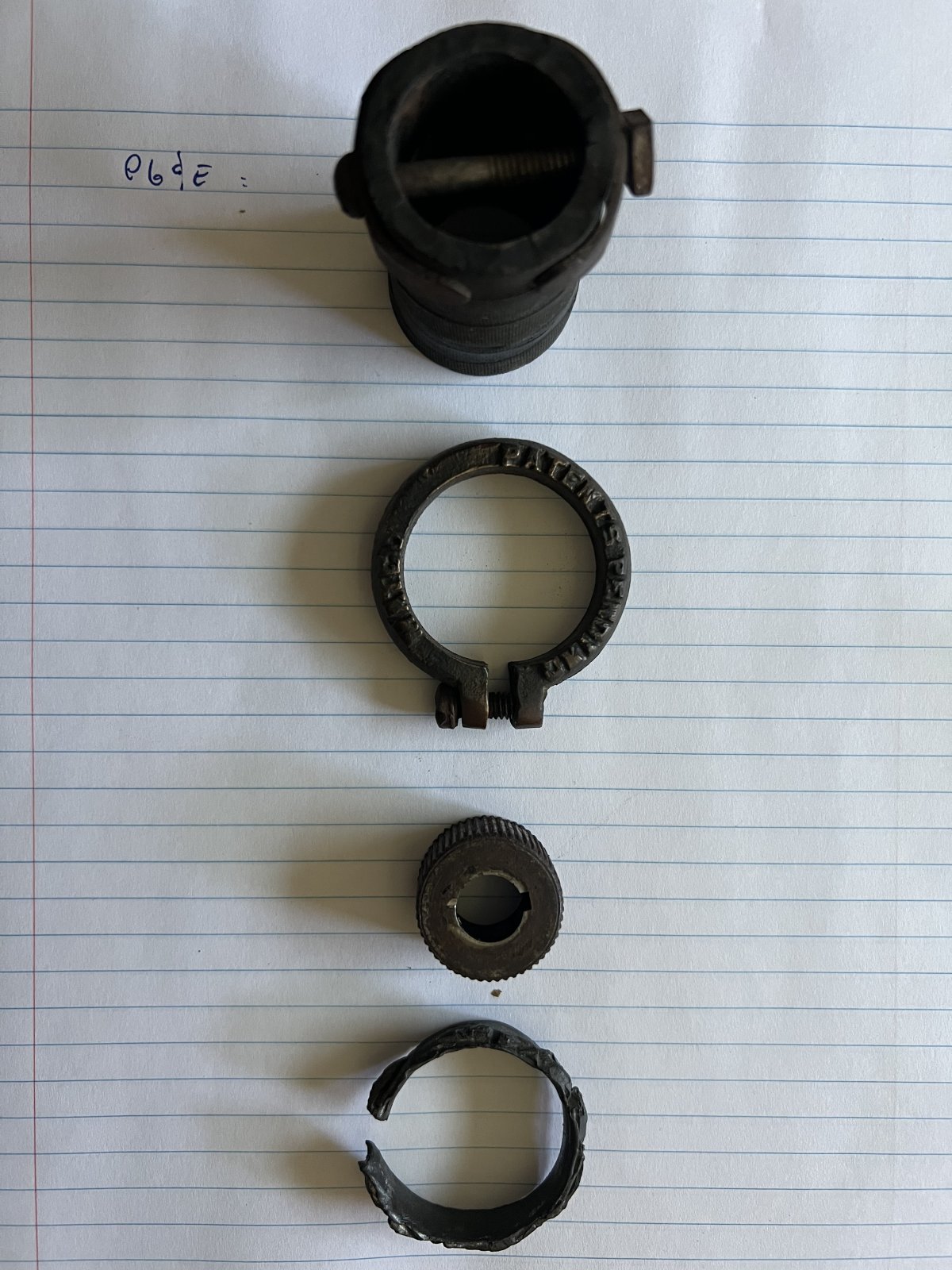

  11. This is what I was able to scrounge up. The hose bit with the clamps looks right. I am guessing the knurled bit went on to a magneto? Since I am running an impulse, will have to do a bit of work around.

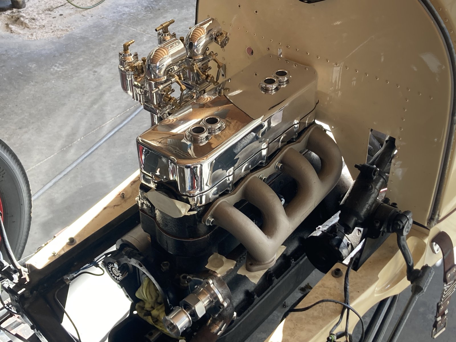

    Just heard that my cam should be getting ground next week! The cam grinder is insisting that I change the lifters… easier said than done in this motor. A typical T has a large inspection plate and would allow the lifters to be easily changed without even draining the oil. This thing is fully sumped with just a small inspection cover. We’ll see if I can get my hand in there…
    The top of the engine is looking good tho
    Jet96, Old Dawg, 40 Olds and 6 others like this.
  13. Who did you go with for a cam grind? A or T? Off the shelf grind or dream up something silly?
  14. Kevin Pharis

    That’s the stuff! You could pull off the impulse and get a new bit of hose, and be running by sundown! The impulse is mostly a hand cranking thing, they have a centrifugal weight that locks em up at some point. And they make a goofy rattling sound at idle too ;)
  15. Kevin Pharis

    This fella wound up with all Harvey Crane Jr.’s master profiles. We picked a a profile with sumpin like .228 lift, 220 duration, and are going to try to get 113 centerline out of the stock T core.

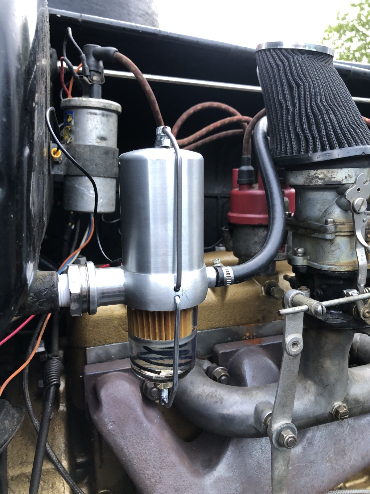

  16. Rotoshim fuel pump and filter under test - all good so far! They machined an adapter to fit it in place of the T tap. 0D91E2A6-6BA6-4BE7-BE0C-E500364B2021.jpeg

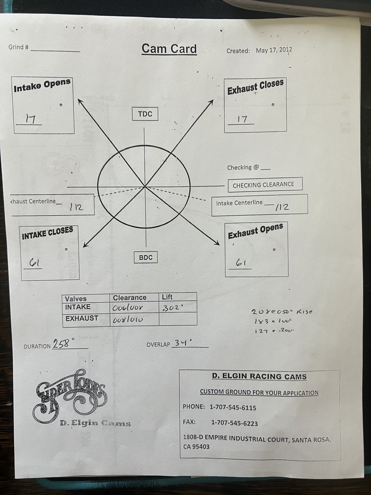

  17. Super cool! This is the cam grind that Dema came up with for my T. There is enough to work with, that I can do the Ed Iskendarian trick of reducing the lift / duration to build more torque. Going into a "speedster" w/od pulling power will be nice. Of course I have to get the damned thing in there.

    Looking at this, it looks quite a bit different from your first picture. Can they not machine the body fitting to go directly onto the original Ford fitting? When turning the unit onto the firewall, is there swing space and are there any other clearance issues? What size is the outlet? Is there really a pressure regulator or is an external regulator required? If no regulator, what pressure does it put out? You only need 1-1.5 lb for the 97. I want this unit, if you are part of the test group, perhaps you can p*** along the concerns. Thanks.

    Notice the firewall… this is adapted to test in a 26/27 T

  25. It's designed to fit directly through the bulkhead like the original Model A with a 3/4" nut on the inside so you don't need to swing it. They made the adaptor for me to test it in my T as Kevin said. Normally the aluminium body would be up against the bulkhead and the stock Model A (pre-31) pipe and tap would hook up as standard.
    The regulator is inside the body. You have to drop the gl*** bowl off to access it. This one is set to 1.9psi. We're not far from where the Strombergs are made so they've advised what was required in relation to flow and pressure.
    The outlet size is the same as a Model A.
    Hope that helps Warren!

  26. wuga
    Joined: Sep 21, 2008
    Posts: 727
    wuga
    Thanks hotrodfil, that is everything I wanted to hear.
