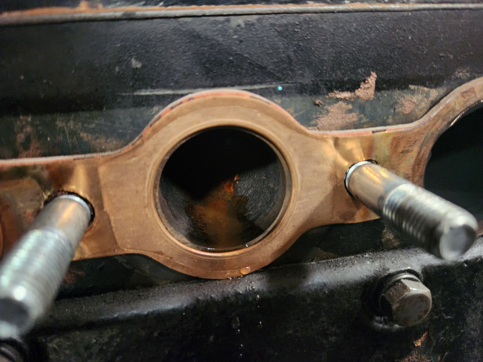

    Well....I just pulled the intake manifold off to swap to the downdraft and there is a bit of water in the intake ports...hmmm. not good. Thinking headgasket or the block has been previously overheated and they're cracked. Not sure of my next step.

    Thanks. I've been looking into the combustion chambers. And it looks like the water is coming from inside the chambers on 2 and 3. I'm pulling the head next.
    4BangerDean and Outback like this.
  13. If it were mine to troubleshoot, I would start with a leakdown tester. If it is the gasket, you would have leakage into the water/radiator. So, an observation, if this is the intake port between 1&2 and the leak is in the port itself, it will make 1&2 show rust in the chambers. If in fact you are seeing rust in 2 & 3, there are more things going on.

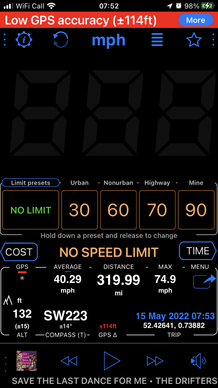

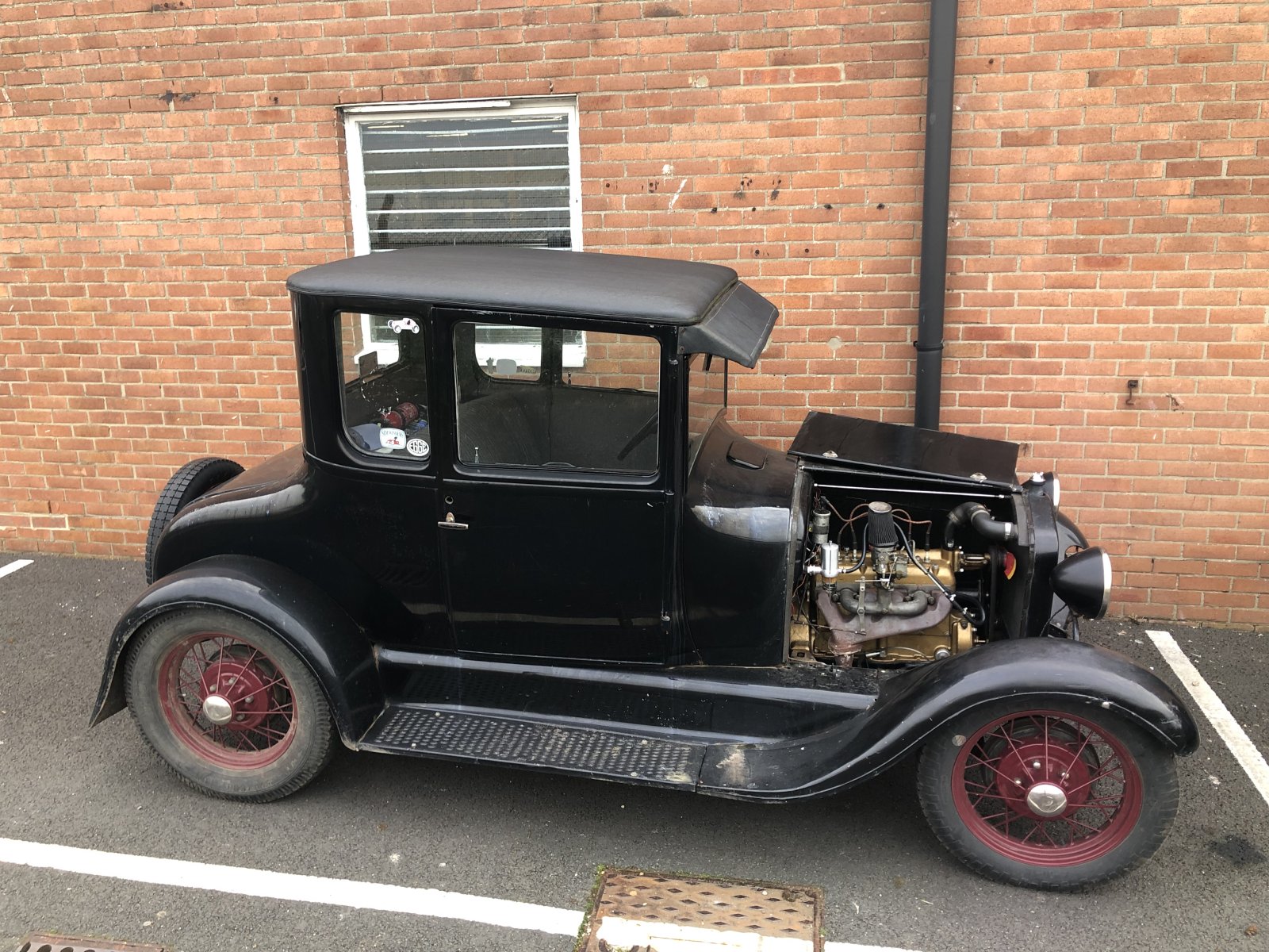

  15. Still clocking up some running in miles - drove to work today. Around 450 miles so far. Approaching 100 miles on the new fuel pump.
    Couldn't resist winding her up a little on the byp*** though... GPS Speedo app on my phone. Just under 2700rpm I reckon.

    I gave it the ol' sniff test and I can smell the exhaust gas in the radiator.
    Thanks that was my first hope as well, but I think I'm onto what the issue is, fairly certain a failed or inaccurate torque wrench is to blame. I'll have one this afternoon to test against.
    The real question is now, do I take the time to swap from the super winfield to an original red head?

    Inaccurate torque wrench confirmed

  23. Hell yeah! A few hundred miles more and I'll put my foot down...

  25. Not yet. On the trip to Wales last year I managed around 25mpg with my Brierley head and a Stipe 340 in the diamond B. Previously it was around 22 with my previous engine. All back roads as much as possible. Hoping for around the same with the Burtz engine as long as I don't sit in the 70's too much! 55-65 seems a sweet spot.
    I'm running a 3.27 rear end in the Coupe behind a stock A transmission. Seems to pull it OK.
