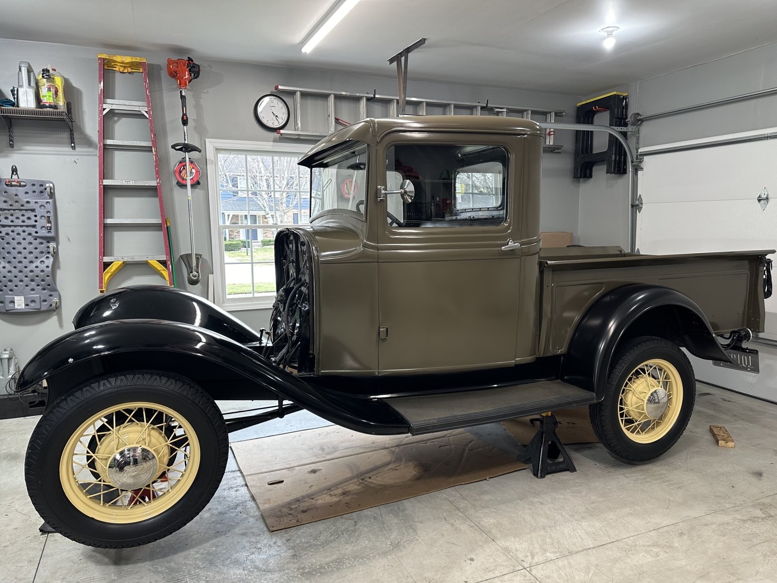

    After a little time off from the Model B I’m back at it. I needed to focus on the homestretch of physical therapy (extensive shoulder reconstruction) and a return to work. Needless to say it’s great to have that behind me and to focus on working on a 92 year old truck.

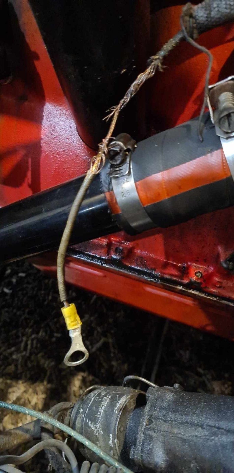

    Time for re-do.
    I've replaced the frayed wire as a temporary fix for my wiring issues.
    Next step is the design and sourcing of the new wiring components for a total rewire.
    Anyone converted an F100 steering box to suit a model A light switch?

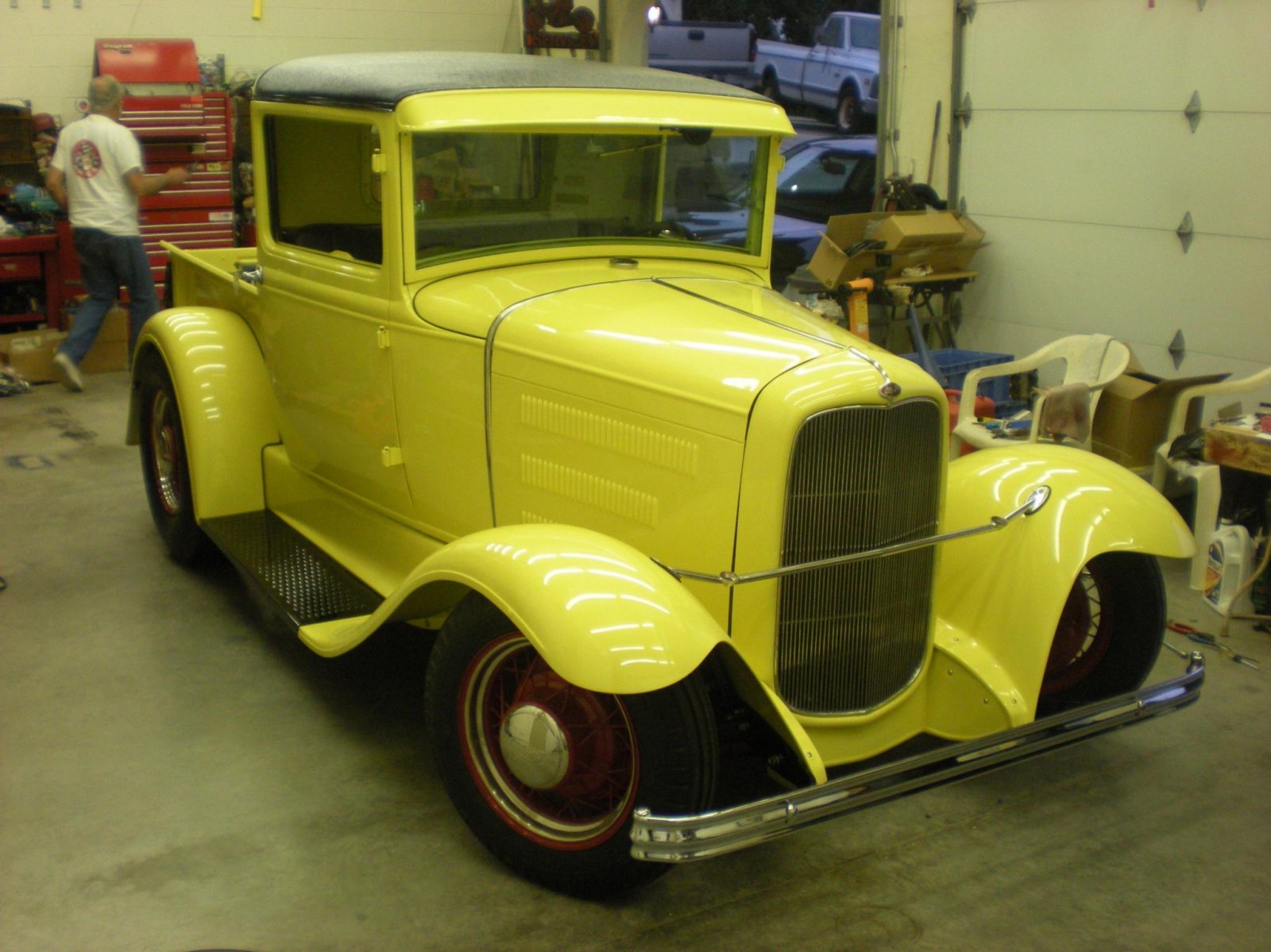

    I've registered Pop's truck for the Nats. Be there or be square.

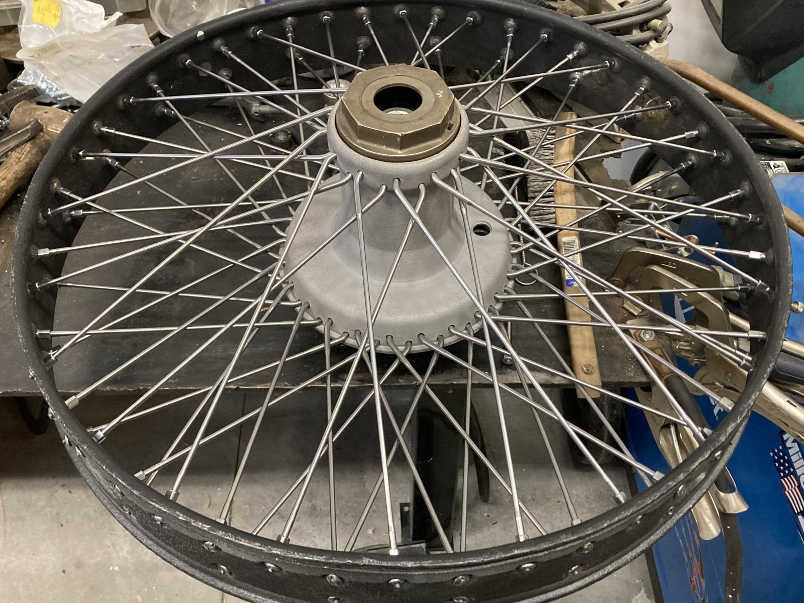

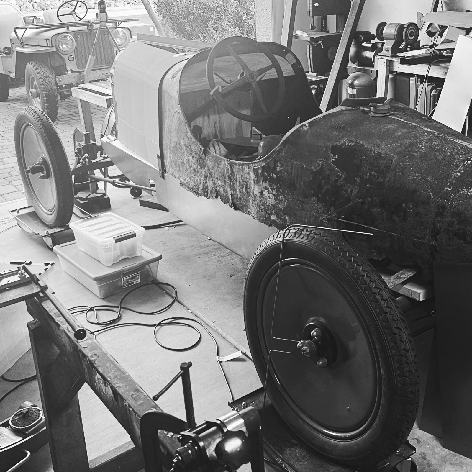

    Still here! Been working on everyone else’s stuff rather than my own lately. Kinda pissed at my car right now… but will get back at it soon enough.
    Right now working on building up a set of 72 spoke 26” Houk wires for an 1920 Indy 500 recreation. Gettin closer…

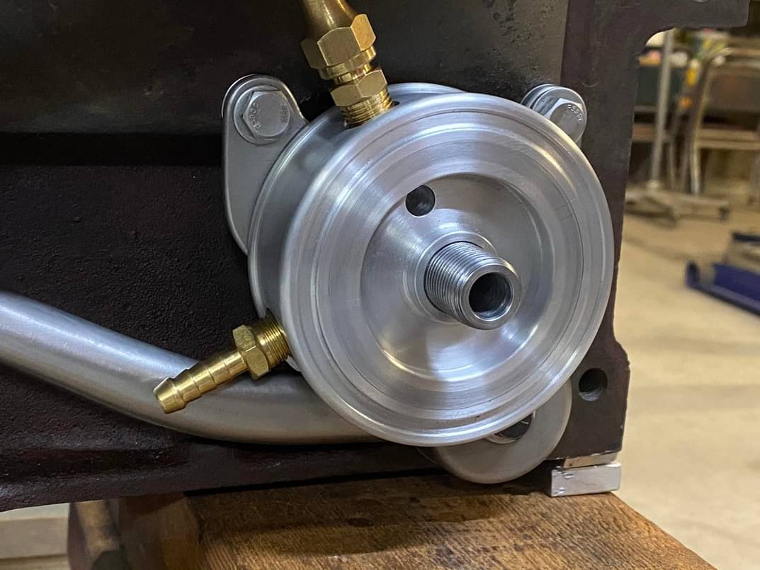

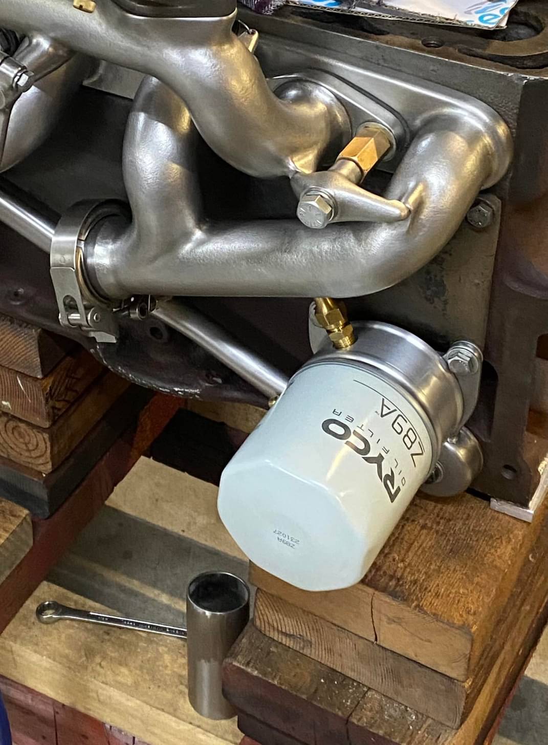

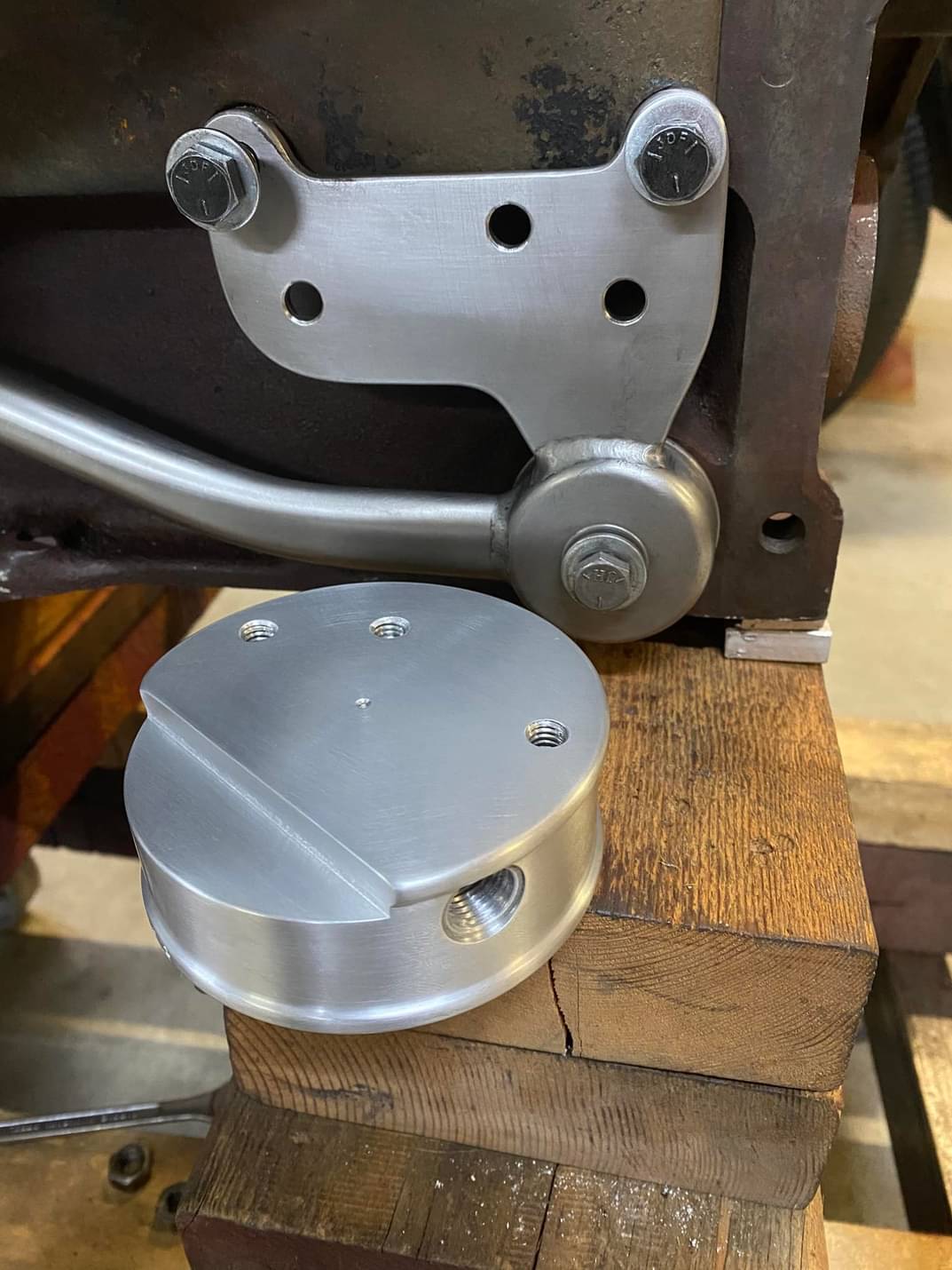

    img_4_1712450875066.jpg img_3_1712450803310.jpg img_2_1712450792084.jpg When off the shelf won't do! :)
    No my work, but for the regular's at the monthly banger meet you'll recognize the exhaust work :D

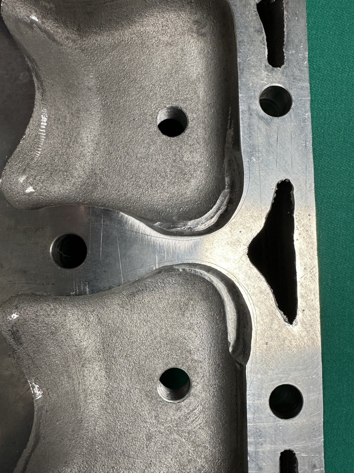

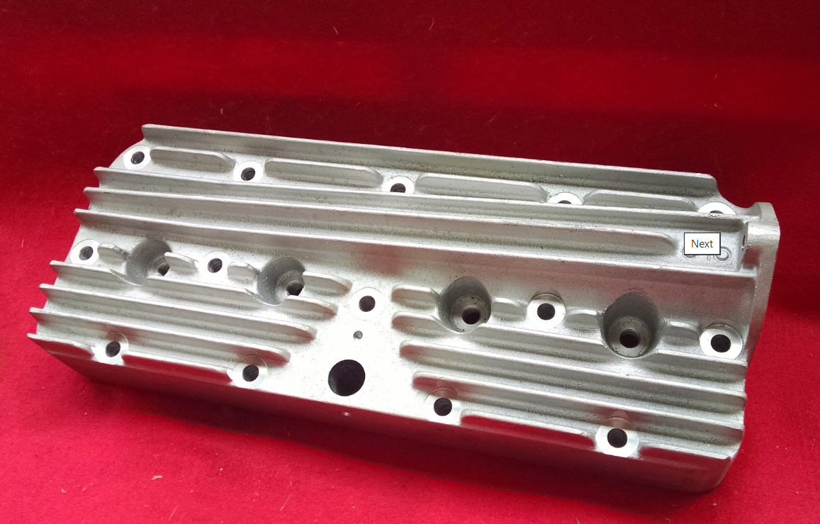

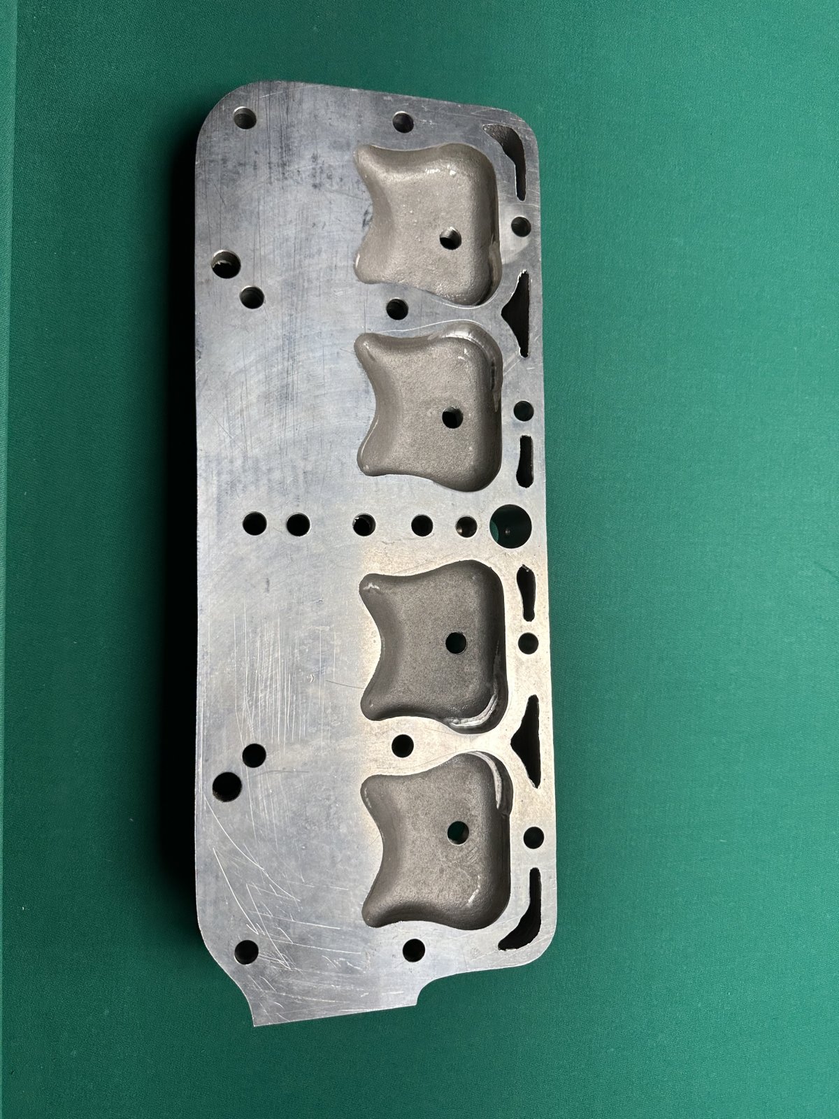

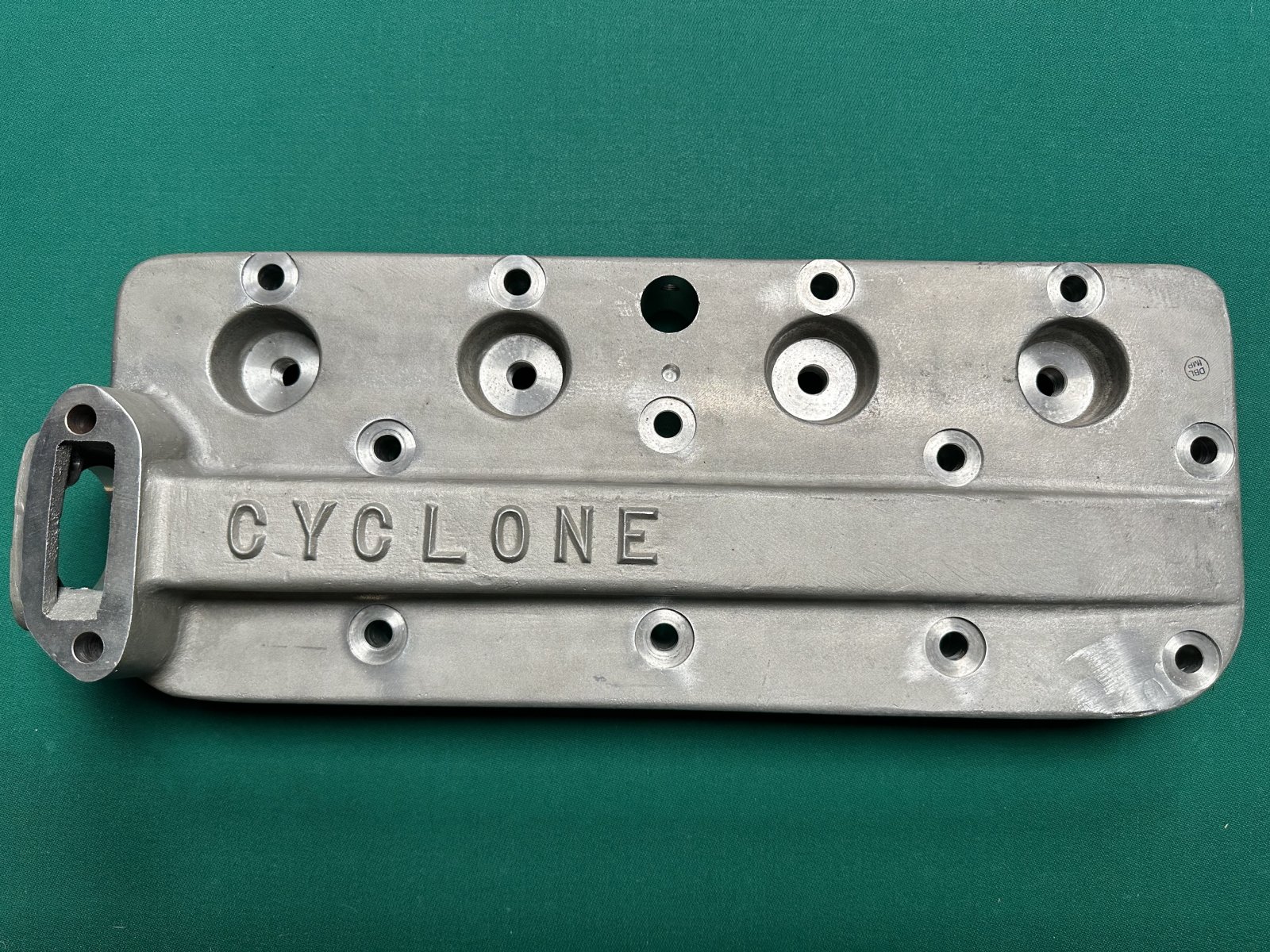

    While we are talking about heads. What does the group think of this one? I bought it a year and half ago used but “new” before I knew anything. I still know nothing but I’m committed to banger building.
    Anyways, I lack confidence in who made it and I believed it could have have been machined or (finished?) better than it was. It definitely has had some handy work done for valve relief that looks inconsistent at best. It seems that it would need to be cleaned up and should be matched, Please educate me.

    If ya got it- run it and see how you like the result. Looks like an OK casting. Watch your deck clearance and piston height- A block that has been surfaced a bunch will present issues, and then you are looking at special pistons or finding some that have enough meat in the dome to get a zero deck height. Gonna be lots of compression, so watch your timing.
    A little die grinder work with a burr and a few cartridge rolls and the valve pockets can be blended in. You could run it like it is and probably never know the difference, but you will sleep better at night knowing you did it right. Nothing wakes up a banger like a good cam and lots of compression.
