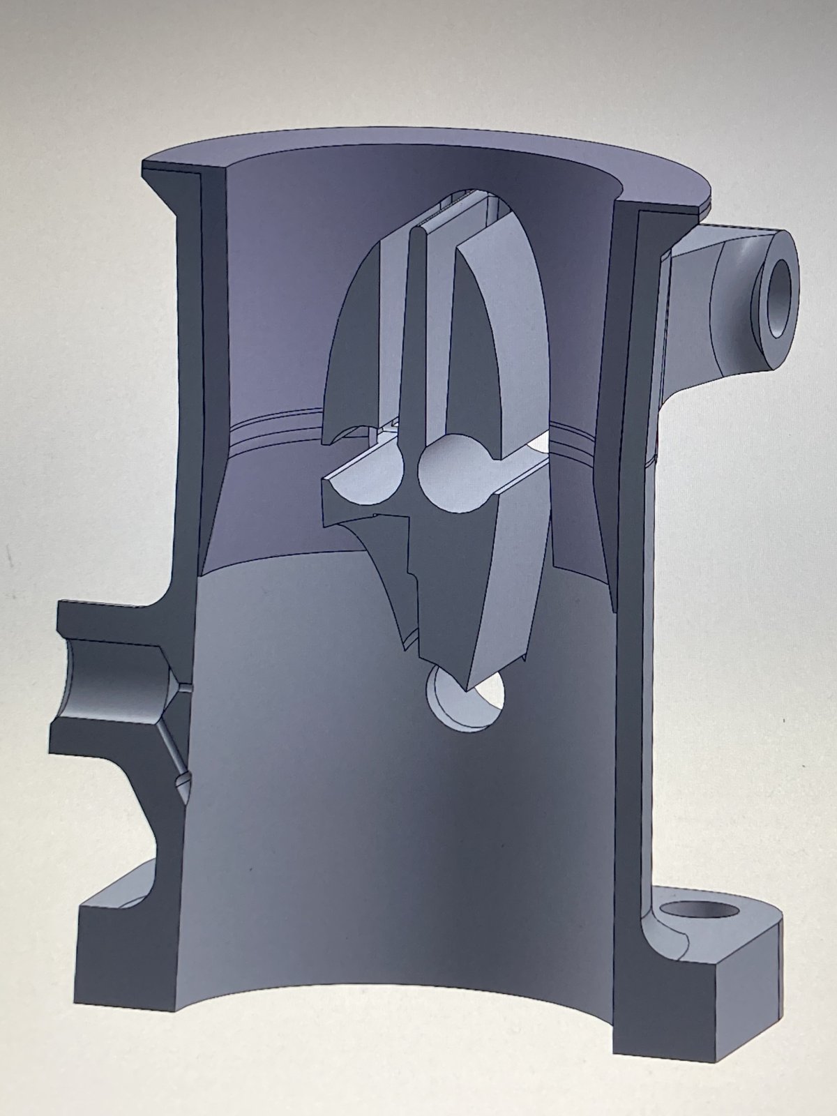

    from Califunny
    Yup! Yur lookin at the CAD model of my S-B Winfield throttle barrel (cut in half of course), with an additional sleeve that would reduce down to an A or AA size. Since my pair of B’s turned out to be waaay too big I have been contemplating different options to reduce air volume without abandoning all the effort spent so far. Confident that these could be made and tested in a weekend, rather than the 100’s of hours it would take to create new carb bodies, manifolds, etc…

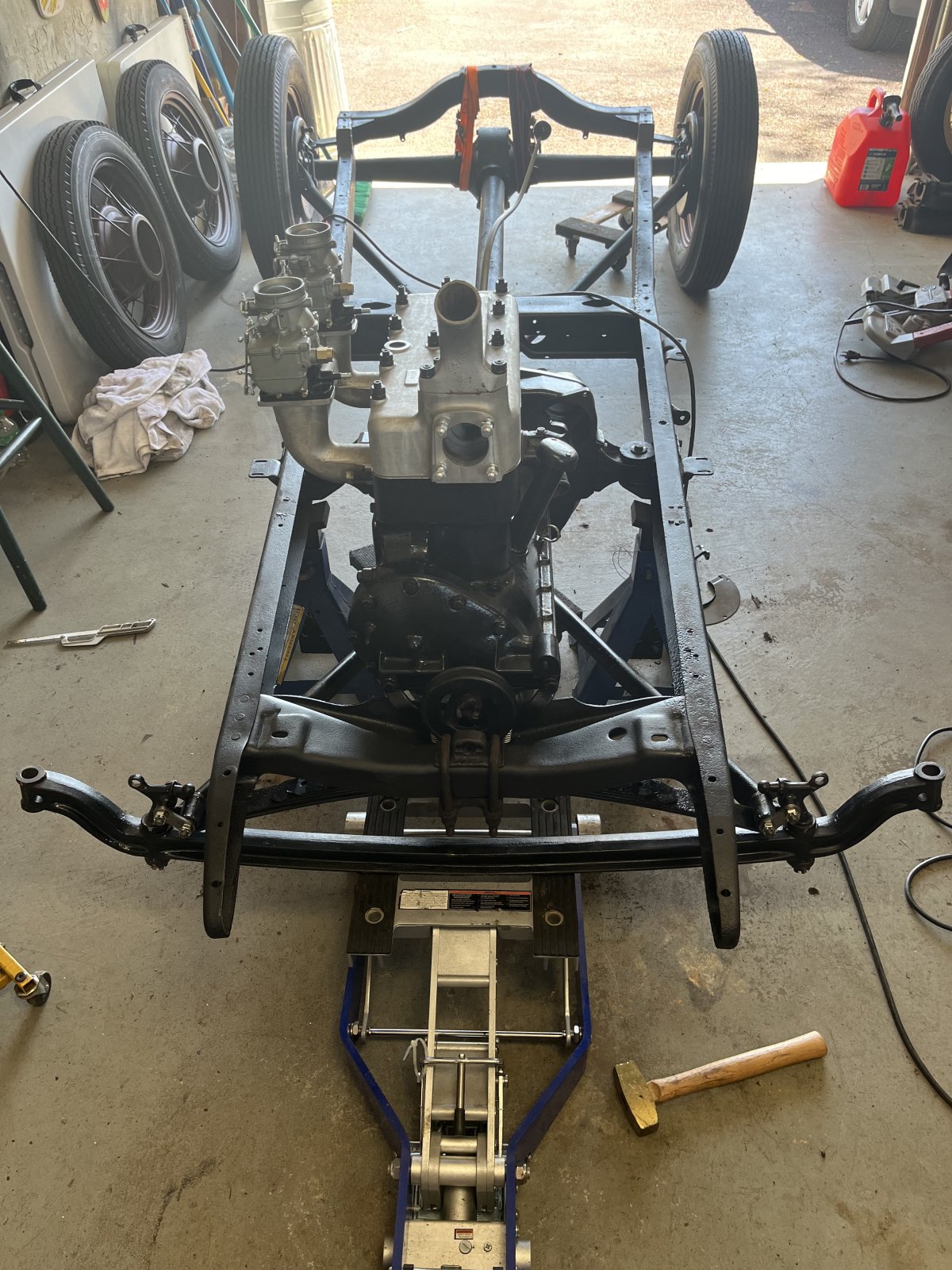

    walls

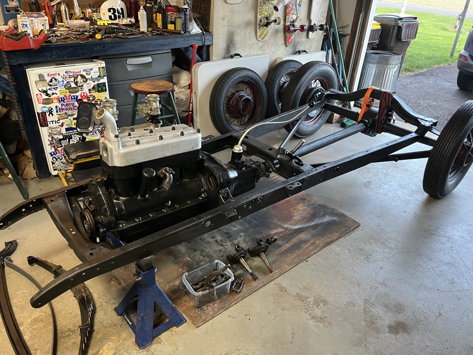

    Decent day. Got the engine and trans together and in the frame.
    Bolted the intake and carbs on cause I couldn’t help myself.

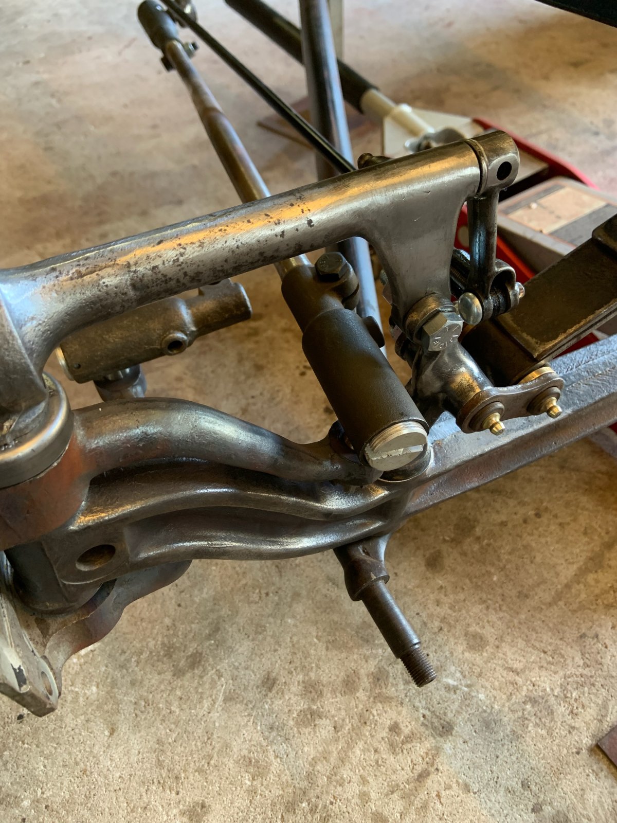

    I was thinking about @walls build, and my own dilemma of wanting to run a dropped axle with mechanical brakes.
    Looking at my axle, the track is narrowed due to the drop. The brake actuator rods head inwards, what looks like enough that they will interfere with the original model A shockers, even if I use shorty dog-bones.
    so my question is - has anyone narrowed the brake actuators so that they keep their position relative to the shockers? To do this, they must be narrowed between the perch bolt bolt-hole and the spindle.

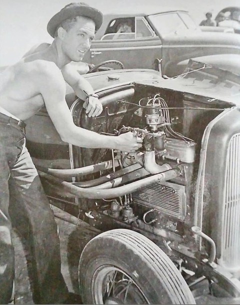

    IMG_6034.jpg Is this running split exhaust manifolds? It looks like and exhaust pipe running straight down where the stock Carb would be, but it also looks like one manifold (although it is kind of hidden).
    This is John Bean's car taken from "The Duke Hallock Story" https://patganahl.com/2022/05/02/the-duke-hallock-story/. It says it is a cragar head. I have seen them in this period with a lake header, this one looks like one manifold with two pipes?

    5280A2
    Based on the intake manifold that sure looks like a flathead setup. Also exhaust sure looks like a split manifold or an additional center outlet. Fun to try to figure out what we're seeing!

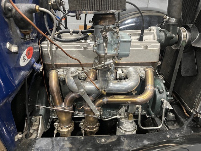

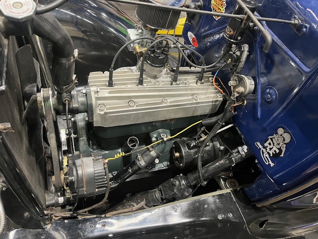

    love it...no issues so far... seems to double the hp with that and the 2 to 1 header split dual exhaust... IMG_1296 - Copy.jpg IMG_1297.jpg IMG_8346.jpg IMG_8807[8523].jpg IMG_8808[8524].jpg IMG_8810[8526].jpg

    0.30 above the block works...

    ALLDONE
    don't know a lot about the engine, just what i've personaly seen.. the motor is a "B",.. 125 over bore, insert bearings. balanced crank. lightened flywheel.custom oil pump, all new stuff inside. I put the FSI dist,.. we split the exhaust 1&2-3&4 to dual lake pipes...the trans is a 39 syncro 2nd and 3rd with an electric over drive

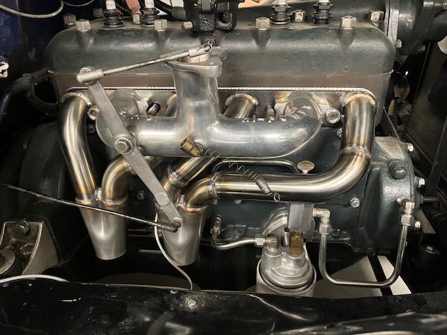

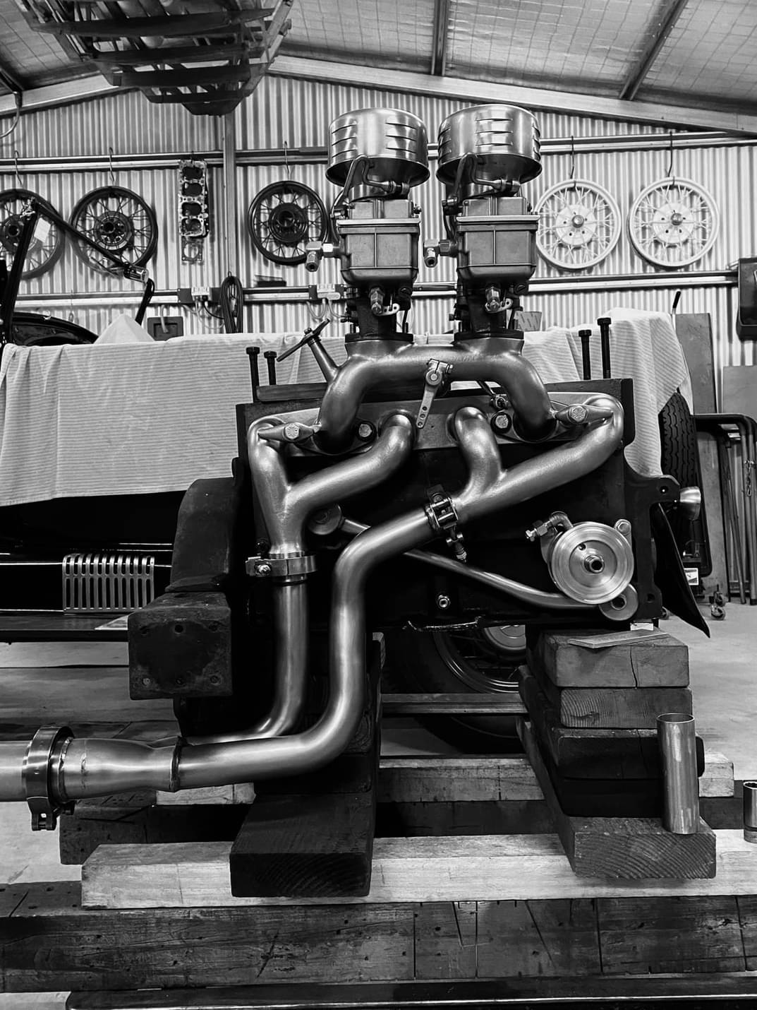

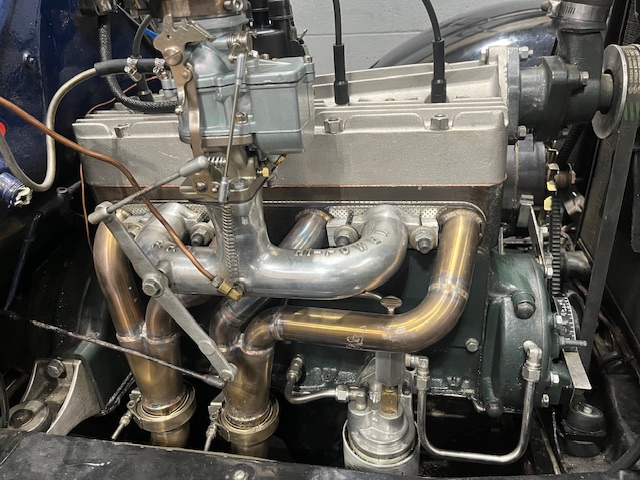

    img_3_1713265367404.jpg img_1_1713265290166.jpg img_2_1713265347557.jpg img_1_1713328089180.jpg This is my mates manifolds/filter ***y fitted

    Not mine, but a friend just up the road, haven't been able to get him on here.

  21. 4BangerDean
    Joined: Aug 10, 2013
    Posts: 268
    4BangerDean
    Looks like an engineering masterpiece. Please share what we are looking at and what it’s going into. My guess is landspeed racing.
    Outback likes this.

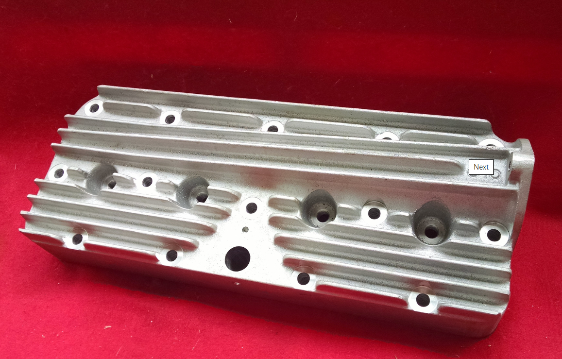

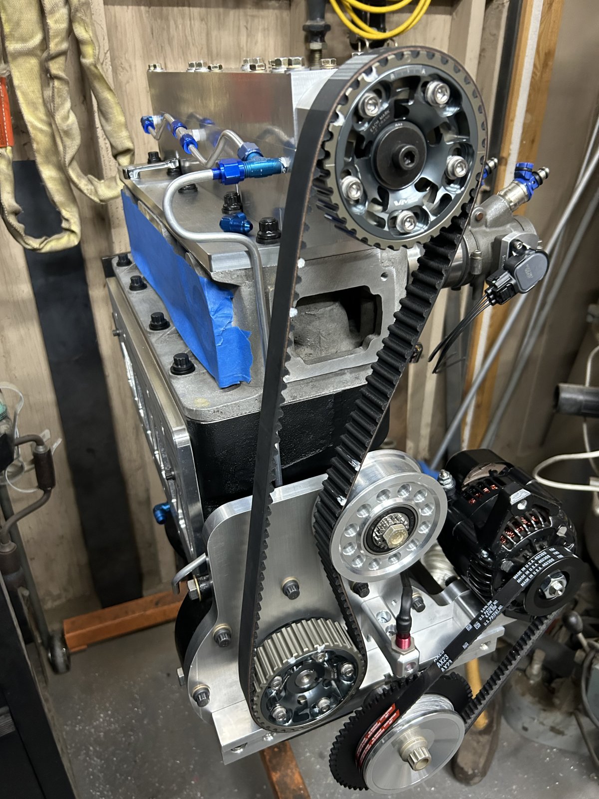

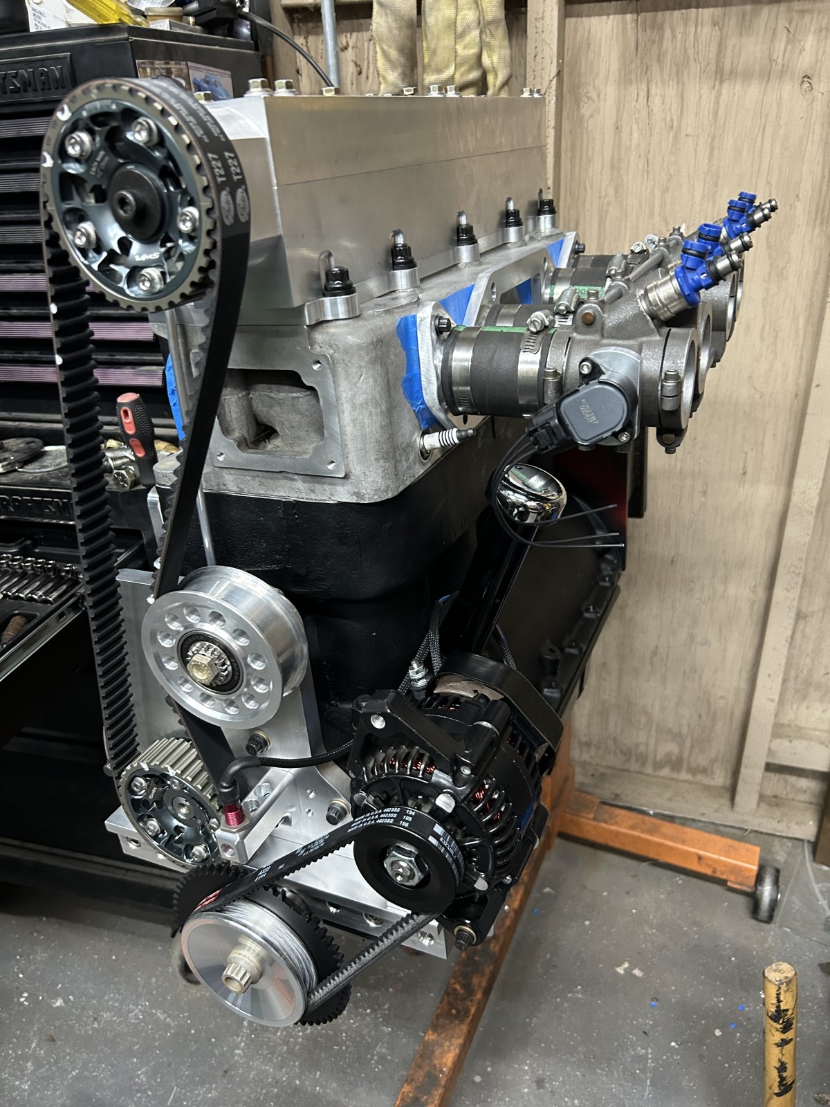

  22. Well, it is an example of glacial speed engineering....
    B block, C crank modded, B rods with inserts, TRW 283 pistons.
    This was an untouched Gemsa Morales casting for the head.
    I moved the valve locations and put in 2-1/16" intakes, 1-5/8" ex.
    The SOHC is a one off design, Brierley cam with Jag buckets and special springs.
    Intake is Hilborn 1-11/16" modded for EFI.
    Not for Bonneville, is going in my tan '30 street coop.
    Nader said unsafe at any speed, this one will be unsafe even while parked!
    J

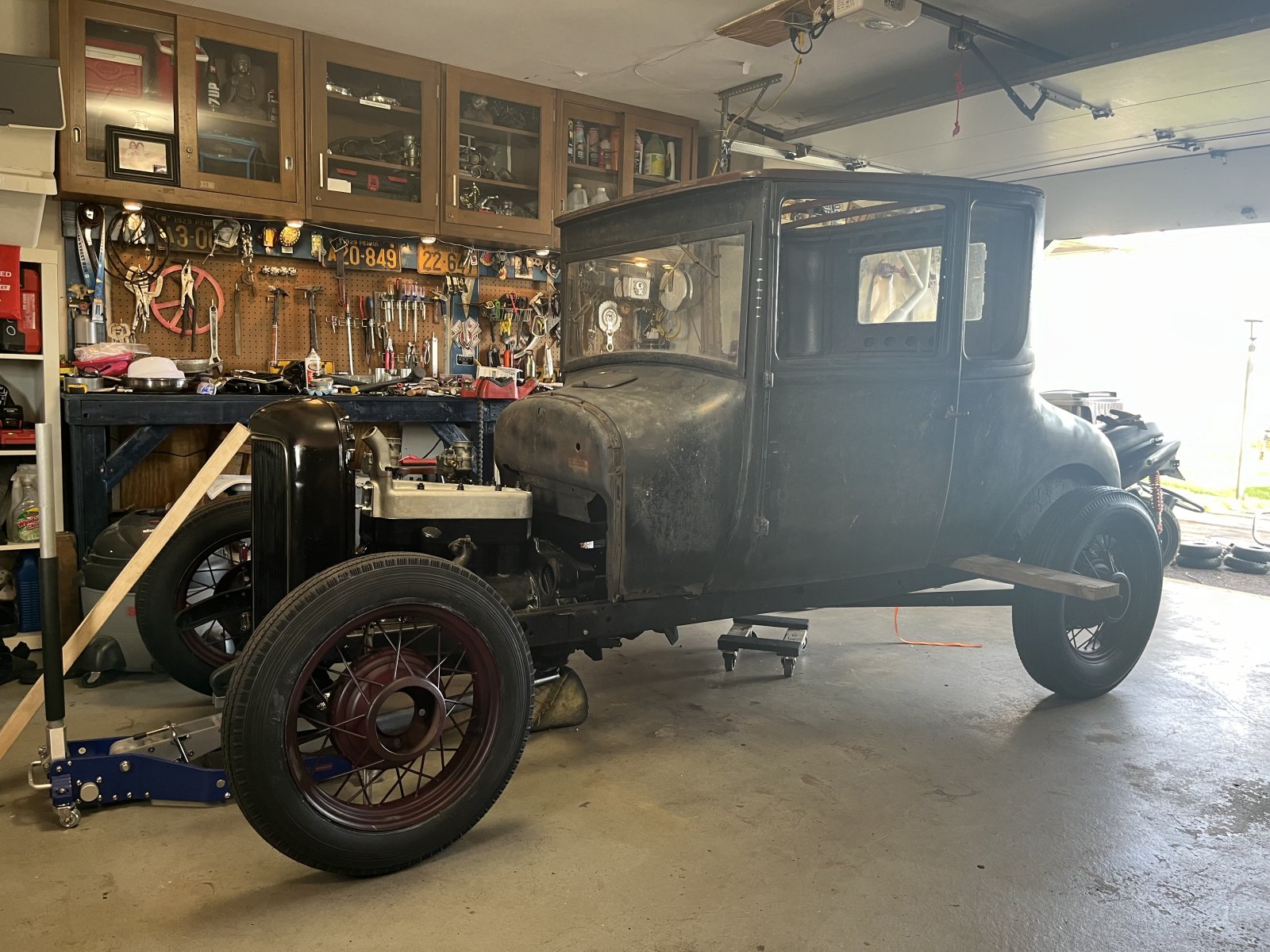

    Weekend 3 of putting stuff together.
    Not bad. Waiting on some 32 spindles to come in the mail.
    Plan is to chop it about 5”

    [​IMG]Are the exhaust manifolds custom made or can they be bought somewhere? They look great!
    Outback likes this.

    Joined: Mar 4, 2005
    Posts: 3,374
    Outback
    from NE Vic
    The manifolds are fabricated, I posted some pics in last months thread, made in a similar way to the inlet manifold, hrs of work in them! img_4_1710471687303.jpg
