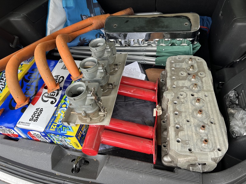

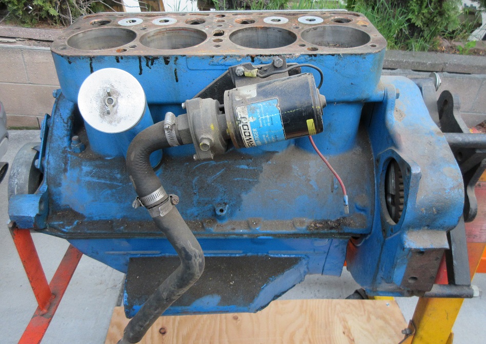

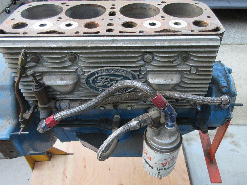

    Thanks - it'll help me piece my Rutherford back together. B block, C crank - cross drilled, Pontiac rods, Aluminum flywheel, electric water pump, Magneto, 3 Stromberg 48s (It ran a pair of 500 cfm Holley 2 bbl carbs when it ran 133. The engine still holds a record in Australia.

    That must have been Chuck's engine in the Rae-Weir-Mumford T roadster

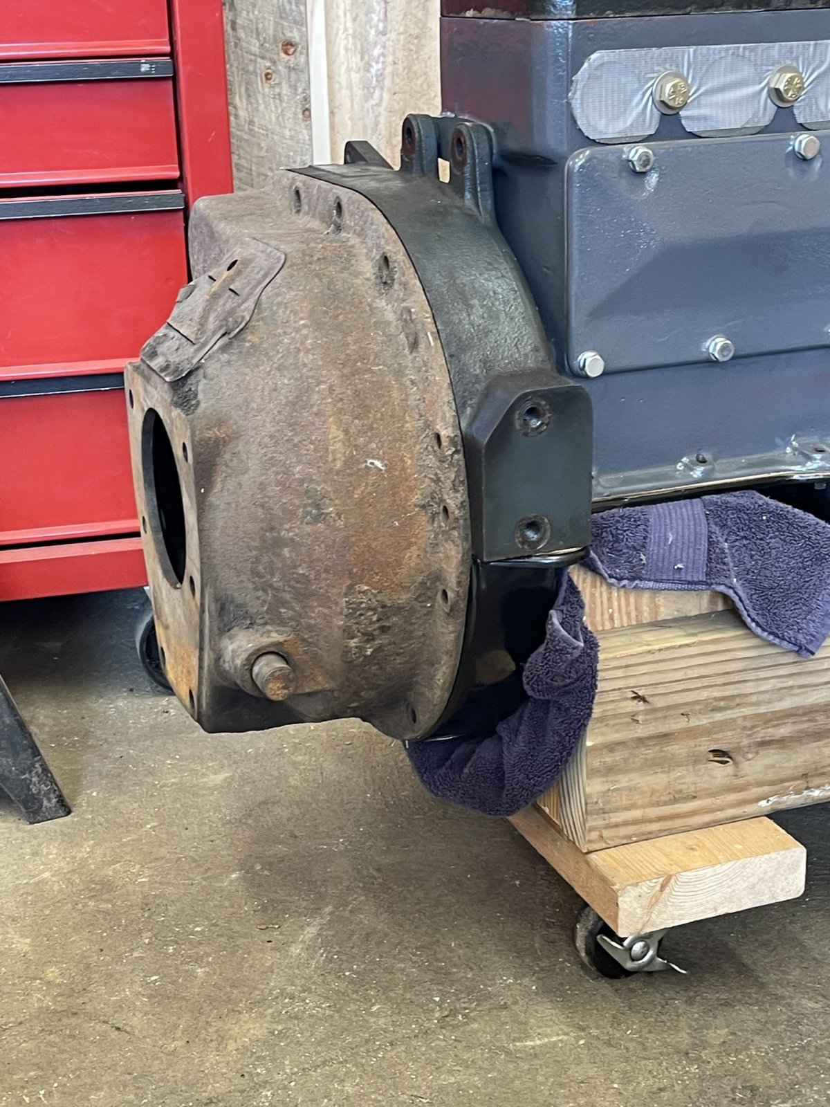

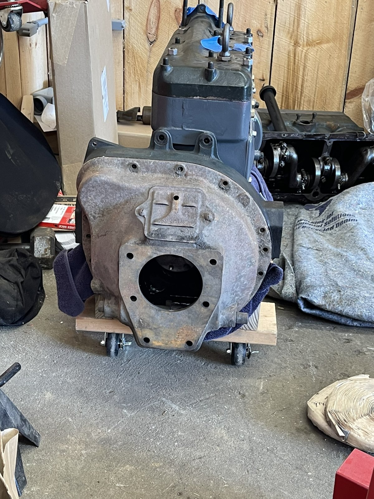

    Hmm all this T-5 talk made me pull out my BB hogshead and see how it fits (since the motor is out). Might have to watch for a t-5. Here in the rusty New England they should be reasonable.

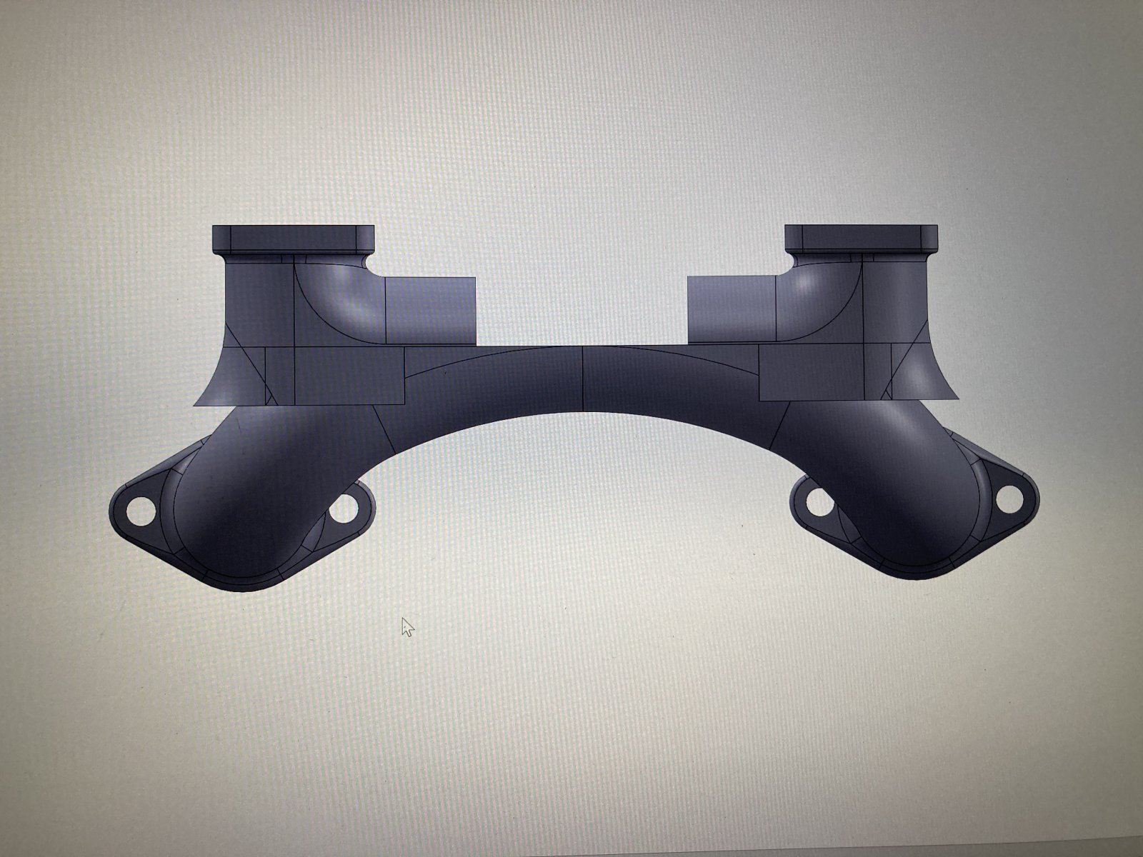

    Anyone else feeling cheap these days…? I couldn’t bring myself to spend the money to order up a new dual manifold casting for the Akron-Hed with wider carb spacing. So I called the fella that bought my extra manifold and explained the drivability issues that were encountered and offered to buy it back. It is headed back home now and is slated to be sectioned and widened to allow the carbs to be oriented with bowls to the front. Here is the plan; section about 5/8” out of the plenum and widen the carb flanges 3”. I should be able to fit in sections of tubing to close it all up and a bit of welding to finish er off. To be concluded…
