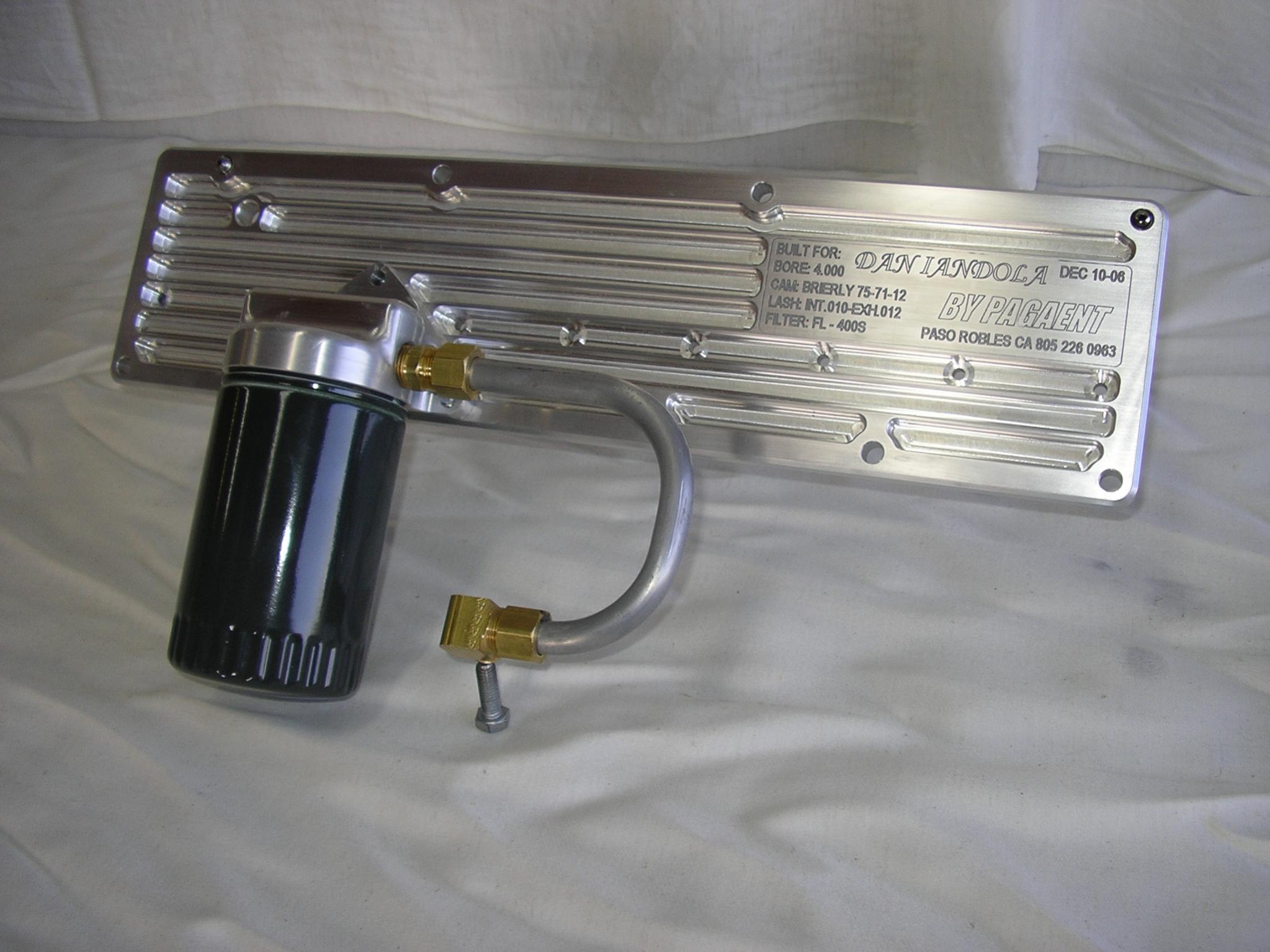

    I would like to run the oil through a filter and perhaps add some measure of extra efficiency to the oiling system. My idea is to run a pump modified to increase flow/pressure and have it all exit the inspection plug on the side of the block and to a filter, from there the system will branch with one line feeding the timing cover/gears, and the other will enter the valve cover (or somewhere) run the length of the block with outlets feeding the drain holes that feed the bearings and bits. Now, the pump I have in mind states that provisions must be made, "to oil the center cam bearing if the oil is routed out of the block." How would I do accomplish that? Is this whole plan ill-conceived? Suggestions?
    Thanks for reading, and thanks for being such a terrific community. I'll try to be more active, but don't feel I could really add much. Honestly, I've got nothin'.

    As long as the drive for the oil pump is stock, a number 60 hole drilled vertically in the top of the pump casting will oil the center cam brg. and the drive gears. This would be in the area where the slot(s) were in the casting that have to be filled in when converting to pressure. Just let a little oil pass vertically.
    I would not run a line to the timing gears--the oil is needed more in other areas, and enough oil spills out of the valve spring area (A), or oil gallery (B) to oil the gears

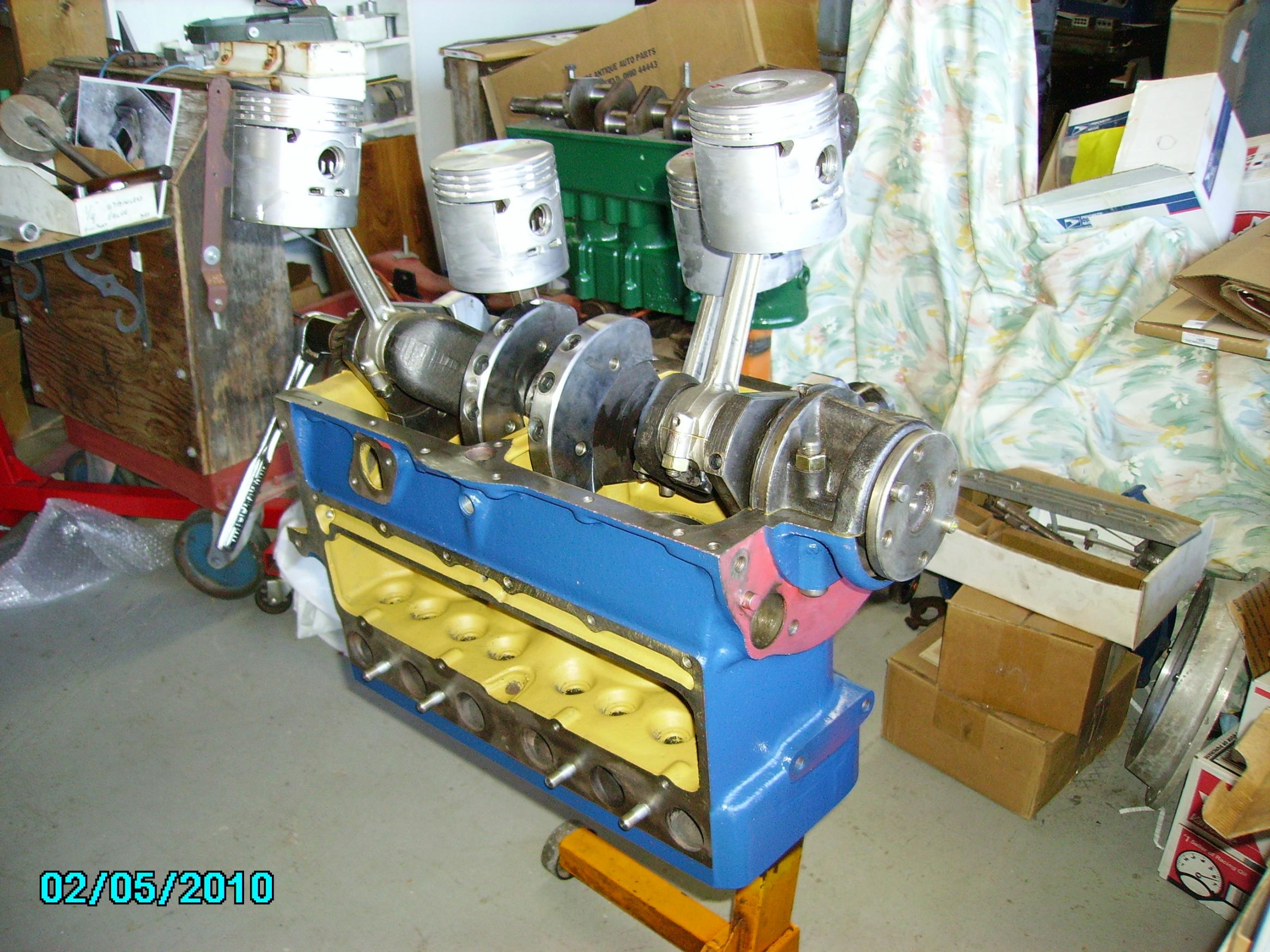

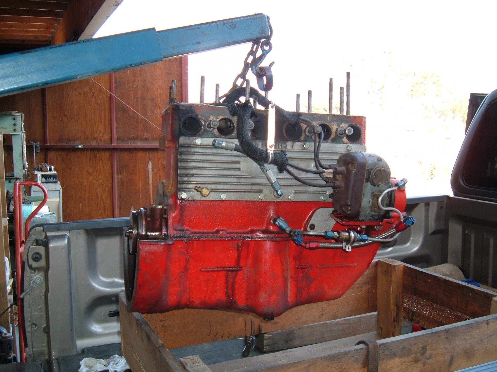

    JN: you've accomplished quite a bit, but you didn't mention if you had drilled the crank for oil to the rods. Here's some pictures of a kit I developed a few years ago to make a simple, clean & durable oiling system. The engine in the picture went into a hi-way driven '31 Fordor and had
    Babbitt bearings. Hot oil pressure with 10-40 was 25 lbs. at idle and 45 on the hi-way. If you want more pictures of the assy. you can pm me. Pat

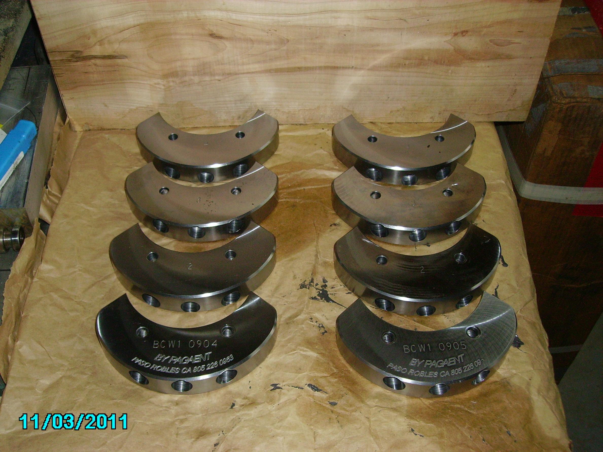

    Very nice machining!
    Why do the added counterweights look like they are made of aluminum? I like the way you removed some material from the crank to make it blend better with the shape of the counterweight.
    Herb

    Haha, I never thought of using aluminum for the weights. The weights are made of hot rolled steel plate that was milled with a carbide insert flycutter, before the inserts get dull they give a brilliant finish when run at high speed. I use a 3.5" dia. flycutter and run it at 2,800 rpm. I milled the crank wheels to reduce the necessity of a larger counterweight, this also kept the overall weight of the crank down and made it look more like a "C" crank. Long before the police were in vogue everyone called them "C" , could be because there was a large letter C cast on the head near the Dist.? Pat
  12. Pat,
    Do you have any closer/clearer pics of the counterweights? If it's not going to give up any secrets, I'd love to get a better understanding of how/where you connected them to the crank.
    Thanks, Bill
  13. BHT8BALL
    Joined: Aug 22, 2010
    Posts: 262
    BHT8BALL
    Bill there are no secrets, just a lot of work. But used with the crank damper it makes an extremely smooth engine. Almost like a real one. Hope these pictures answer you questions, if not, ask away. On the "B" cranks I use three 7/16-20 domestic soc hd bolts & on the "A" I only use two because the "A" weights are lighter. One bolt is more than adequate to 7,000 rpm but the extra two give peace of mind and keeps the weight from wiggling. Pat

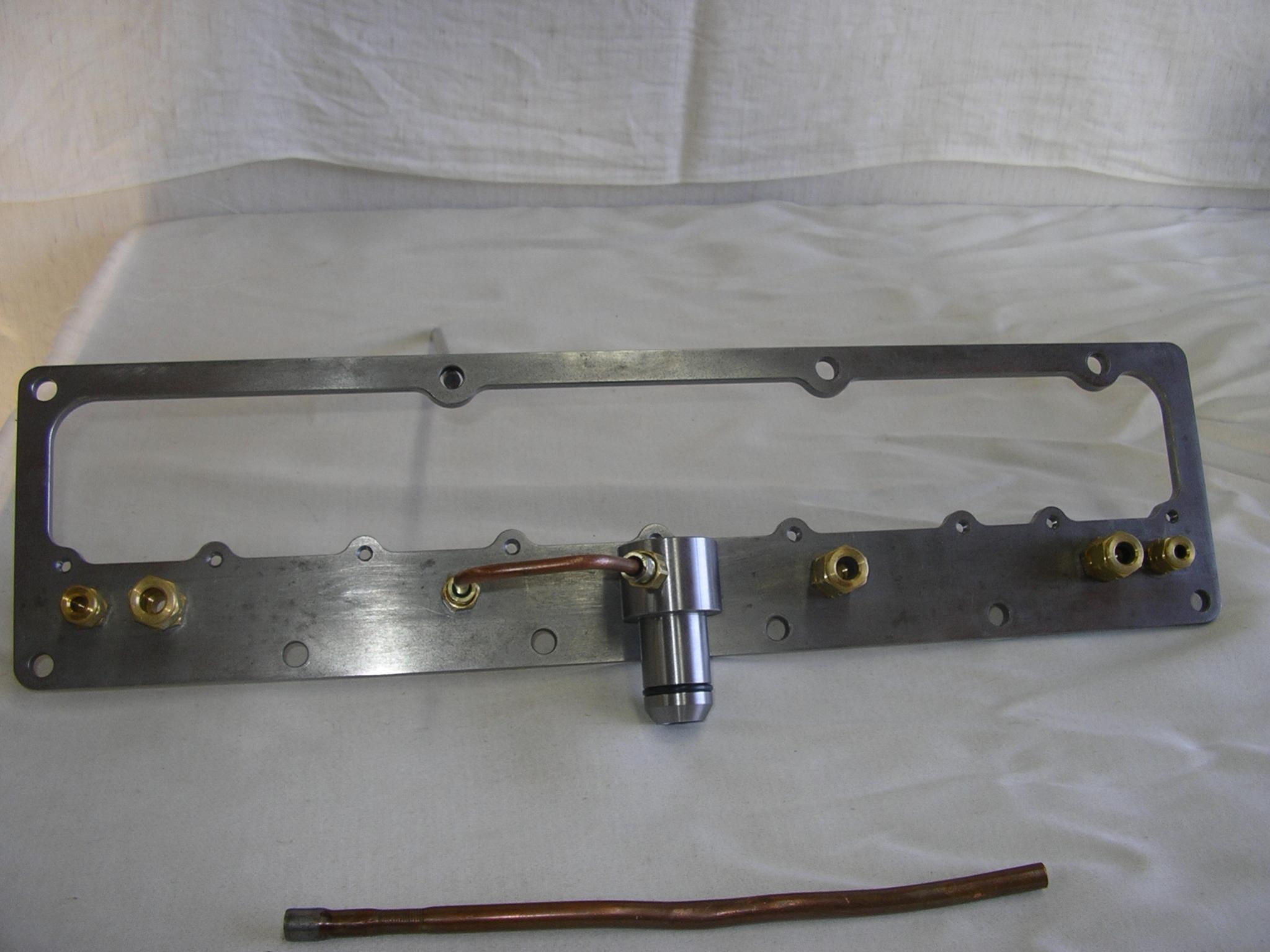

    Pat great build on this motor could you explain more on your front plate set up and what crank damper you used thanks Rusty

    Hi Rusty, I searched and couldn't find a complete photo of all the parts to the front cover. The water pump is a NASCAR unit, the damper is modified 283 chev, the hub is turned off and bolted to a 4140 steel hub with a keyway broached full length which means you need to install another keyway in the crank. Any model A dist. is used without modifying, it even turns the right way. the kit is pricey but there is "NO" machinework needed to install.(other than the keyway in the crank, and it's only needed in performance usage) but is complete with everything down to the belt, alternator, hoses( trim to fit ) all fasteners. I could scan a parts list if you want. Pat

    With all the work done to the crank to counter balance the rotating mass. Why use the stock style pistons and not use short skirt modern style pistons?
    ?2:
    Is this stock stroke?
    ?3:
    Are the rod bearings pressurized too?
    ?4
    Can you post any video of either of the flat head or the OHV engine running? if you need help with this, send me the video, and I will post it.
    ?5
    On the blue B engine, are those stock b rods? if so, are they inserted? And if they are inserted, what bearings were used on the mains and rods?
    ?6:
    What is the weight of the RPU modified?
  24. BHT8BALL
    Posts: 262
    BHT8BALL
    OK to the ?"s,
    #1, the owner is in his 80's and is not going to compete with it, and he wanted it sleeved to std. and use stock pistons.
    #2, yes, stock stroke
    #3, yes, the crank is drilled and has an enlarged oil pump.
    #4, I'll see if i can get some video's be patient.
    #5, yes, stock rods with babbitt.
    #6, I would guess that it will be about 1,300/1,400 lbs.
    #7, The rear main developed an oil leak so the engine is apart again, the babbitt was not done well and the crank had .009" runout on the #1 main while the rear was ok, go figger. so rather than redo the babbitt, I welded up the rear seal area on the crank to use a 350 Chev seal and will get the crank reground. This time i'll switch to inserts as a friend donated a set of B rods already bored for MGB inserts. For the mains I'm going to use V8-60 inserts and grind the mains -.030
    #8, I ground the cam to 289 HIPO Mustang specs, has a nice roll to the idle
