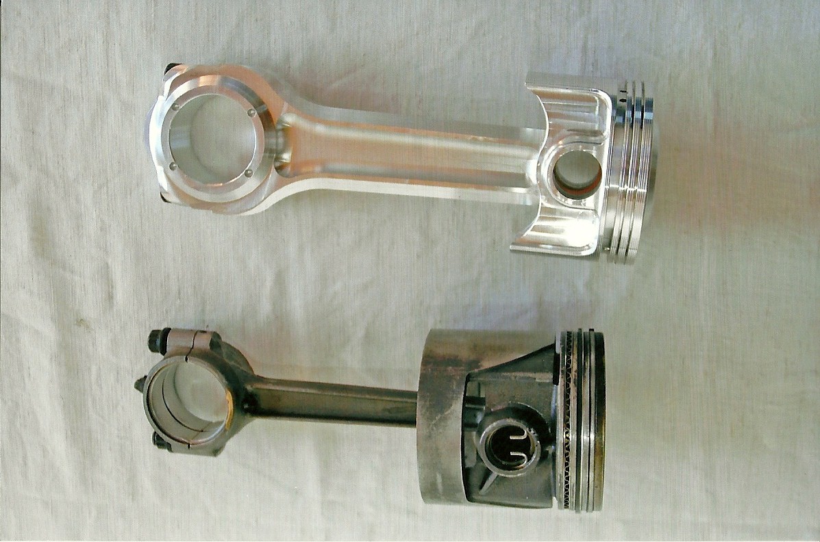

    I was trying to send a video but it failed, so I'll send some more pics, the rod & piston is in this engine. Pat

    wow!!! I put the kids to bed and you unleash the rod and piston **** :D
    Did you make the rods too?

    I made the rod and my son machined the piston for me, if you look close you can see the dome on top, that's how we got 11:1 comp. in the Jenkins head. Pat

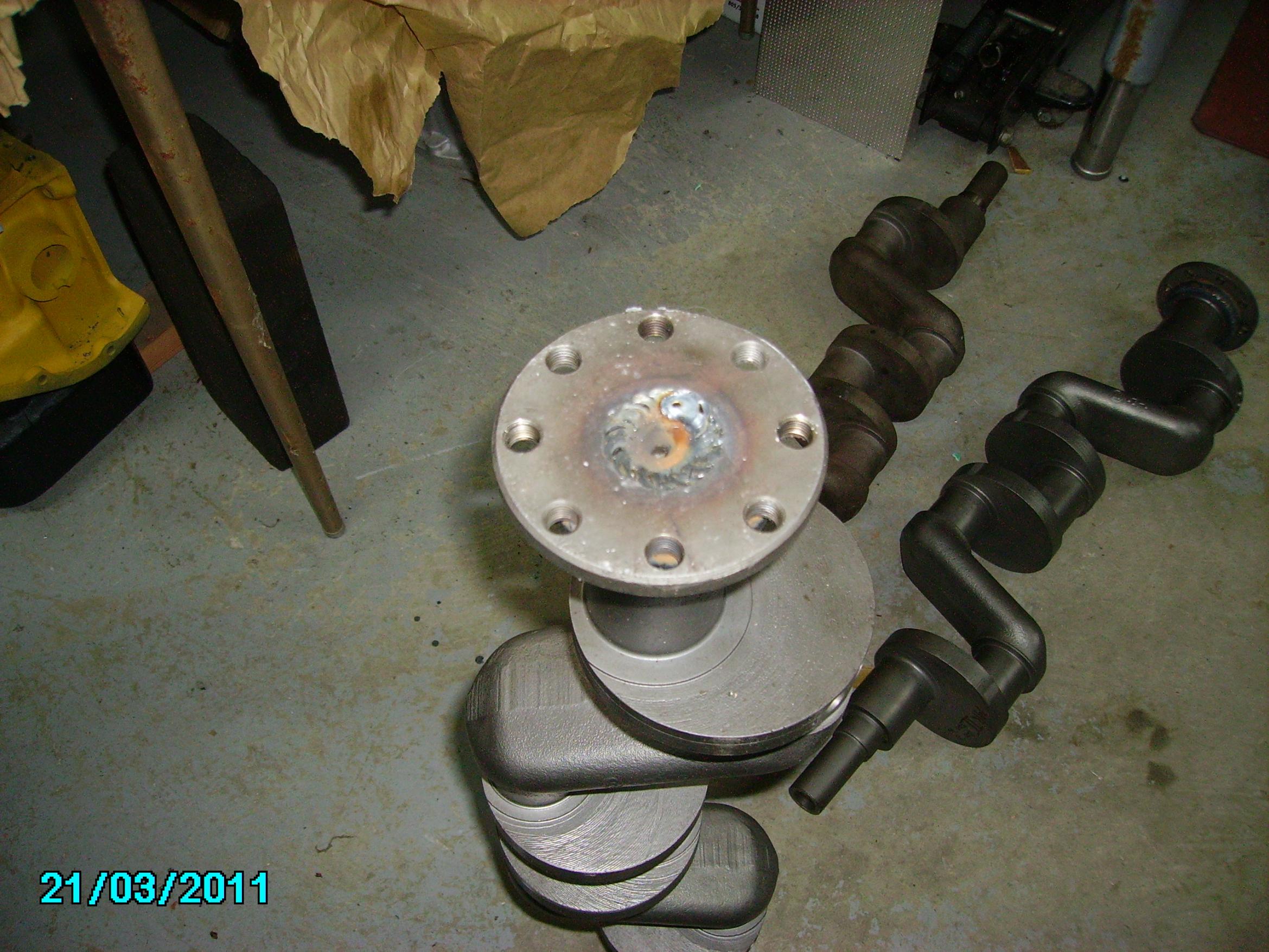

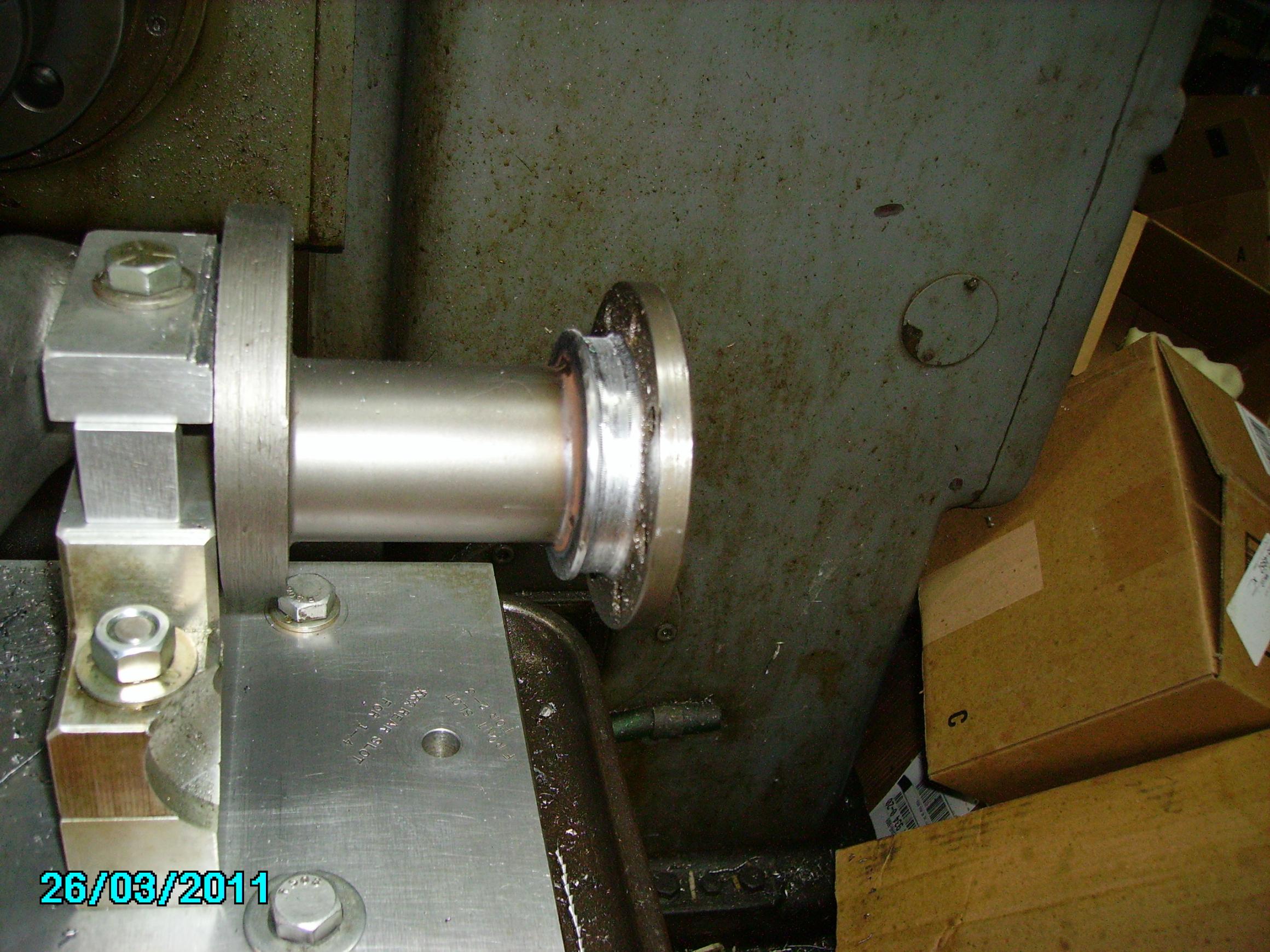

    Speaking of cracked cranks, here's some pictures of welded cranks. One had the flywheel flange cracked 50%! The others i welded were for preventative maintenance and also to use a 350 chev seal. Pat
  25. I have had 4 "B" blocks in the last few years and all 4 were/are cracked. All are reparable 2 had cracks between valve seat and cylinder that were successfully repaired and used with overheads another one has what appears to be older Ni Rod exterior repair but needs work in the valve chamber floor. The old sprint car block has a crack that was apparently caused when the hard seat was installed as the area is slightly depressed. "B"'s are thinner in the deck surface than the "A"'s. Ted from Ted's brake kits says he repairs them successfully with his wire feed welder. Jim Brierley has used someone closer to you in Riverside, Gregg Thompson PM me for contact information. Cast Iron repair spe******t.
