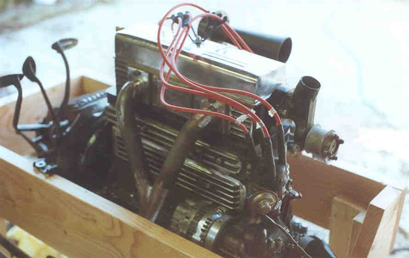

    Russ Tee needed some help with his pictures of his '27 with a chevy head, Pat

    Now THAT is a nice lookin' T motor! I want to do something similar on my new T engine that is in the works for my '26 roadster.

    BHT8BALL, great pictures of the T motor. Can you clue me in on the air filters? What are they and how do they preform. Very nice motor!

    Saxon the air filters are homemade turned from some recovered alloy stock foam filter and expanded mesh the work fine . head 28 chev my own conversion great fun to do valve cover stainless with beads rolled in . model a crank drilled and shortened full pressure oil via VW pump on back of the cam modern electronic dizzy in Boch front cover 12 volts no magnetshomemade manifolds was one hell of a lot of fun and aint that what its all about we not here to build belly button motors

    BHT8BALL thanks for posting pics of my tee motor looking forward to getting some of your well machined parts for the B motor in my RP

    Thanks RussTee.
    Belly button it is not!

    All the amazing things you've done with that motor and I ask about the air cleaner:D:(:p

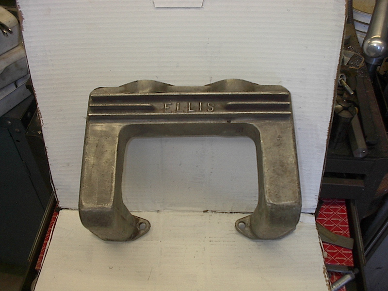

  28. Dose any one know what this manifold would fit? For reference the carburetor flange bore is 1 7/8's". The name on it is Ellis

    I was thinking the same thing:D
    but they are real nice air cleaners
    Nice look-in engine RussTee...
