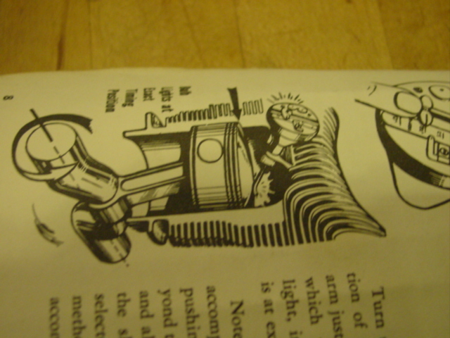

    I've a pretty good collection of old tools. This one is for aircraft but shows the idea. These use an offset foot to reach the piston. You turn the engine one way and mark the pully then the other way to the same piston height and mark again. The center between these marks is TDC
    I'll try to find and photograph the Automotive tool I've got.
