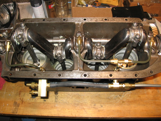

  14. Artiki
    Joined: Feb 17, 2004
    Posts: 2,014
    Artiki
    from Brum...
    My front & centre mains are fed to the underside too. Not had any issues so far. Got a pic somewhere...
    Yup, here goes.
    Rear main is from above.
  15. fur biscuit
    Joined: Jul 22, 2005
    Posts: 7,899
    fur biscuit
    the reason I asked, is that I went to a hell of alot of work to bend the tubing to come in from the top of the mains (through the original oil inlet) on my last T motor. It would be loads easier to come in though the main caps instead.
