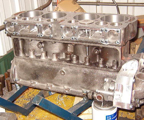

    Recently recived spy shots of T block for V4F cl***.

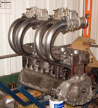

  16. noboD
    Joined: Jan 29, 2004
    Posts: 9,103
    noboD
    OOH OOH Baby how big are the sidedrafts, Rich?
  17. The37Kid
    Joined: Apr 30, 2004
    Posts: 32,916
    The37Kid
    WOW! Is that all porting or has there been a lot of internal welding as well?
  18. Crazydaddyo
    Joined: Apr 6, 2008
    Posts: 3,383
    Crazydaddyo
    Add me to that Wow above. That is some crazy porting.
    I'm ***uming that it will be running a Model A crank?
    The valves are huge!!!!!!
    Nice work on the oil pump / filter addaptation.
    I hope it goes like hell !!!!!!
  19. RichFox
    Joined: Dec 3, 2006
    Posts: 10,020
    RichFox
    I can say that there has been lots of welding for sure. The big valves was the reason for the spy shots. I don't know anything else about the motor. Be on the salt in Sept. and ask the owner.
  20. Crazydaddyo
    Joined: Apr 6, 2008
    Posts: 3,383
    Crazydaddyo
    With that intake set-up , it looks like it will be running in a Belly Tank?

  26. TV
    Joined: Aug 28, 2002
    Posts: 1,451
    TV
    Why would anyone go to that much work on a T block??? It's enough trouble trying to keep A's and B's togeather. I have never played with a T, am I stupid or are these blocks better than the rest of the Ford fours. --TV
  27. RichFox
    Joined: Dec 3, 2006
    Posts: 10,020
    RichFox
    I say again. Since when was any of this suspossed to be reasonable?

  30. Artiki
    Joined: Feb 17, 2004
    Posts: 2,014
    Artiki
    from Brum...
    Those webers look insane up there! Love it.
