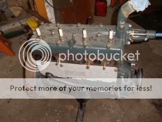

    HEY I don't see any pics that I posted yesterday... Is it just me?

    That head should be about 7.5/1 or maybe even 8/1. I'll bet it is at least 7/1.

    I could see them when you first posted , but they are gone now, I think your Photobucket account has ****ped somehow.
    This was the location of the pic which I saw when I first looked, but it is gone altogether now??? and so are all the rest...
    http://i416.photobucket.com/albums/pp243/bcchopit/Mikes engine/DSC00071-1.jpg

    Thanks farcus...
    Do you know if the head makes any power?

    OK, I checked and the fast four was built for the whole year of 1928. It appears to be about 90,000 cars built with it.

    It looks like a '28 Chevy head adapted to a T engine similar to the work of Neal Jern up in Redding CA. See His Ad Here: http://www.hotforhotfours.com/ads2.html
