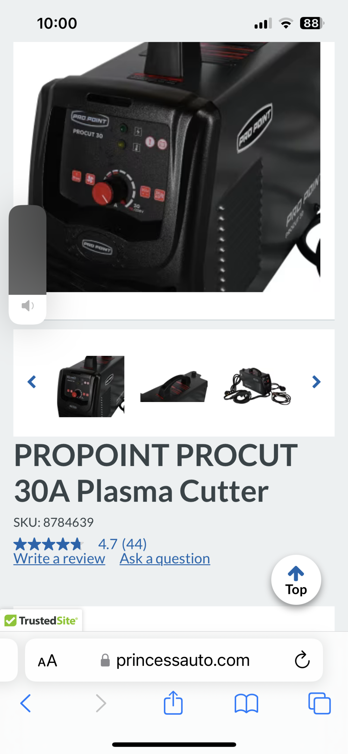

  7. We have the princess auto “ pro point “ plasma cutter in the shop got it for $600 some odd bucks 3 years ago. Duel voltage ( 110/220)
    Cuts 3/8 “ plate easily
    Consumables are always available and cheap .
    we don’t use it a ton but we use it, and it’s fine us well .
    im sure it’s made by the same off shore company as all the other knock off brands .
    as long as consumables are readily available to you , buy one . Great tool to have in the kit when required .

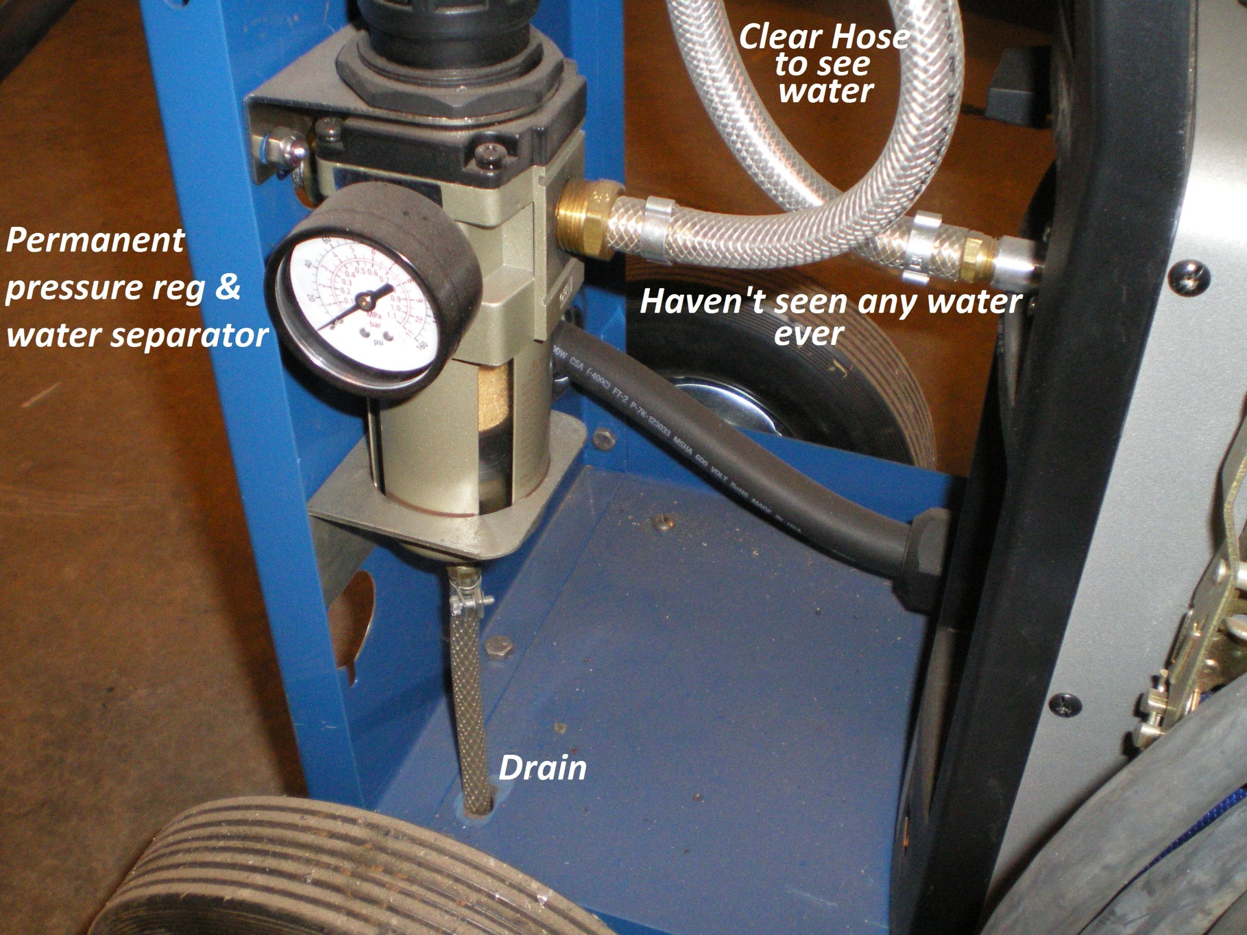

  22. alanp561
    Joined: Oct 1, 2017
    Posts: 5,680
    alanp561
    Nice looking setup, what brand water separator did you use?
    ekimneirbo likes this.

  26. alanp561
    Joined: Oct 1, 2017
    Posts: 5,680
    alanp561
    Thanks.

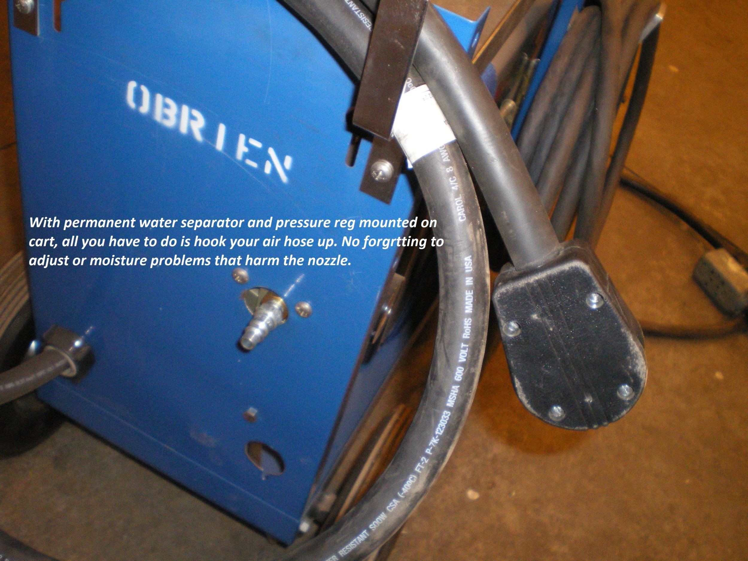

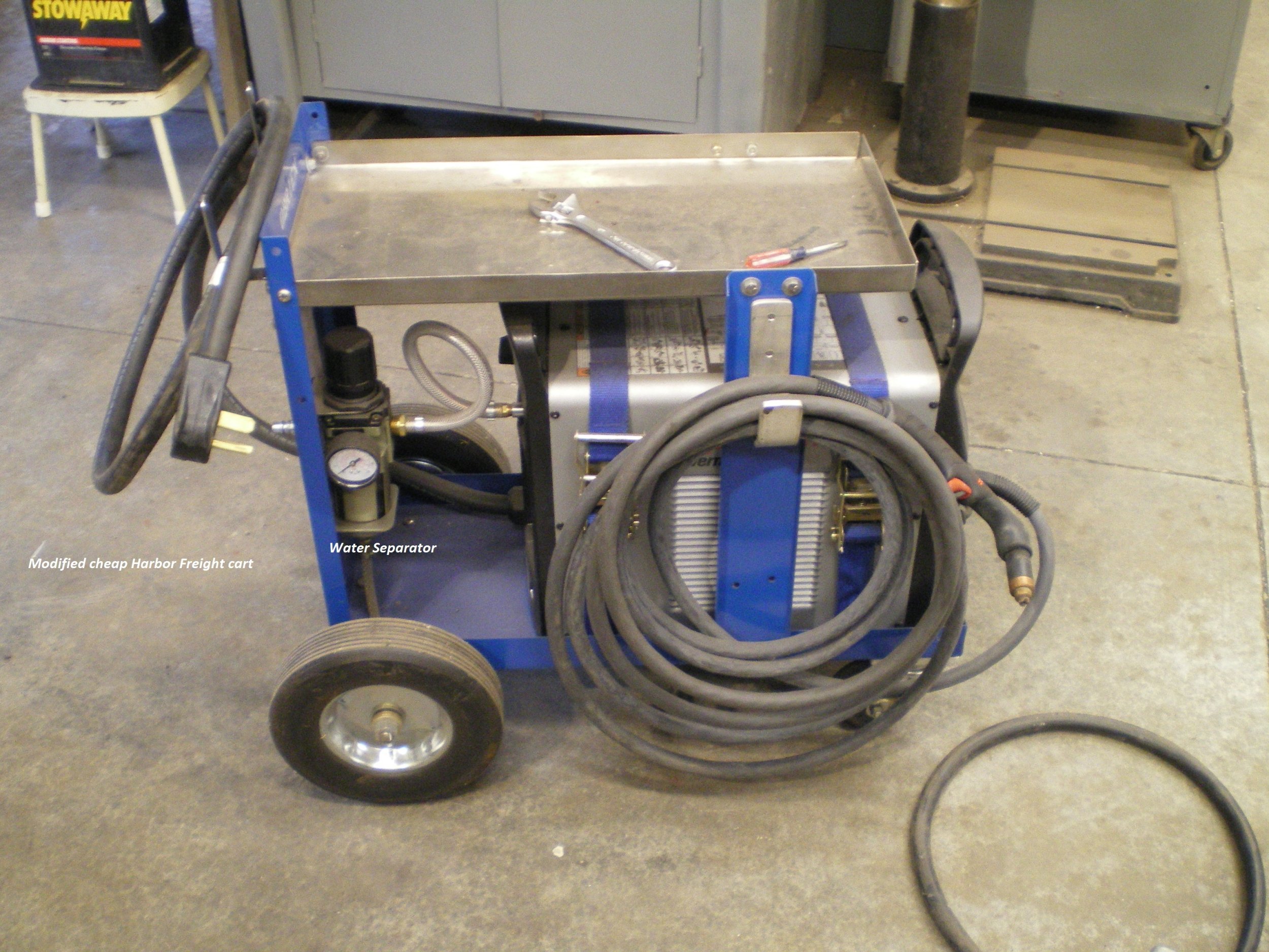

    I have a water separator on my air compressor and one mounted on my plasma cutter, and I drain the compressor tank every day when I turn it on.
    The air into my plasma cutter is clean and pretty dry.
