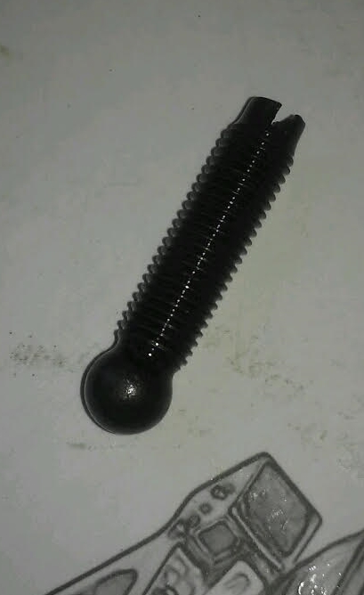

    After my father p***ed I inherited the Ardun project and its now progressing steadily. However, we are missing one adjustable screw (photo) and would appreciate any info regarding.
    Time zones are a killer and phoning is somewhat a pain but if needed, I will do it.
    This may very well be a stock item I can purchase locally as it would seem logical to use a standard part rather than re inventing the wheel. Does anyone have a clue if this is true?
    If not, does anyone live near Don Ferguson and be willing to shoot one to me, of course I will pay costs. Thank you hot rod world.

    Perhaps if you provide dimensions, we might be able to figure out what it is? Outer diameter of the threads, and the length.

    What's the thread, length, and ball size. They didn't invent the wheel, I bet it's a stock item and I may have one.

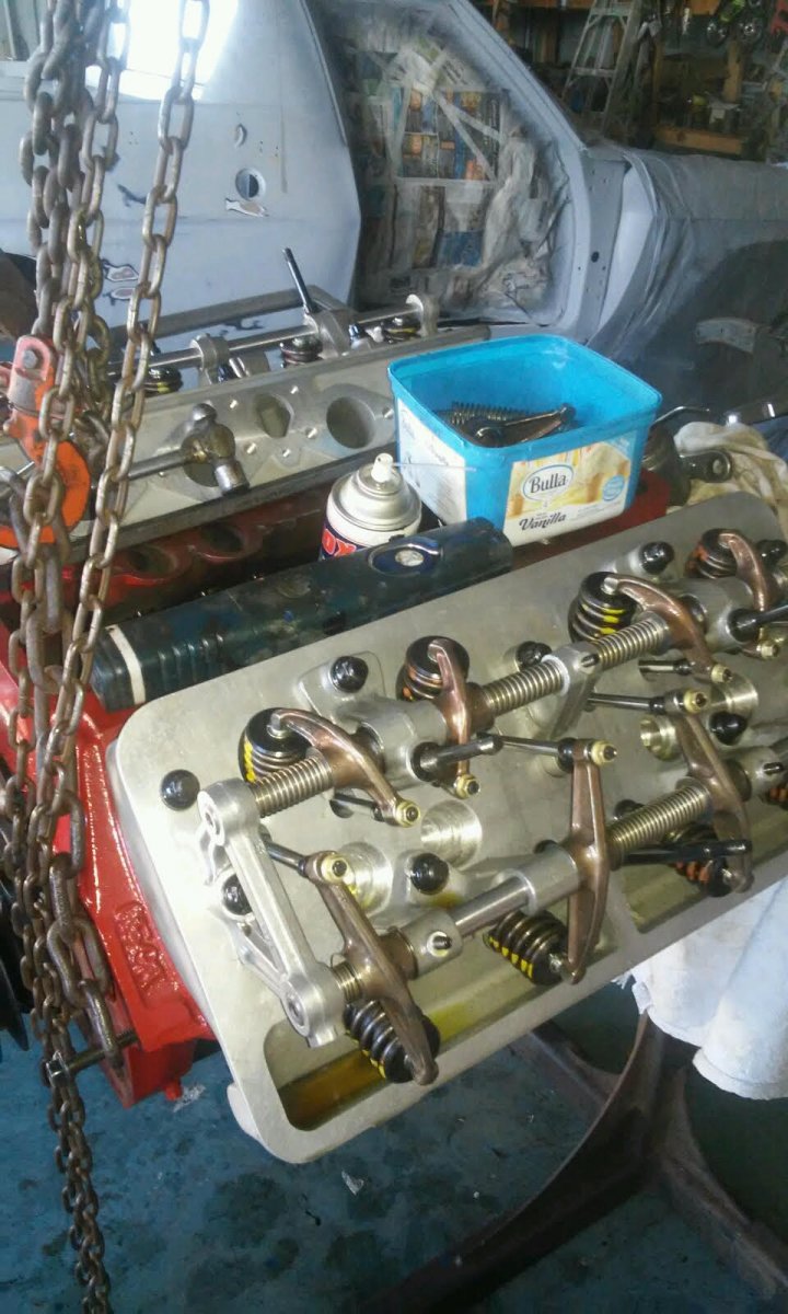

    Well this was as of yesterday RuFFDaWG. It is a freshly dipped and magnafluxed 47 ford non relieved block that I bought from Mike Davidson. I installed the forged crank and new pistons and rings, and bearing supports and had it all balanced. Put in the mellings oil pump and the new oil pickup and now we have the heads finally coming together. As i mentioned elsewhere, I have just purchased the 4 barrel intake from H&H and will run a holley wiht a C4 auto. Check out the other pics I have posted. Cheers

    ...and after all that, we still don't know what the thread size is :)

    My guess 3/8-24 and 5/16 ball...I got some out of Bill Mitchell for roller rockers I made for my pulling tractor.. http://www.theengineshop.com/

    Had to take a ride to get the thread size mate. Didnt have it on hand. The good news is that I have sourced one from Don Ferguson and just waiting his bank details. Having said that, the thread dimensions are
    1 and 7/16 length
    5/16 thick thread
    UNF

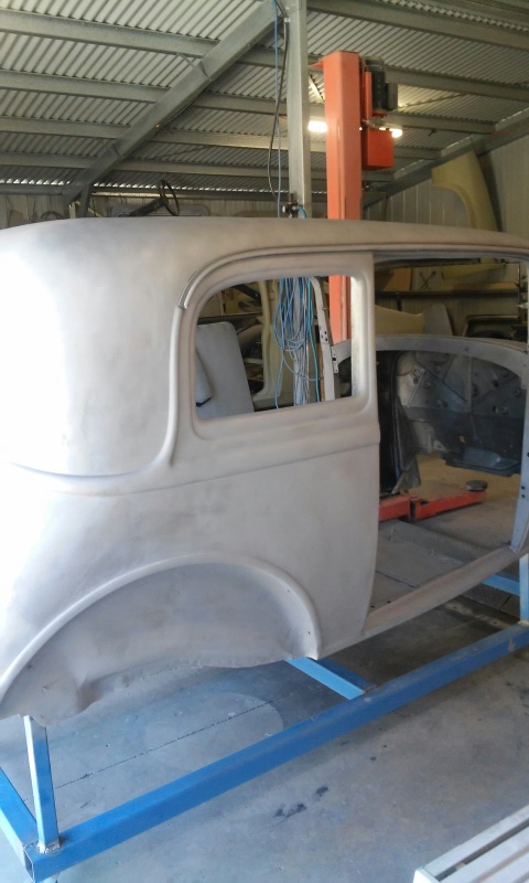

    this is the body at present. All the fenders and firewall and all other body panels are straight and in final primer ready for fit to ch***is. I am waiting on the engine guy so we can fit the running gear in the ch***is and fit the front section of the floor. Straight as an arrow. Needs to be if its black.

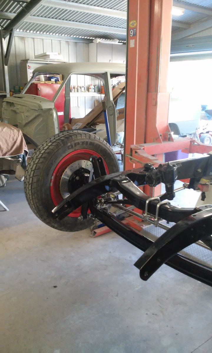

    Some more pics of various stages of the build. You can see all the parts on the shed floor, then the bottom end build with the forged crank. Also the ford big brakes the day they arrived. My lincoln diff striped for paint. My front end with new rotors. I also onstalled a howards cam and i have the spec sheet if anyone has an interest.

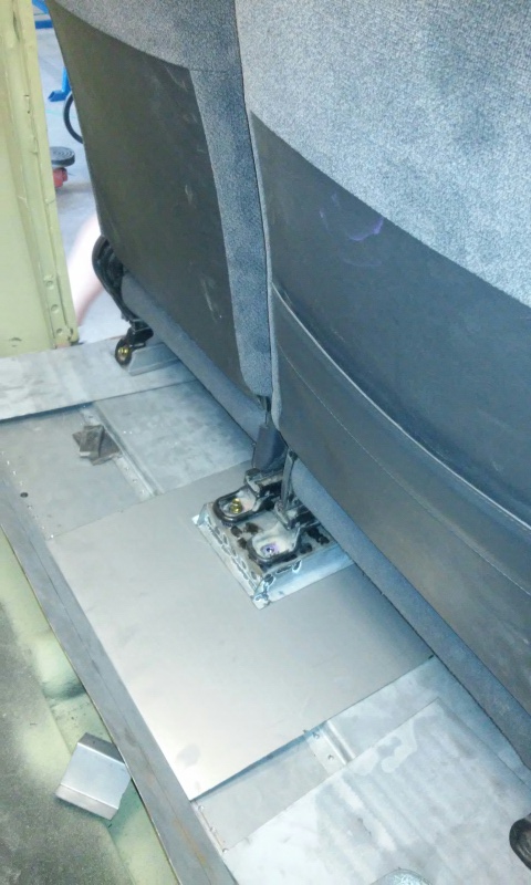

    Last few photos for a while. I uploaded the howards cam specs. It may as well be writen in chinese as it would make as much sense. Pretty sure from memory my Dad got this from Flathead Jack on his recomendation. Also posted the finished work for the rear seats and set up for the front pair. Belts are now installed.
