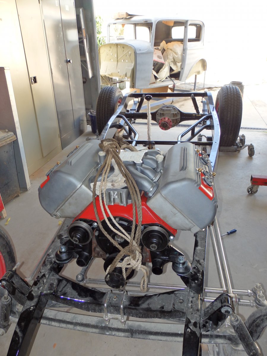

    My Ardun powered engine was married up to the 32 ch***is yesterday and is a real nice fit. Was a mammoth learning curve getting this package together. Its not quite ready to be fired up just yet but it will not be too far off. Its a non relieved 47 block which was checked, line bored and honed etc and then the forged Flathead Jack 4inch mercury crank was installed. Running a Howards Cam and an Austin intake and a spread bore holley.

  3. steinauge
    Joined: Feb 28, 2014
    Posts: 1,507
    steinauge
    from 1960
    Beautiful engine!! What is that strange thing bolted to the back of the engine?
    57JoeFoMoPar and Brom like this.

  17. 60 Special
    Joined: Sep 8, 2007
    Posts: 321
    60 Special
    from Omaha Ne.
    Beautiful setup, I'm glad it is safely sitting between those rails! The rope/sling lifting device gave me some real concern though, when I saw it looped around the front crank pulley and then around the trans in the rear. Not so much because you used a rope, as in early rigging that was what was used to lift heavy objects. My thought was how low the pick point was on the m*** that you were lifting, meaning the center of gravity is above that point! It is possible if things don't go right, the load can shift and what was once on the topside will swing and end up on the bottom. In the mishap that takes place something can hit the floor, first thing would be those beautiful rocker covers! Always lift a heavy object with the m*** of weight below the pick point. I'm just an old rigger who has seen things go bad, not trying to be critical! Again beautiful engine, congrats!

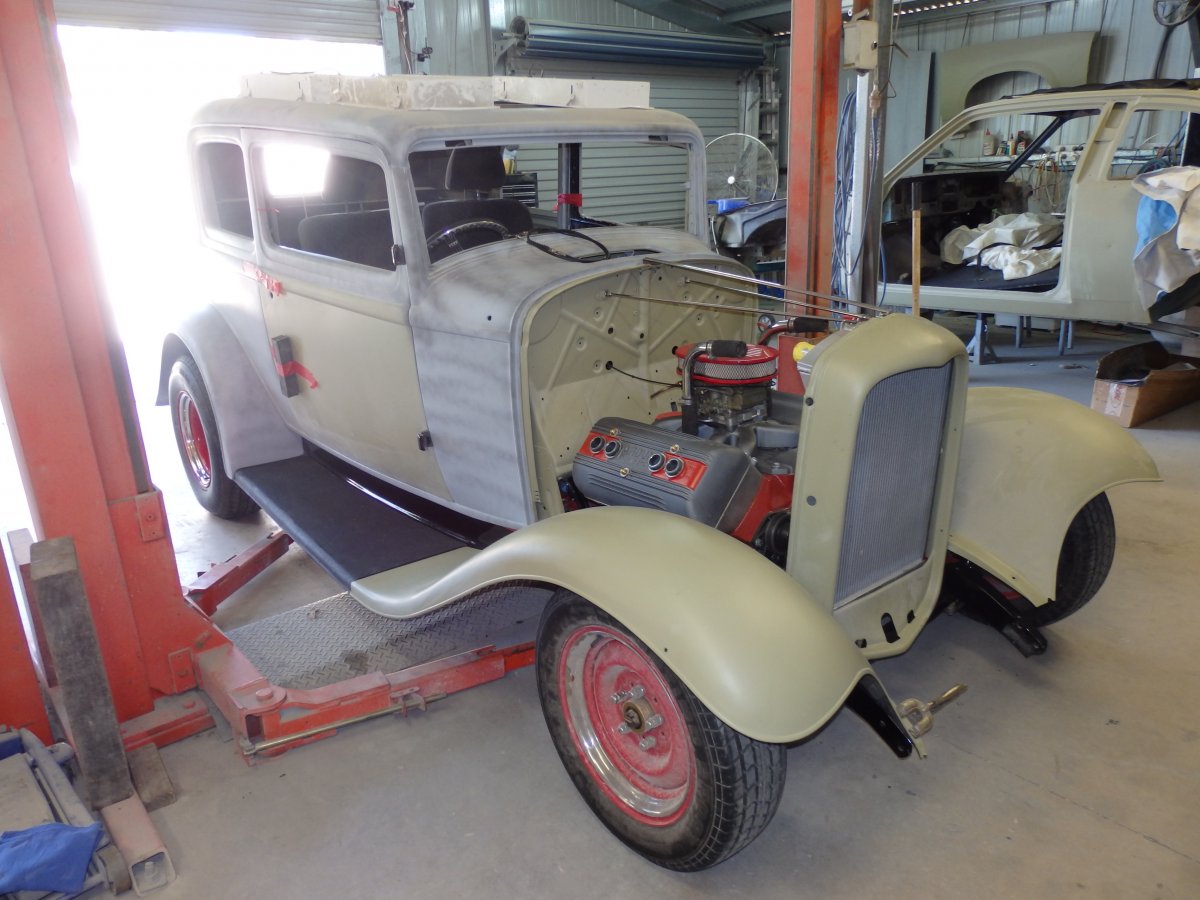

  24. Brom
    Joined: Jul 7, 2016
    Posts: 49
    Brom
    Time for an update. The body is now straight as an arrow and the fitting up has begun. Everything is lining up quite nice and it really looks fantastic. The rear stance is a little high at present but im hoping it settles in time or I may have to have the springs re set. Slow and steady but well worth it.
