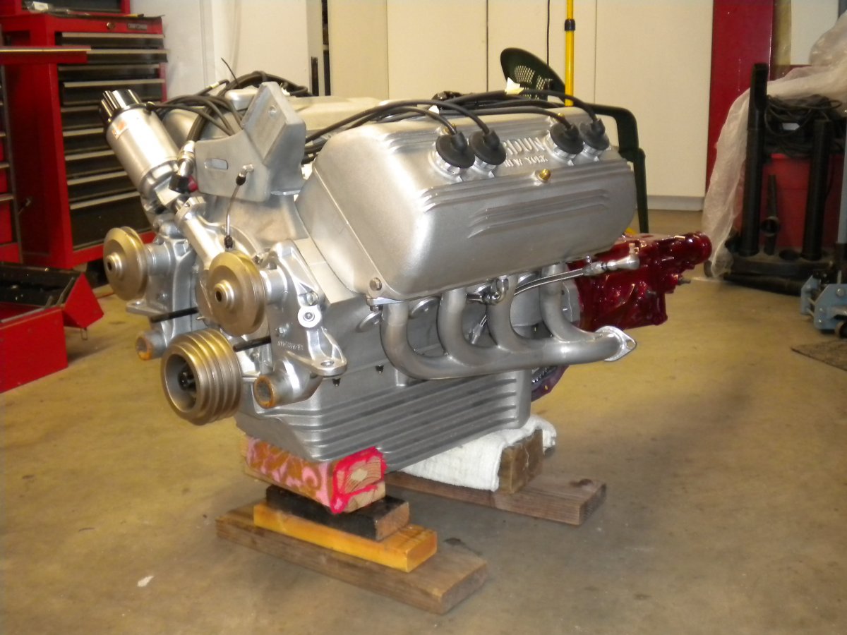

  8. deucendude
    Joined: Oct 31, 2008
    Posts: 704
    deucendude
    from norcal
    yes! Ferguson block.
