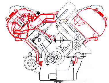

    let me preface by saying that I am not a fan of the flathead and never have,but that doesn't stop me from being curious,when you convert to ardun heads what happens with the valves in the? I have searched google but didn't really find a suitable answer. so let knowledge of the hamb school me
  2. Nothing, the valves get moved to the heads. Look where the pushrods end up.

  4. 296ardun
    Joined: Feb 11, 2009
    Posts: 4,708
    296ardun
    The holes where the in-block valves were are where the pushrods go to operate the now-overhead valves...

  6. studebaker46
    Joined: Nov 14, 2007
    Posts: 727
    studebaker46
    thanx for the quick replys after looking at the drawing it makes perfect sense thanks guys

  8. FrozenMerc
    Joined: Sep 4, 2009
    Posts: 3,565
    FrozenMerc
    Why do you have to plug them? The Ardun heads have all the necessary porting in them, the only thing to worry about is the small amount of oil that will leak around the guides and pushrods. The old flathead ports are now just "weight reduction holes". That said, there is an under manifold (valley) plate that supports the generator and fuel pump / breather stand, and most people put plates on the exhaust holes to clean up the side of the block.

  9. RichFox
    Joined: Dec 3, 2006
    Posts: 10,020
    RichFox
    The stock intake ports would now be a direct p***age from outside to the pan. If you don't want **** dropping into the oil, a plate as shown is an easy fix.
