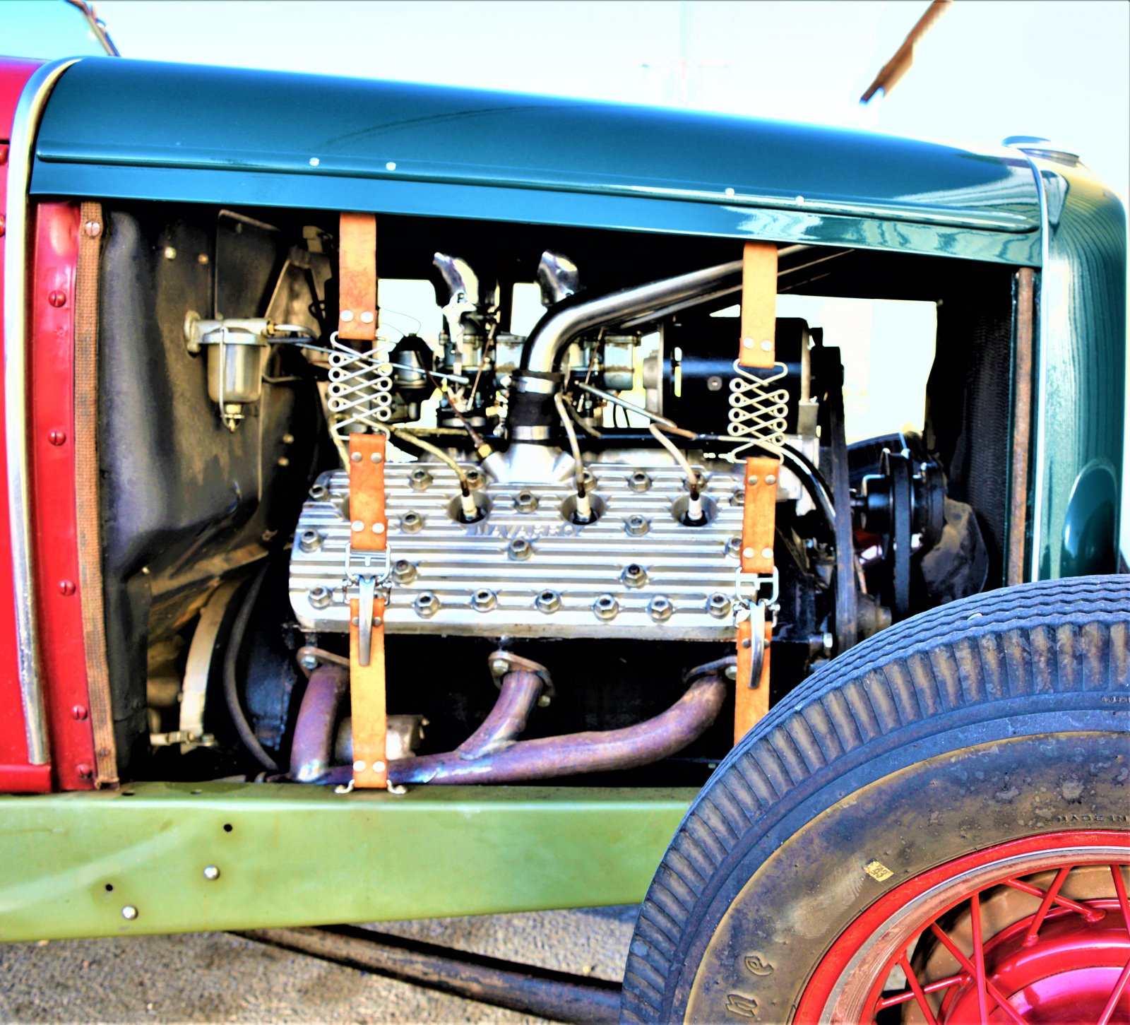

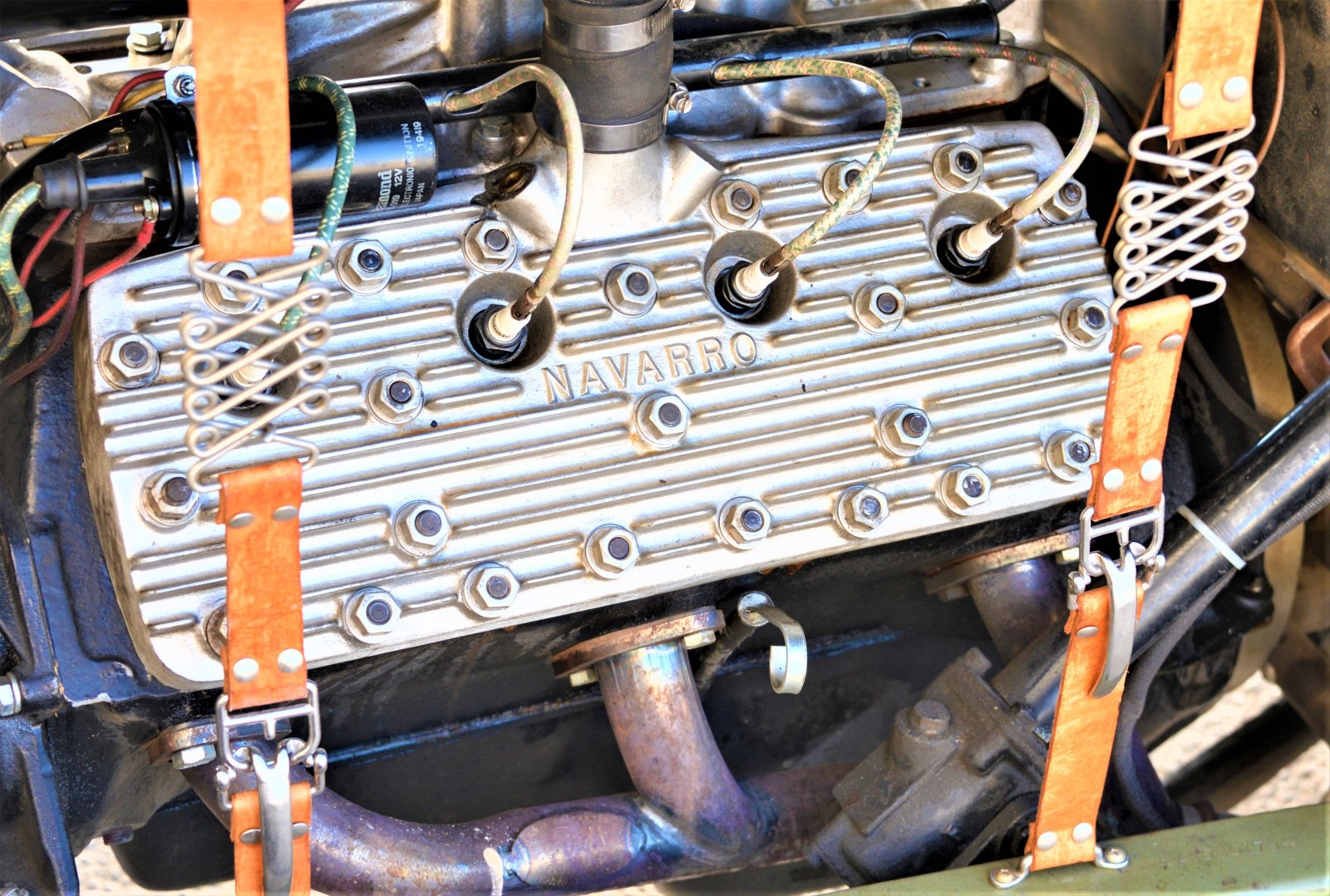

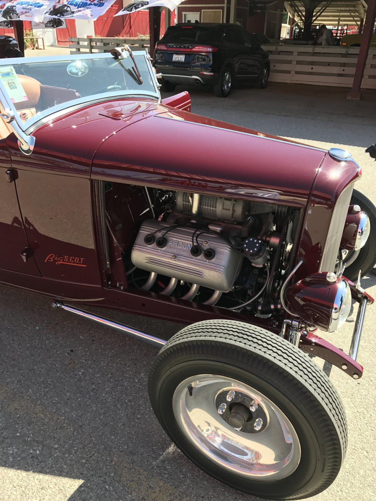

    As cool as Ardun heads are and as cool as Ford Flathead engines are as well, and your focus of not having anything other than
    "HENRY" parts for your car / build.
    Are you going for the look of the engine or the semi practical, functionality of the Ardun head set up ?
    I agree with Hitchhiker, keep searching for a good block, that would be money well spent first, in my opinion.
    I posted a few shots for you to consider, personally, I like the look of the Navarro heads over the Ardun set up.
    Your results may vary.
