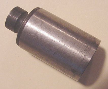

    One of the few things I regret selling is the ARDUN V8-60 I had years ago. This is a NOS lifter that lives in the top draw of my tool box. Bob
