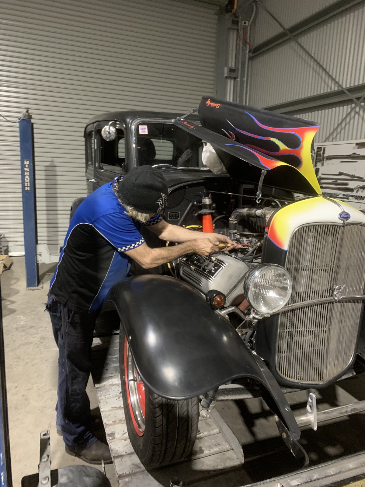

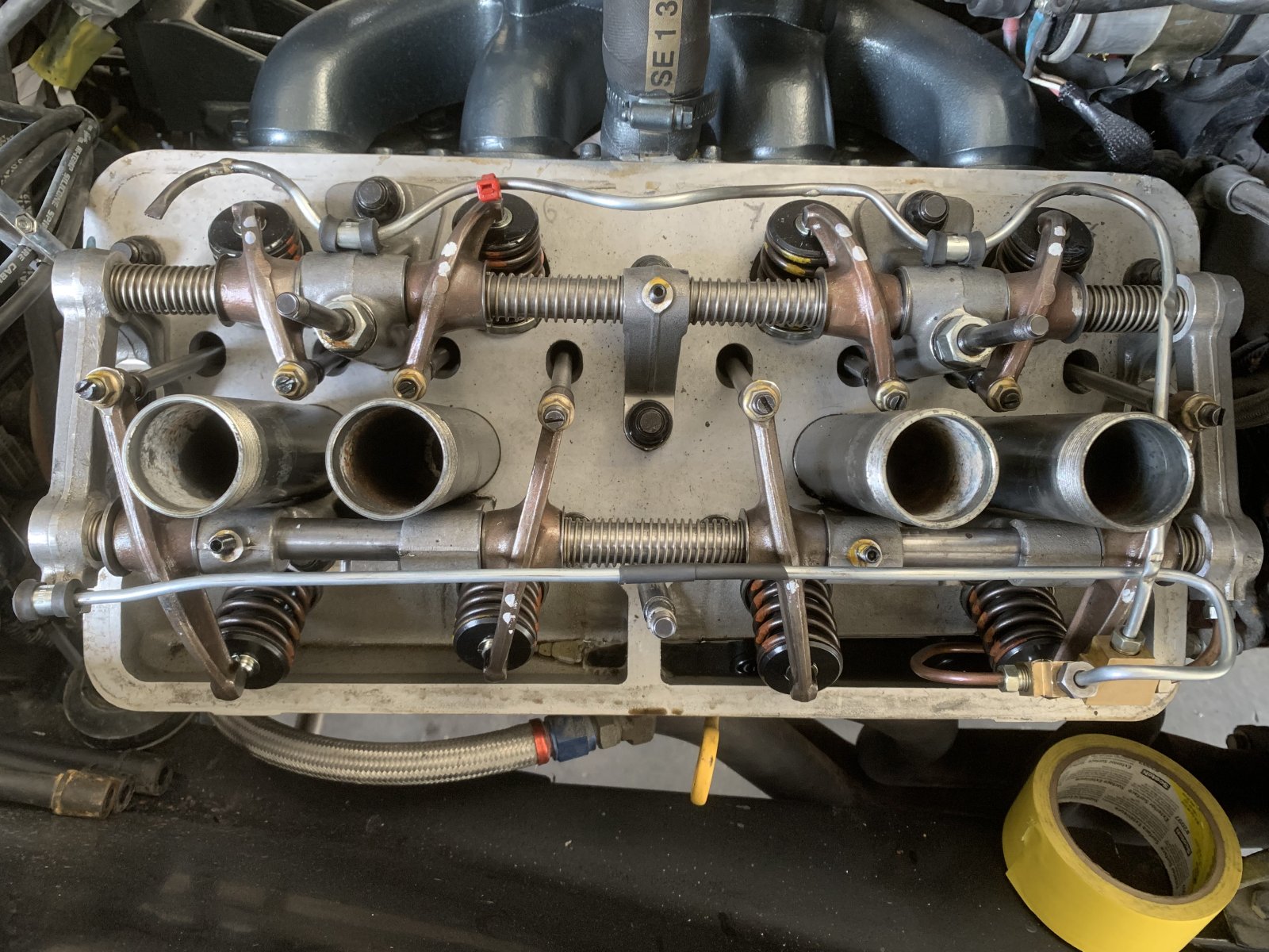

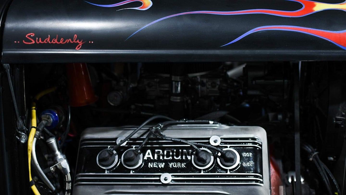

    Added an additional exhaust tappet oil line to the heads and we removed all tappet noise completely with the addition of doing a lash set up using the dial not feeler gauges…they lie. Runs insanely well. Naturally aspirated 239 flatty. Austin intake with a 570 vac secondary holley, howards stage 2 cam, mercury forged crank from flathead jack, mellings oil thru a filter and the Don Orosco 1002 series heads. Running it thru a 3.25 9inch and a C4 auto. A custom set of headers by Beach Ball at Pro Street. Engine built by Austech Engines. Some kind of engine savant.
