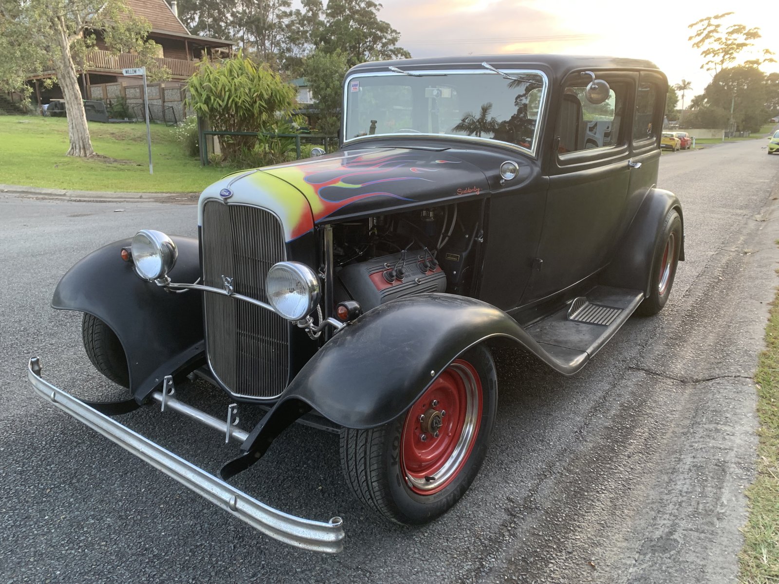

  4. swifty
    Joined: Dec 25, 2005
    Posts: 2,557
    swifty
    Hey @Brom doesn't look too rural to me - sealed road and gutter LOL
    BTW there are 4 Arduns in Castlemaine. What is the history on your Vicki?
