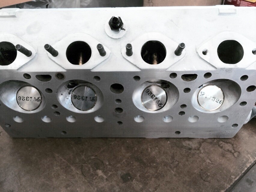

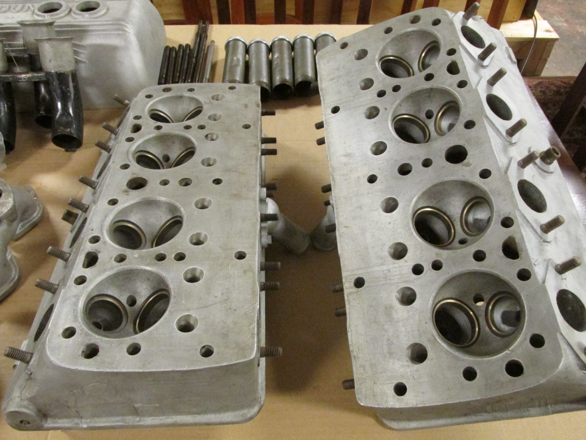

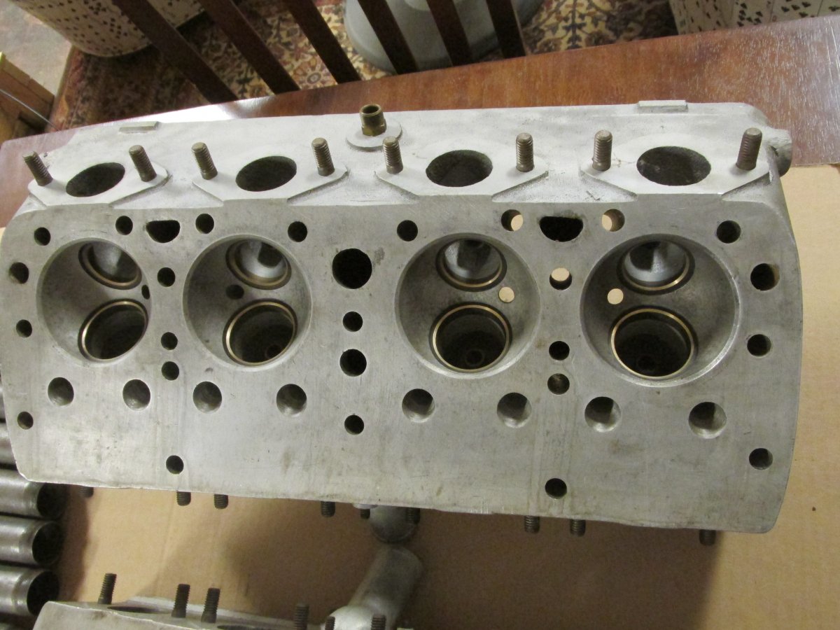

    I am getting ready to build an engine for a NOS set of Ardun heads. The heads have the stock seats,
    as seen in the pictures, and I have concerns about them falling out as the temps change on the two types of metal.
    I am trying to get advice from someone who knows how to fix this, or find someone to send them to for valve work and installation.
    I will add more pics and info as needed

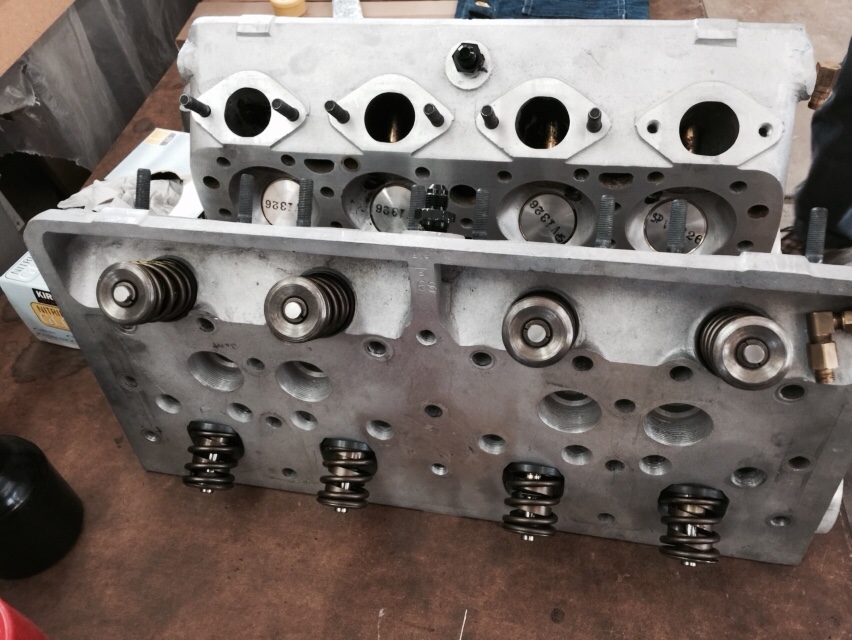

    I have a 1st Gen set of heads that were recently rebuilt and are running quite well in ‘53 Ford with an 8ba and AOD. Here’s what I had done:
    1. New Guides
    2. New Seats
    3. Modified Chevrolet Valves
    4. Machined heads and put in adaptors to put the spark plugs at the face of the combustion chamber rather than deep in the spark plug chamber.
    5. Put seals at the bottom of the Spark Plug tubes to keep oil out of them
    There is a lot to building an Ardun. Suggest you do a lot of research and stash some money as it is expensive.
