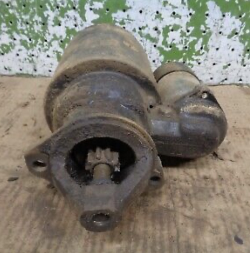

  7. squirrel
    Joined: Sep 23, 2004
    Posts: 59,928
    squirrel
    If it has 3 bolts around the flange of the starter, where it bolts to the bellhousing, then there's really only one starter that will fit. It also fits standard trans trucks from 55-72, so it's easy to find.
    Pictures of your car's engine/bellhousing really help.
    The turboglide starter bolts to the block, and wont' fit. The powerglide/standard transmission starter bolts to the bellhousing and will fit.

  16. Mr48chev
    Joined: Dec 28, 2007
    Posts: 35,969
    Mr48chev
    selohssa likes this.
