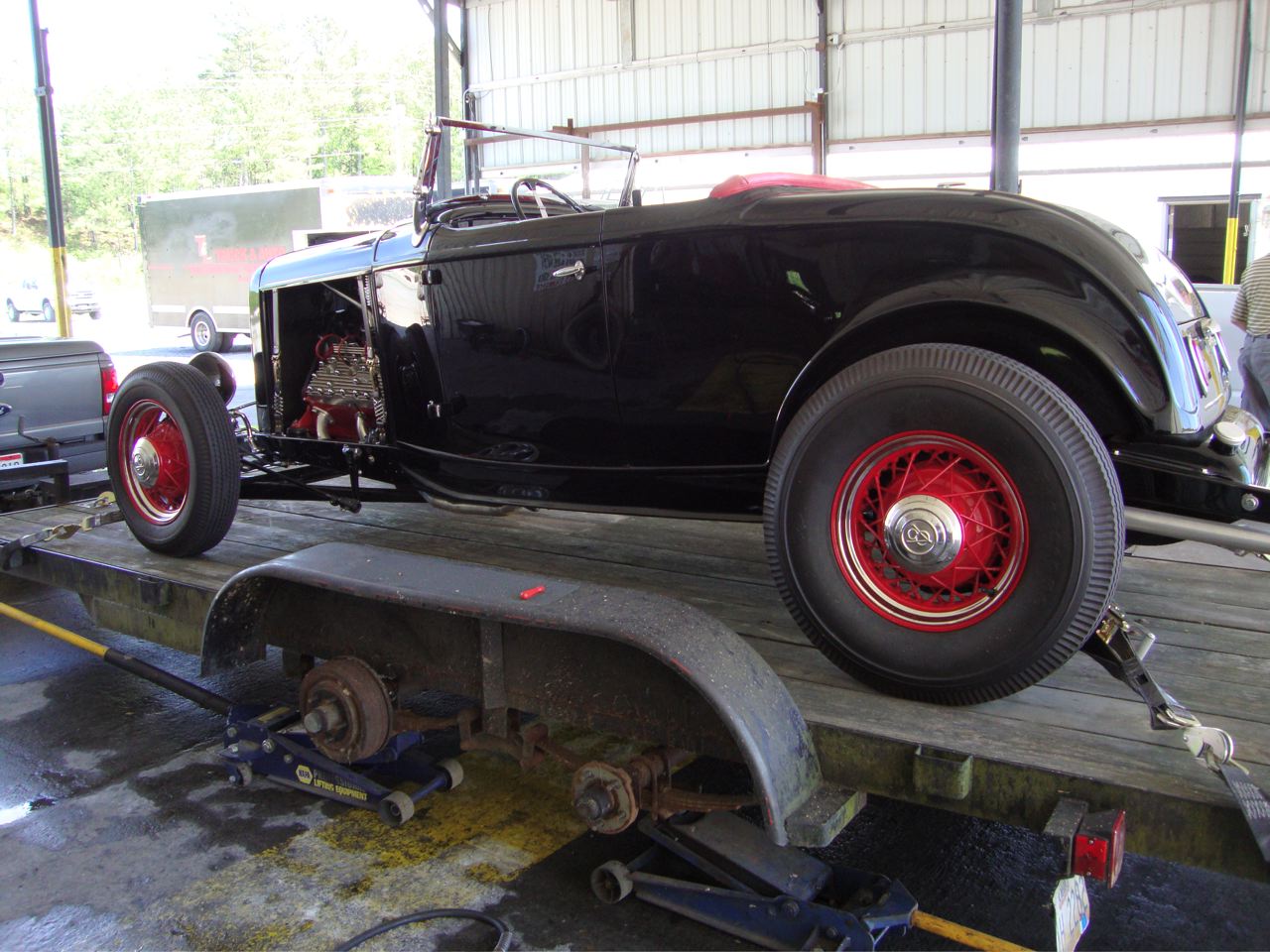

    I borrowed a friend's trailer last spring. It was 10 years old, but had very little use, and the radials looked fine. I checked the tires repeatedly on the way to Atlanta - they ran cool, smooth, and stayed inflated. The return trip with trailer loaded started fine. I checked the pressure, 32 psi, when we left Atlanta heading north, and half and hour later when we stopped for breakfast, and all was well. We no more than got back on I75 when one tire disintegrated - no warning, no thumping, nothing. The entire tread literally vanished leaving only the side walls. Luckily I was looking in the mirror and saw it happen. I still wasn't a believer (read cheap), so I had a used (I feel queezy as I write this) tire put on the wheel and off we went. Fifteen minutes later, another tire started shaking. I put 4 new trailer tires on my buddies trailer and we made it home with no further excitement. Don't take the chance with old tires. I can't believe how stupid and lucky I was.
