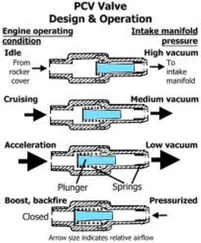

    I like this illustration of how a PCV valve works. The color helps me note the plunger position with less fog in my pea brain. It shows how the intake vacuum is the signal that varies the position of the plunger in the valve which controls the flow.
    I don't mean to come on like an expert. I'm not. I just had to get a good working grip on the subject back about 15 years ago when I was messing around with turbocharged, Mopar 4-bangers, cranking the boost up, doubling the horsepower and quadrupling the crankcase blowby.

    Taking into consideration info pic above modifying a stock PCV with a set bolt/screw only changes the plunger seat at idle, after that the excising spring rate operates as stock. You have only modified the operation at idle.....................................

    That is correct, the screw in the top will only help you dial in the correct amount of pcv action during idle conditions. If the pcv valve is not capable of evacuating the crankcase pressures under cruise or acceleration, than it requires a larger body with additional flow capacity. It would be had to make that adjustable. You could start with the largest valve available and somehow modify it to close off part of the orifice I suppose.

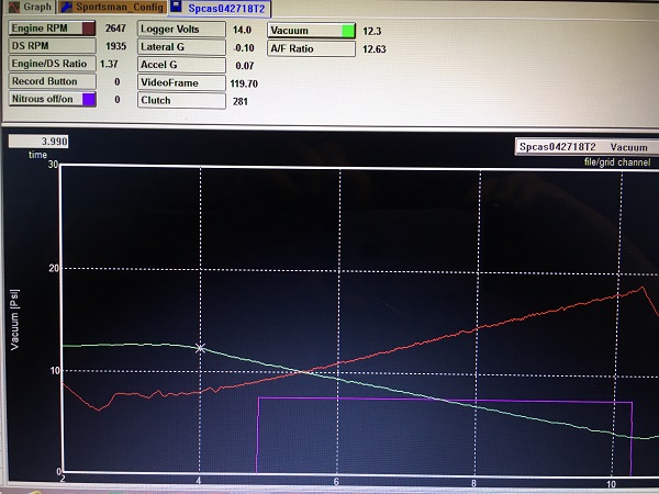

    I use the screw adjustment pcv modification on a sealed crankcase 355sbc around 500hp, no breathers at all. I also have a data logger on board that monitors crankcase vacuum.
    At idle, the pcv pulls 8-10"Hg in the crankcase.
    2500rpm 55mph 4th gear cruise it pulls about 15"Hg.
    Here's a graph of crankcase pressure during a 3rd gear WOT pull from 2500-6200rpm.
    Red line engine rpm.
    Yellow line crankcase vacuum.
    Blue line WOT switch.
    Crankcase vac starts out at 12.6"Hg. By the time the engine reaches 6200 at the end of the 6.64second long WOT pull, crankcase still holds 4"Hg of vacuum.
    The PCV valve is installed in the top of a homemade separator tank that's made out of glued together pieces of pvc pipe...
    There's a large dia standpipe that comes up inside the tank from the bottom, it's attached to a large check valve to act as a safety vent in case for some reason the crankcase ever sees positive pressure. There's also a small drain port for the outer chamber, most I've ever gotten out of it was about a teas****. I might check it about once a month during the summer. No baffles inside the valve covers, large dia upward angled fittings/hoses keep air velocity to a minimum which helps prevent pulling oil into the pcv system.
    The car also has a nitrous system and an electric vacuum pump, neither were activated for the above test pull.

    That is some very interesting information. I'm still not done absorbing it, but I'm thinking that a graph with pcv vacuum plotted against crankcase vacuum could prove informative.
