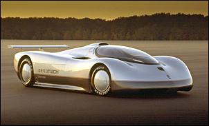

  14. 1986-7 Oldsmobile Aerotech
    1988 Oldsmobile Aerotech
    The 1988 Oldsmobile Aerotech, an experimental high-speed vehicle incorporating the latest in performance technology, was driven by three-time Indy 500 winner A.J. Foyt to a world closed-course speed record of 257mph (413 km/h). It was powered by a specially-prepared turbo-charged version of the Quad 4 engine. The Aerotech body was designed by GM Design staff and is one of the sleekest vehicles yet developed for a GM car division. The design of the Aerotech includes the capability of adjusting underbody sections to control the distribution of downforce, front to rear.
    uh... that'd work... and i'll take the moon discs too! :D

    Gemini EFI
    BUT, There was not one piece of the entire engine that came from Oldsmobile in the the final version of the engine!!!!

    nexxussian
    I have always wondered about that (the running joke here was the paint on the block was the factory color, and that was the 'production base').
    So not even the Rocketparts beefed up block or the crank forging blank or anything?

    tjm73
    Wow. I was in my late teens when that car was all over the magazines. As my memory recalls, they sure made it sound like the car was powered by the same engine as the street cars. Smells of deception to me.
