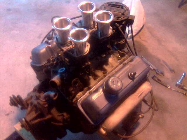

    the setup i'm thinking of running in my 34 ford p/u.229 chev v6 with a couple of webbers on top,may try squeeze a third on there(with smaller distributor),or a couple of strombergs.with a 3 or 4 speed.

    now that looks nice.

    3.8? whered u get the intake?

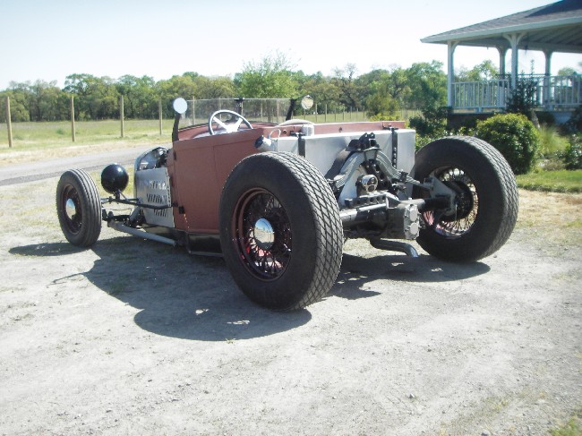

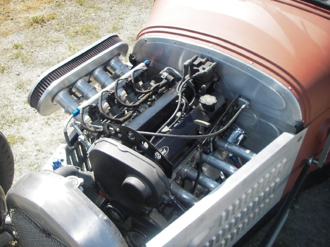

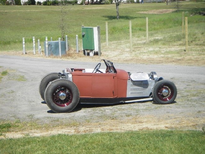

    I did it and pics are attached! 2 liter Ford Zetec, T5 ******, Hildebrand quickie, 1400 lbs, Hilborn electronic injection. I have not checked the mileage, I did it becasue I wanted a 4 cylinder and could not afford an Offy!

    Sweet HotRod !
    Do some mileage checks for us and report back, OK ?

    buddy put a Zetec in his VW Vanagon Camper... thing can dam'n near pull the front wheels off the ground now

    Anybody that says this isn't a hot rod can kiss my ***.....damn that's cool! What kind of power does it have...and if you don't mind me asking...whats it cost to do put a motor like that together?

    I got the motor out of a 2000 Ford ****** ZX2 which was stick shift so it had a flywheel and clutch, had to change the disc to match the T-5 inlput shaft but using the stock pressure plate. The engine has 20,000 miles on it and pushes 175 psi compression in all cylinders. Paid $750 for it and $375 for the T-5. Biggest cost were $425 for the adaptor bellhousing, and then pretty big bucks for the Hilborn electronic injectors and the ECU, about $3000 total. But you could easily do a set of Weber side drafts for less than 1/3 of that.

    wow...thats very reasonable for an exotic looking setup...doubt I would do the injectors but the rest maybe! Now the real question is can it kick a V8's ***? (I just had to ask!)

    the carbs are just dummied up on there at present.the current manifold is a edlebrock 4 barrel.i'll either make an adaptor or a new manifold if adaptor looks too high.

    That is very, VERY, cool, Rex!
