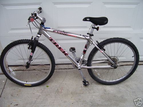

    Here's My Efficient Hot Rod ... The fuel I am using, a mixture of several brands of cheap beer, mexican food, and pizza ... is causing a problem with the EPA. Something about excess methane gas in the exhaust. I'll have to have that checked out.
