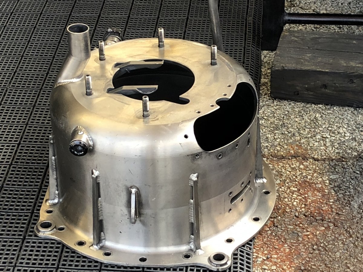

    Clutch cans (bell housings) have come a long way since the 60's, I straddled this aluminum one back in the 80's for a few runs. It did have an 1/8" steel liner. 2012-08-31 121849.jpg
  2. thirtytwo
    Joined: Dec 19, 2003
    Posts: 2,652
    thirtytwo
    I saw all that bull **** on 1320 and some face book posts too . I say even if you did everything wrong that bell housing should not have unraveled and opened up like that, I bought a QuickTime before and liked the fact it was more compact than a Lakewood and easier to build floors around but after seeing this I’m thinking NO more..
    QuickTime seemed quick to point the finger too , it tore right at the weld which seems like a bit of a production failure on their end if you ask me

    Any time the purchaser drills or modifys the "can" as is, it voids the SFI cert, Proper Tech inspection would have caught it. This is a Browell can of similar design with access hole properly in place. The piece removed from the can is welded to the inspection cover so that it is smooth inside and nothing to grab on to.

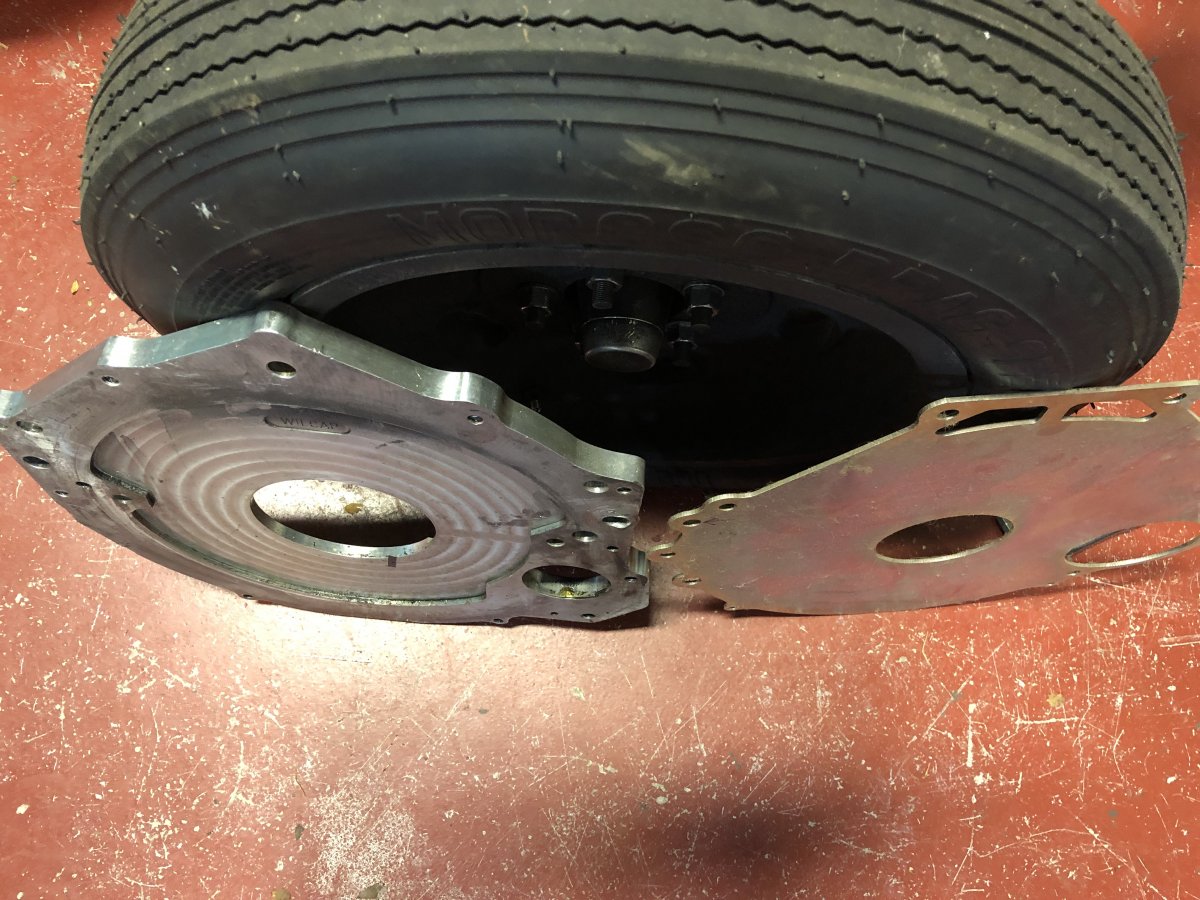

    The missing block plate would have added a lot of strength if it had been used. It has bolts all around it that helps keep the front of the can from ballooning open like yours did. Kind of reminds me of someone using shoulder straps but omitting the lap belt. Just isn't near as strong and at some point you are coming out of the seat in a most violent manner!

    Personally I think the root cause of the explosion may have been cracks in the aluminum pressure ring near the base of lift lugs. It's pretty common to see cracks there, as the aluminum rings flex and fatigue. I think one of the cracks in the pressure ring let go, and the wide openings in the Long cover let a broken section of the aluminum pressure ring escape and wedge between the spinning cover and the opening in the bell. That caused the PP cover/bolts to be ripped apart which in turn caused the can opener effect on the bell.
    Here's a pic of the crack location (highlighted in yellow) i'm talking about...
    I'd be real curious to see if the pressure ring has similar cracks like those above.

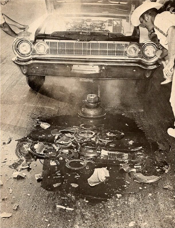

    About 60 years ago, when clutch/flywheel protection was mandated for "compe***ion" cars, some strips required 180º (top half) 1/4-inch steel shields. We had one on our roadster. When the clutch/flywheel let go, it cut the "foam aluminum" transmission adapter out, dropped the engine down with the headers resting on the draglink, heading the car off the strip at Fontana. Fortunately no harm done.
    Earlier that year I was peppered with the shrapnel from a small-block Chevy g***er at Riverside. I guess crowd protection came in second place.

    B2A93A75-A94D-4014-90F1-76BAF6530538.jpeg 951019AF-6881-4DBE-81F9-06AB5BF64DDD.jpeg
    I read this also but wouldn't it be more accurate to add the torsional load of an engine under power twisting the transmission bolts as the explosion occurs? These things don't explode sitting at idle.
    Let me post a picture of the 'missing block plate' if you needed to hide behind one - now - it is correct that I didn't put the bolts in the bottom. My incorrect thinking was "parts can only escape" not "parts are going to be rotating and beating on everything"
    Gotta do this with my phone - hang on
    Also take note of the bolt holes available on the bottom of the steel block saver plate.

    There are 100's of situations that they can test for, but testing each and every one is time consuming and expensive that no business can recover from spending $2500+ a test with reports. The only test they can do and the only thing they need to be concerned with is containment of an reciprocating explosion also it was found during testing that Allen socket bolts were too brittle and quite often broke during the test and that Grade 5 bolts bent and stretched, but did not break, with the junk grade 5 bolts one can get these days, the grade 8's are just better. Improper mods to a clutch can is like pulling a pin on a hand grenade and scotch taping the handle down, it will hold for now, but sooner or later, the tape will release the handle--- and BOOM.
    Before the new SFI Powerglide case came in, a stock case with a shield was used over the planetary section. Racers would drill a 1/4" hole to hold the dipstick tube and tech would/could call you on it because it was not there from the manuf as silly as it sounds, but those are the rules. That gross mod to the can should have been caught during any proper tech inspection.
    Techniqley , the can was never tested with the aluminum adapter and thus voided the SFI by not using the steel blockoff plate for which the ***embly was tested with and certed for. By the grace of a higher being, that the only thing hurt was your wallet, improper installation and mods to the unit would make you the responsable party. Done correctly and the Manuf product liability covers it

    Automatic's don't explode ??:eek::eek: oops 2.jpg Been there-done this.

    Mother MOPAR started this adapter idea - probably to be able to swap the starter side to side. There's no place to put a starter without and adapter. Here's the 1957 factory part.
